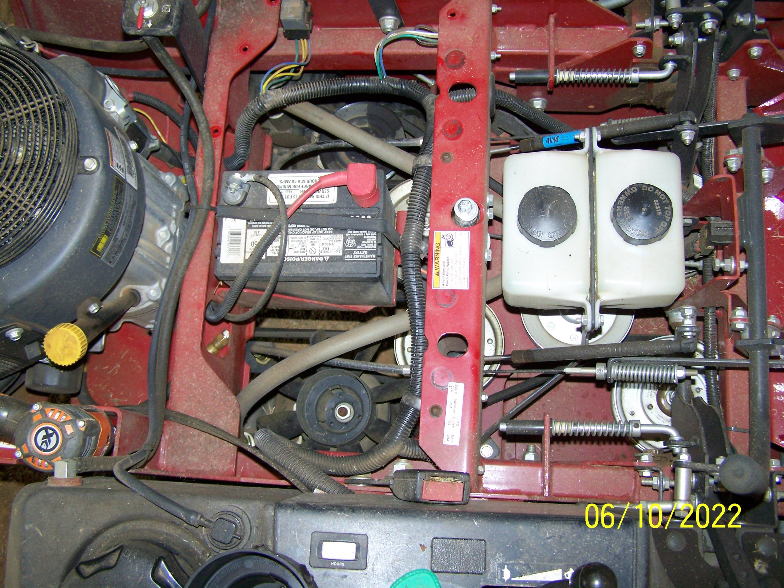

I was doing my weekly mow yesterday when I went to reverse direction the drive to the left wheel quit. It felt like something was binding. When I moved the left side control lever the engine would load up but the wheel wouldn't turn. After checking for an obstruction underneath the machine I tried to power the wheel again. This time it worked and I drove the machine about 30 yards to the barn and parked it.
First thing I checked was the hydro oil level which was OK. Then I noticed all the cooling fan blades were missing! Since I blow out the grass clippings from that area after every use, I'm guessing that a stick must have wiped out the blades within an hour of my discovery.
Is it possible that the drive unit got hot and that's what caused it to act up?
I checked the clock and I'm overdue on the first hydro oil /filter change. I have 160hrs and the service was due at 100 hrs.
I ordered new filters and 15w50 Mobil 1 along with a new fan.
Any ideas?

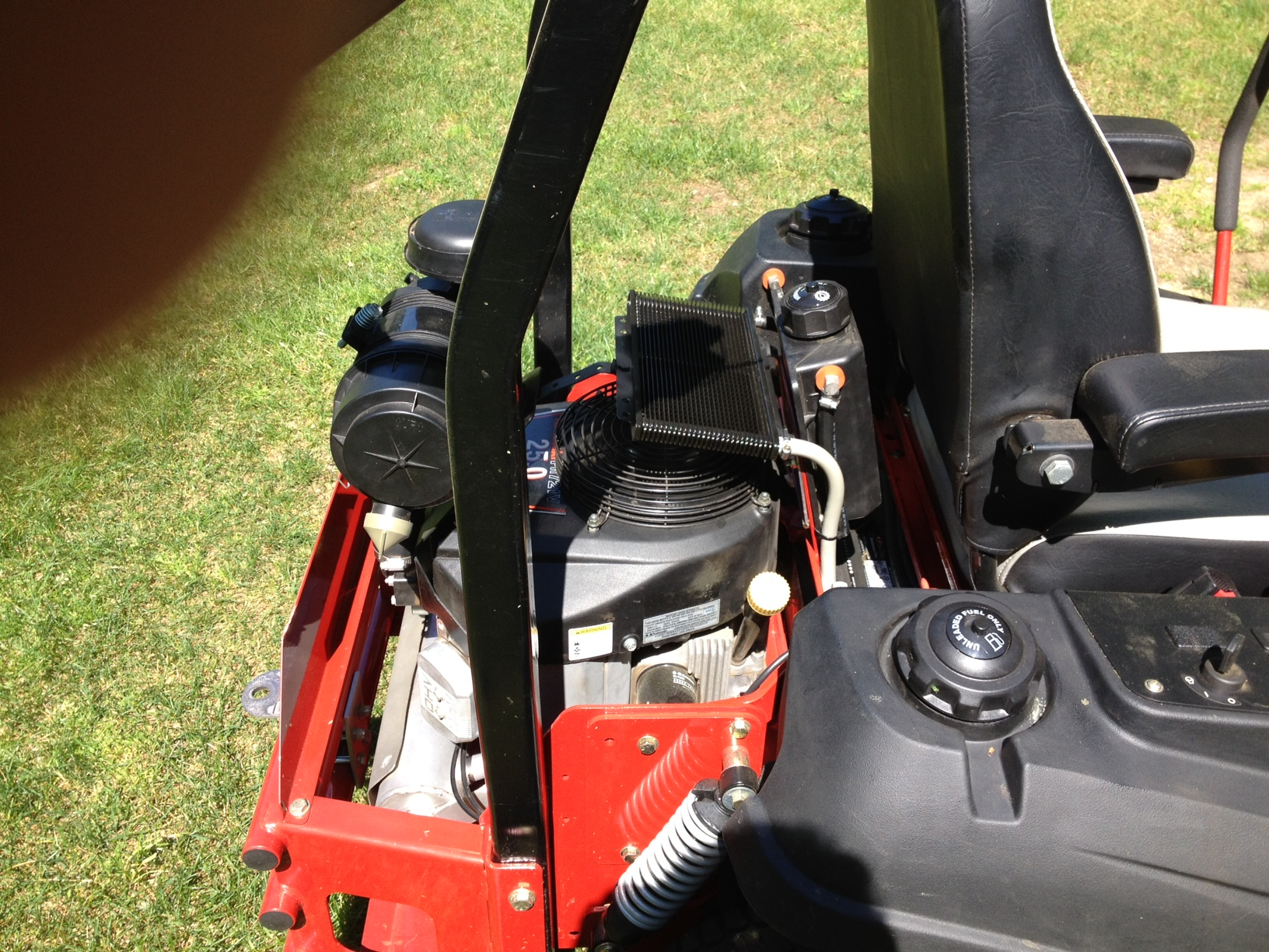

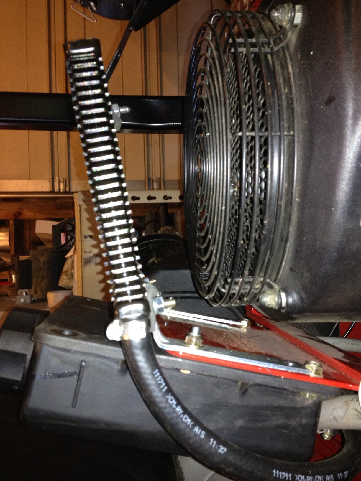

My IS2000 has a central oil tank and filter with separate Hydrogear pumps (with fans) and Parker wheel motors. Does yours have the central oil reservoir and share oil between them - is so one fan should cool enough for both. If each is separate yes, it could have gotten hot. I would pull the filter and change the oil and see what you find - hopefully no metal bits!
Since I tow a Trac Vac with mine and the bigger machines Ferris makes they put a hydro cooler on them I retrofitted a transmission cooler above the engine, as my oil was smelling burnt at 50 hours and was running around 200-210* and after I installed the cooler it stayed around 170-180 even at 80* outside and towing the trac vac.

E5F277A1-18FC-4904-B28E-64008F523C3D.jpeg5D8FE2FB-3501-4696-9D1A-1C81503AD2C2.jpeg0A2F0545-2C9F-49CF-A6F7-13B690EDCACB.jpeg
Each pump/motor has it's own tank. Both are at the full mark(cold). I've included photos of the cooling fan with and without blades.o_O
My old (18 y.o.) 1000z Ferris is a different design with separate drive components. No grass clippings accumulate in the drive area.
The newer model has to be cleared of debris after every use. Why, I don't know.
