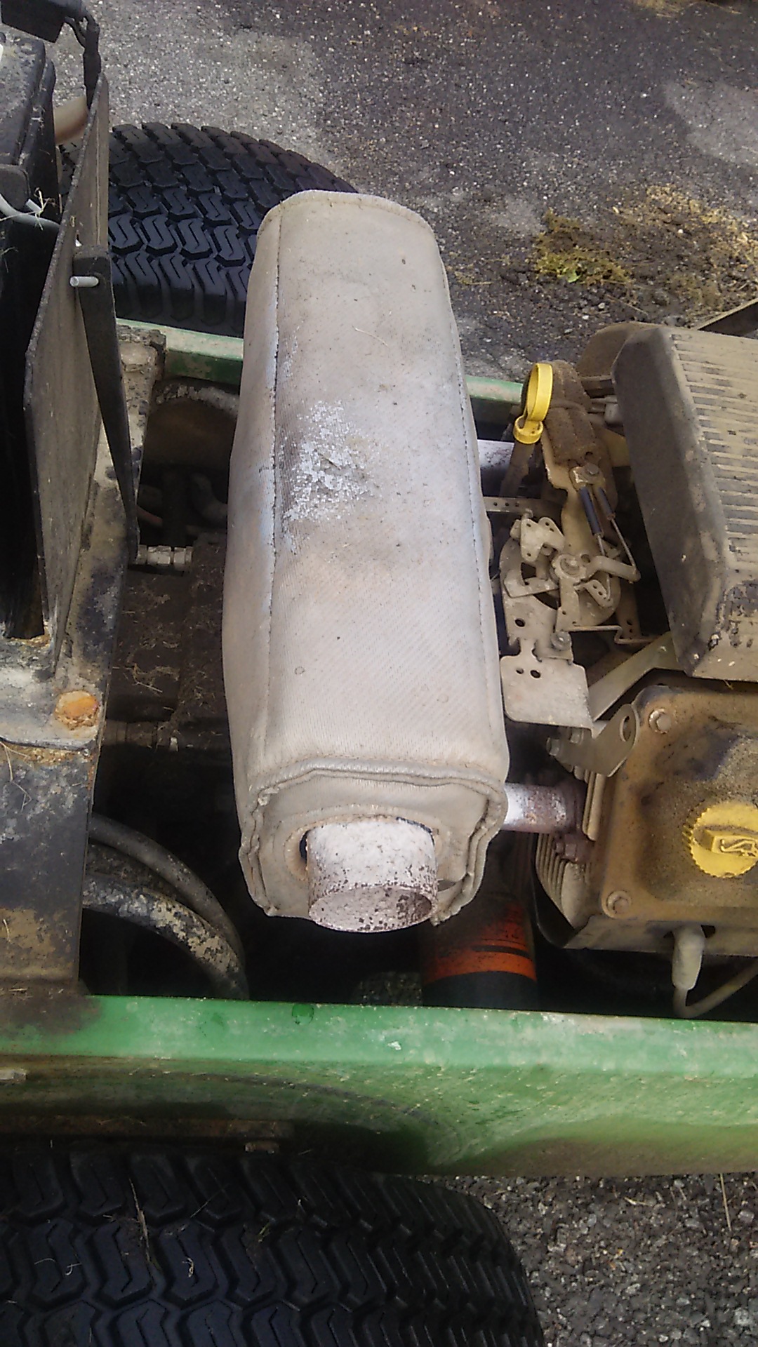

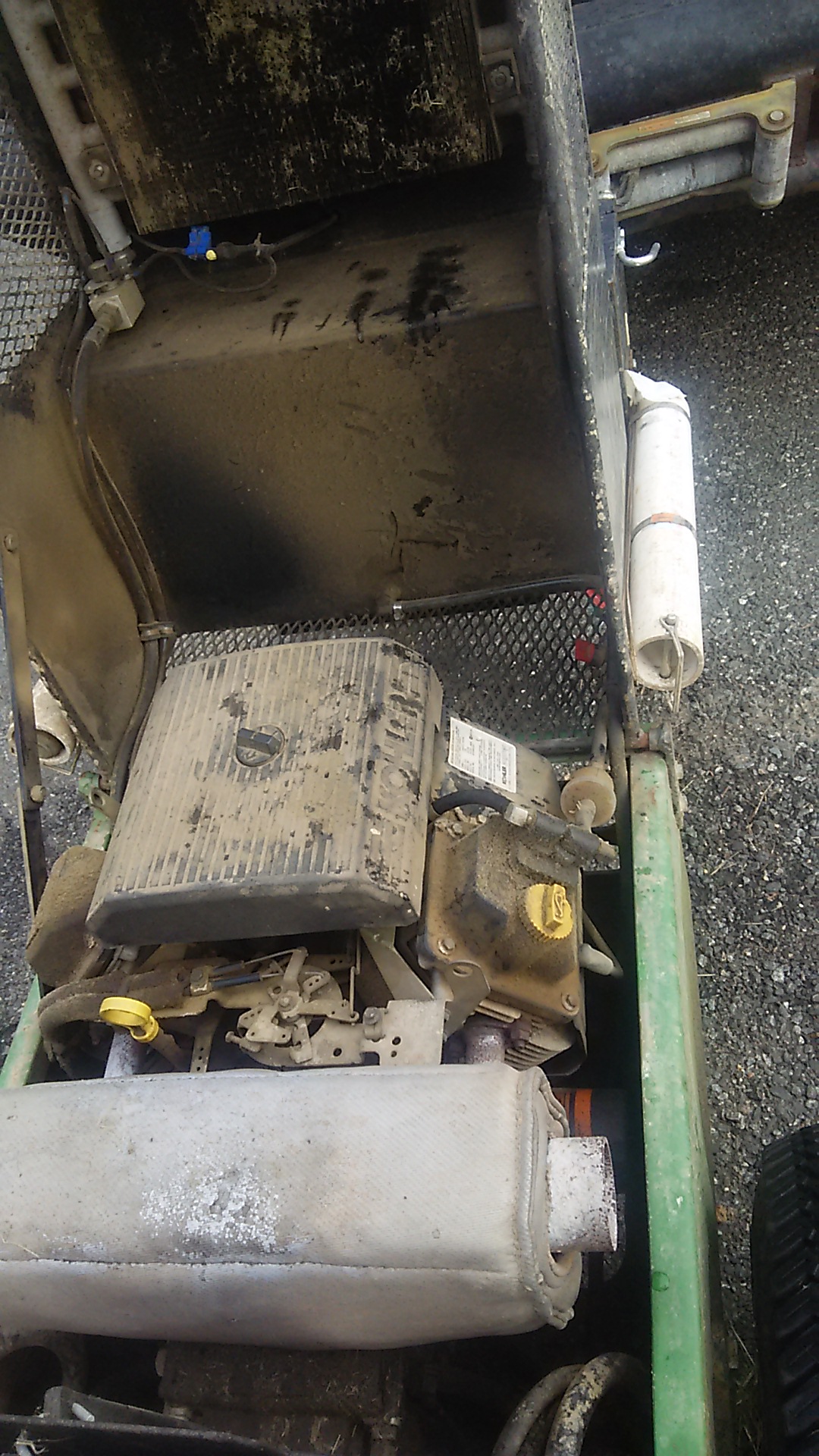

I have an older PT-425 with the Kohler engine. Here you can see the PT exhaust, wrapped in a cloth heat shield I presume from PT. My tank is steel, and incorporated into the lid, with a steel gas cap. The fuel lines don't run near the exhaust, but I'm sure they get hot none-the-less. I also mounted a tool box to the top of my tank, which might be contributing to the boiling fuel. Is there a different exhaust set up for the Kohler I should be looking into to run cooler? DSC_0500.JPGDSC_0685.JPGDSC_0686.JPGDSC_0687.JPG
I've got heat tube on order and I'm looking into how I might mount the fuel pump. Thanks for all of the input.

You should be able to buy a Kohler exhaust manifold that fits your engine that will let you mount the muffler outside the engine tub. That will help quite a bit.
