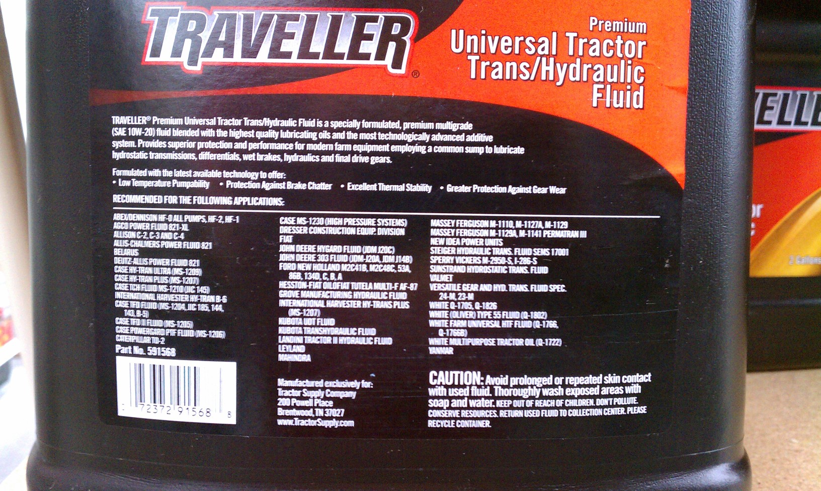

So the real question is, if I go with the cheaper TSC or Wal-Mart stuff, am I going to regret it later? Is the OEM stuff really that much better, or is it just marked up because it's from a dealer? If it is better, is it better "enough" to matter, or is it going to be the (arguably negligible?) difference between 10000 hours and 10500 hours on the engine?
So here is the back label where it indicates what it is recommended for with the equivalent manufacturer part numbers. Sorry about the wonky focus.
Yeah... the specs on the Wal-Mart Super tech look the same. I'm not buying the Bobcat brand for twice the money.

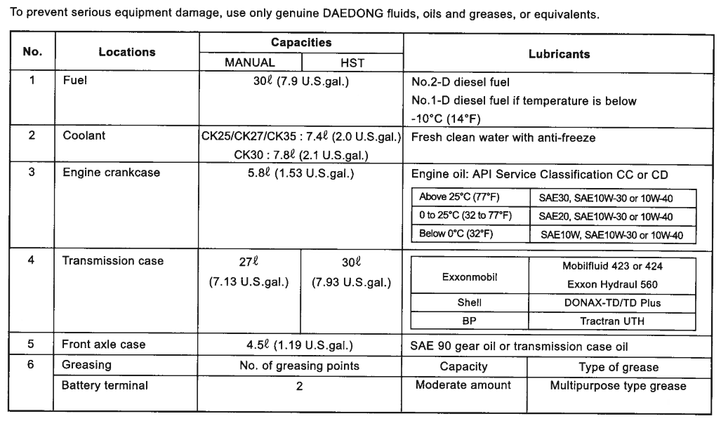

according to daedong, the real manuf of this tractor, here is what they call out, this comes out of the Kioti service manual
