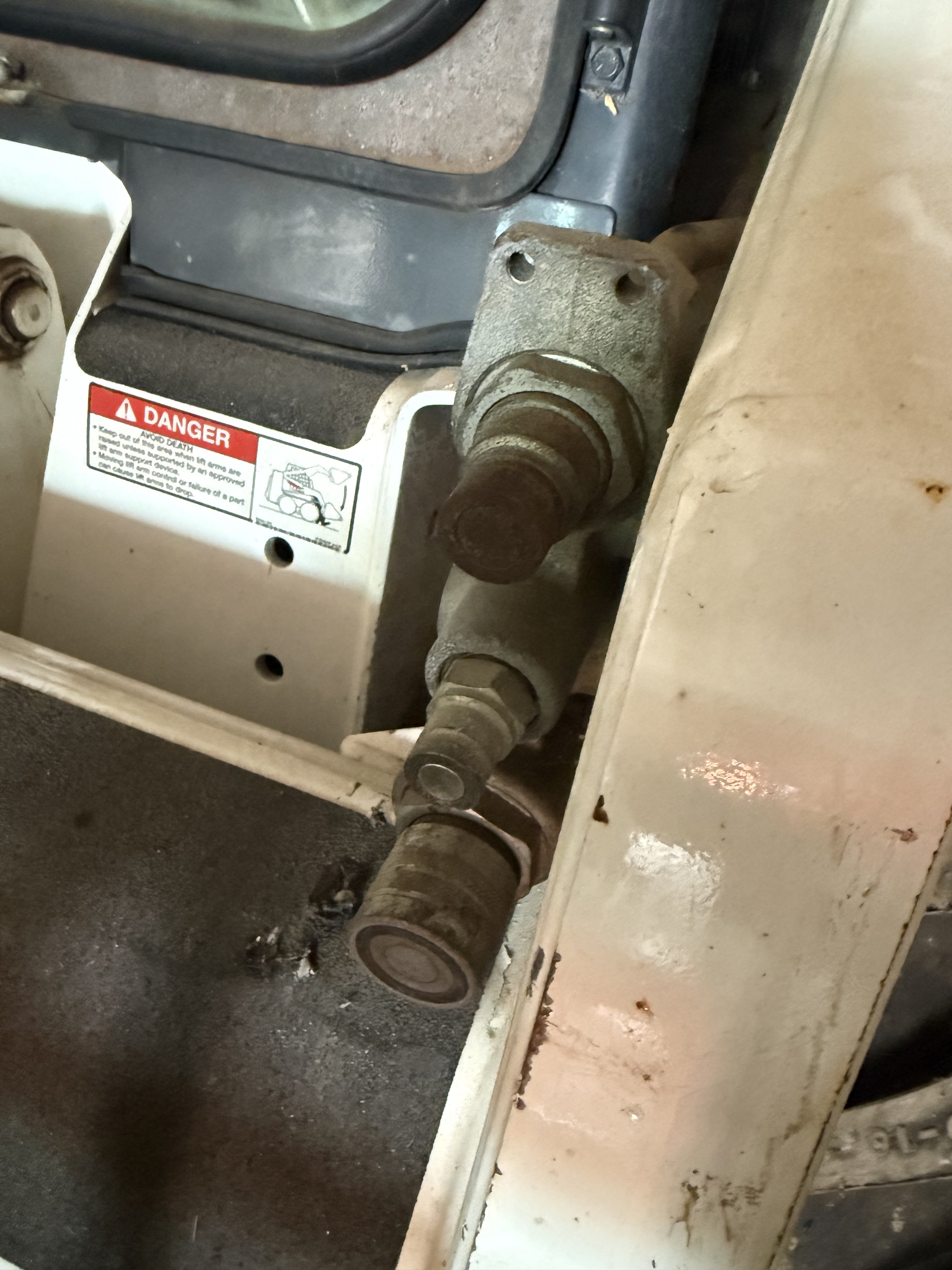

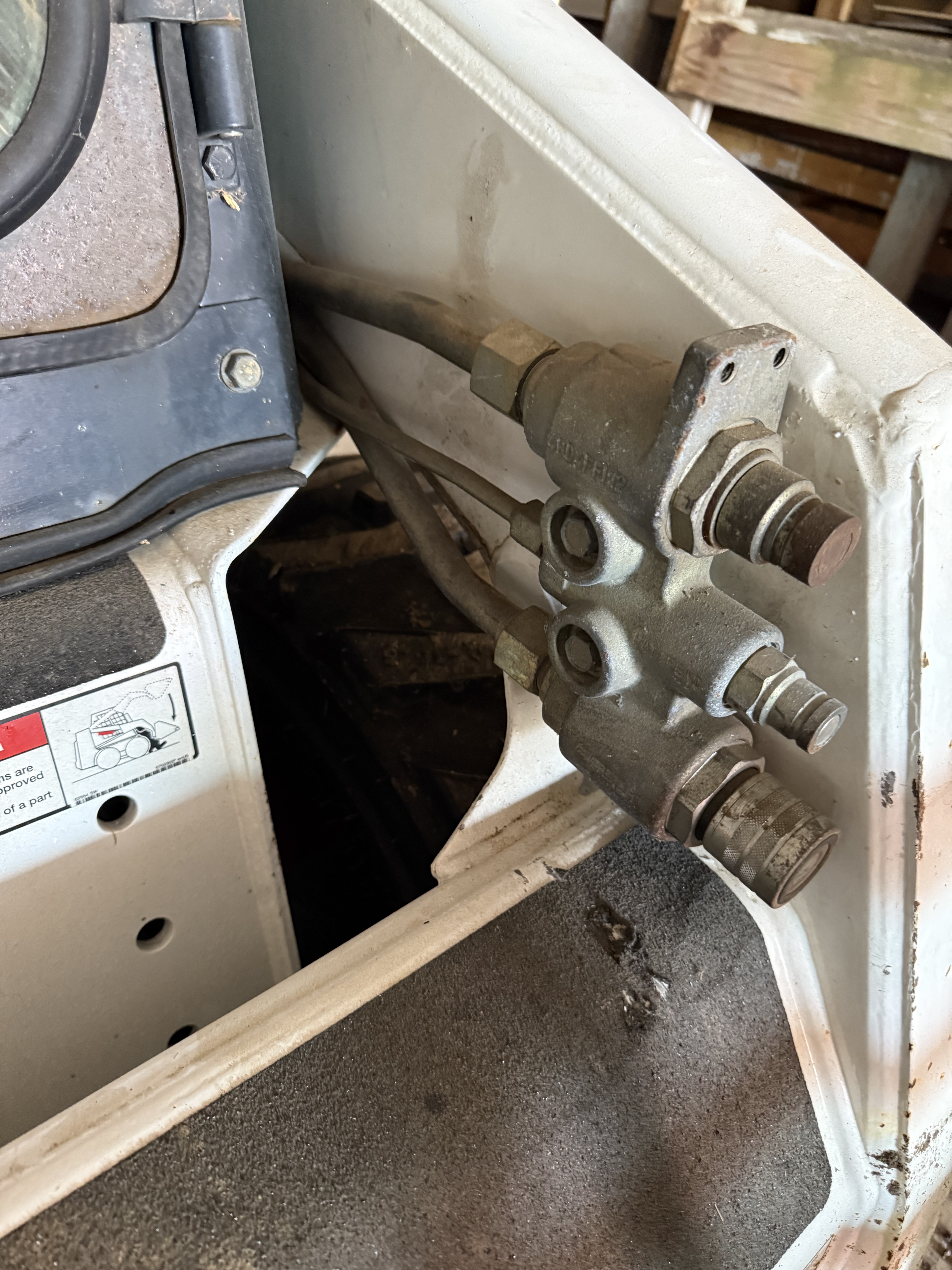

I have an S130 Bobcat. I want to get a snowblower for it but not sure I have the right connections. I know you need to determine if it’s low flow or high flow. And the snowblowers I’ve looked at have and electrical connection and my Bobcat does not. See attached photo. Do I have 3 hydraulic ports making it a high flow? Do they make snowblowers that run without an electrical connection? I want to be able to rotate the chute and deflector from the cab, not manually.

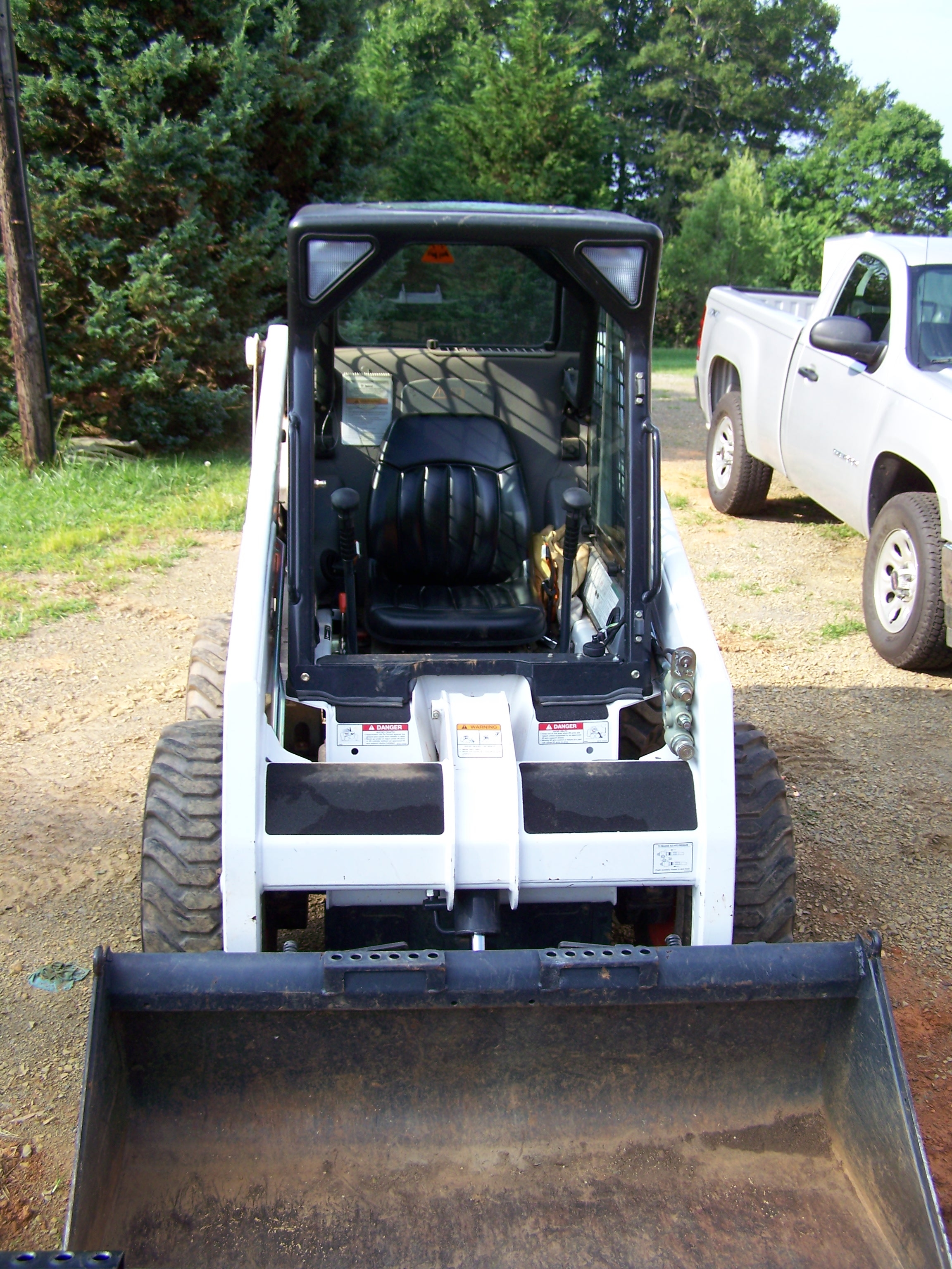

Here is a photo of my S130 that I purchased in 2005.
The original
order states Aux hydraulics: Variable Flow/ Maximum Flow
At the suggestion of the dealer I added an attachment control device m0001-A01-c01 for $138
I never used the Aux Hydraulics in the time I owned the machine.
I believe the third hydraulic connection is a case drain.
As far as I know it was not a High Flow machine
I sold this loader in 2010 and disposed of the WSM I had.
Sorry I can't offer more info.

These skid steers either have a flow flow or high flow system.
The "Bobcat" meowbox you have uses a case drain connection due to the high pressure axial pump
that is used for the hydraulic system to power the twin chain drive for the wheel motors and the 2
loader functions being the boom hoist circuit and the bucket dipper circuit.
You would have to add a power beyond valve on one circuit to have this ability.
It may be much simpler and less costly to invest in snow blower with a chute rotator using an electric
servo motor.
I will list the units with electric servo motors later today when I find my list again.
