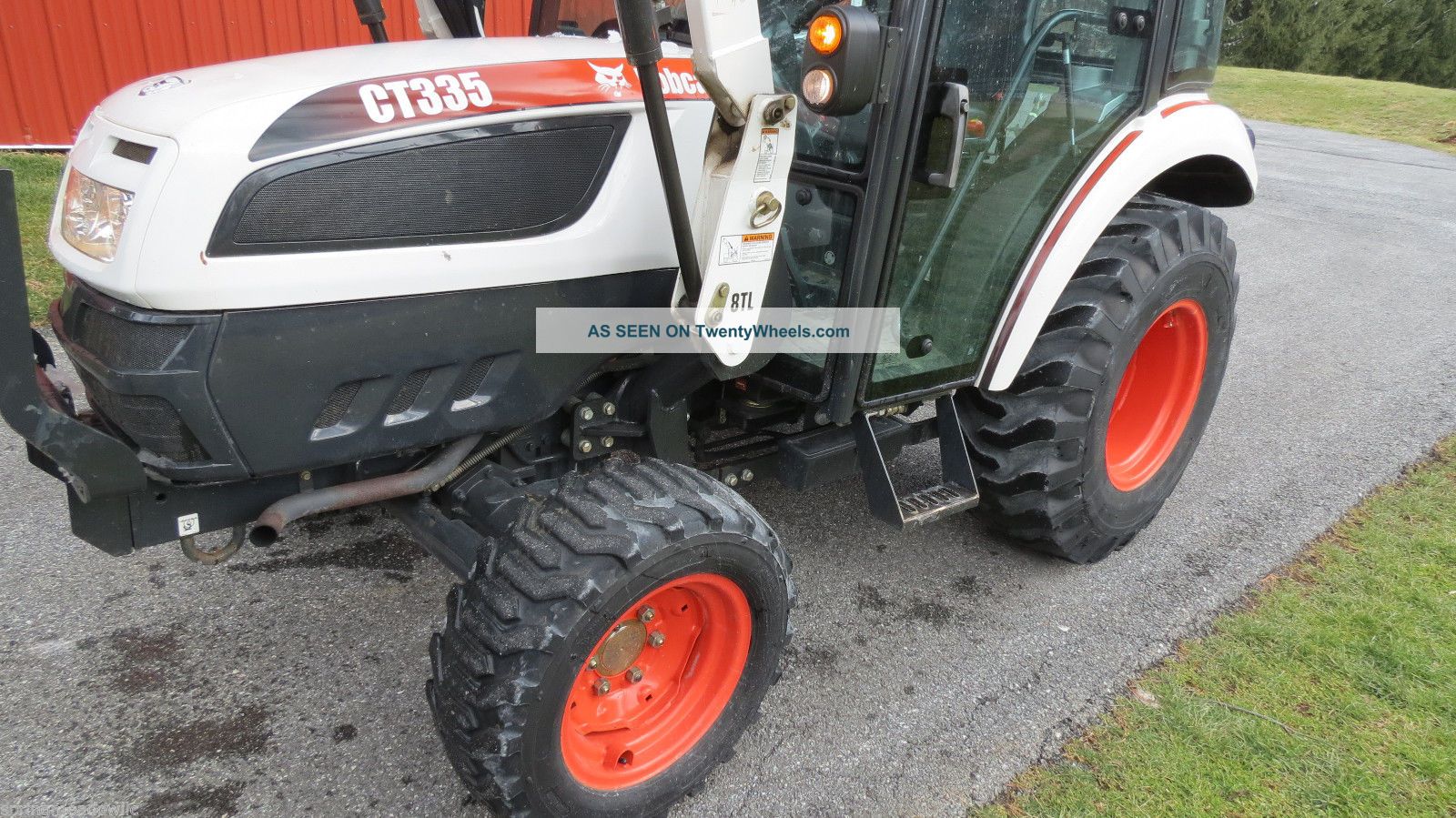

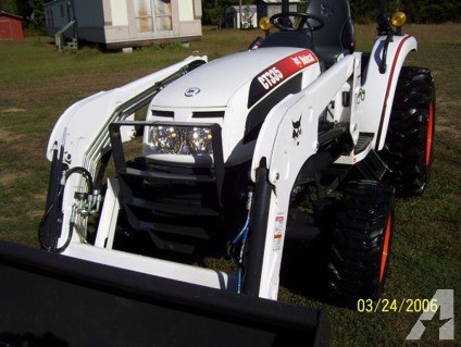

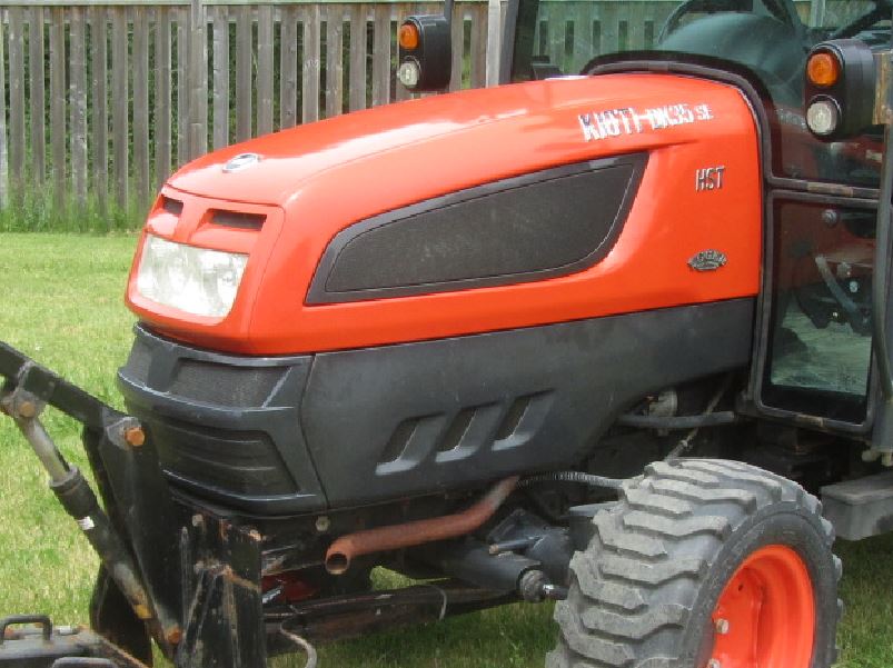

Heres a quick comparison of the CT335 and DK35se, they are pretty close
CT335.JPG Bobcat CT335
Kioti Dk45se.JPG Kioti DK35se
Bobcat ct335.jpg Bobcat CT335
Kioti dk35se.JPG Kioti DK35se

Here is a clearer pic of the Bobcat, grill and screen sure look the same to me.
If the Kioti screen is not exactly the same it should be close enough to make it fit.
