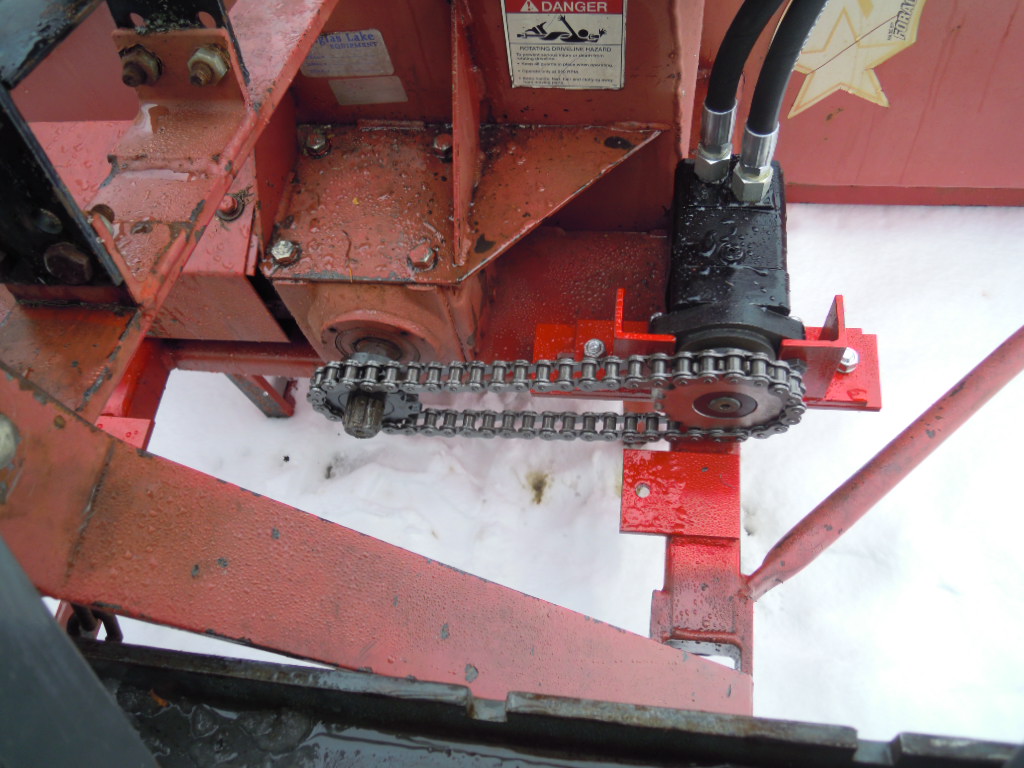

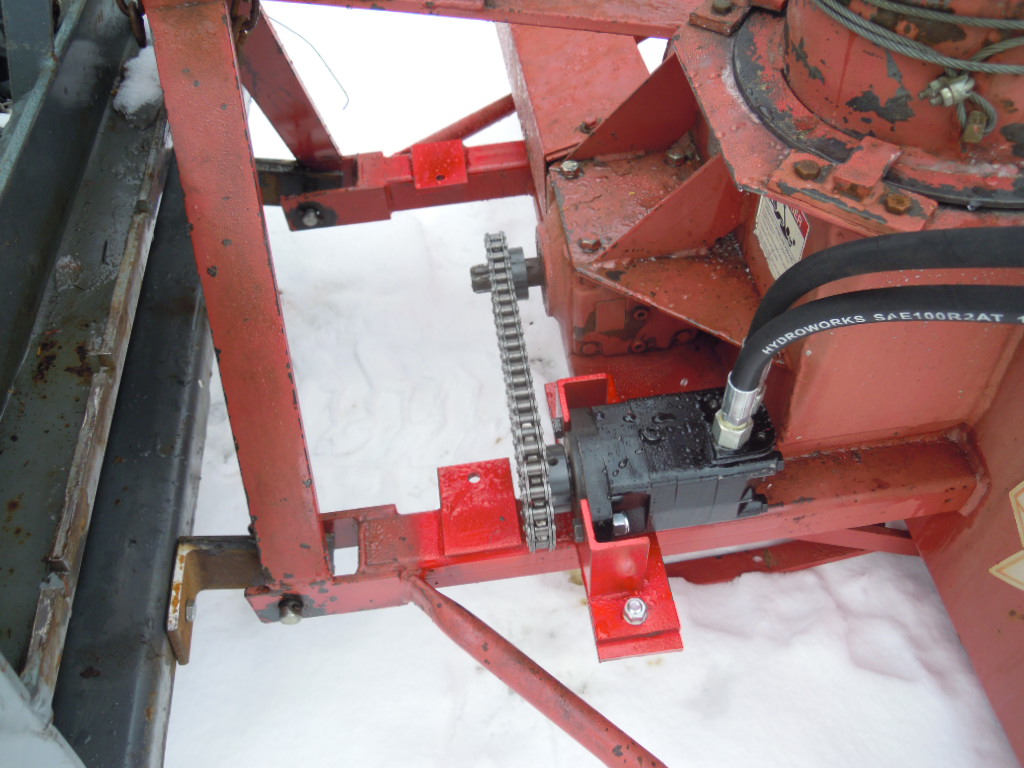

is the leak coming from the jamb nut and block, there is a odd washer with a O ring, your picture shows the area clean, I have no idea how the ring would leak with the nut that tight

I cleaned off the area where the leak was so I could see where it started to come out when running. It appears to be coming from either between the jamb nut and the bend or from the between the jam nut and the pump housing on the bottom. I didn't see it until I used a mirror to look at it. There is a very definite leak here. When I run the SS and use the hydraulics, the leak first starts as a slow drip and then escalates into a fast drip followed by intermittent slow streams (like a run of drips that are attached) then back to a few drips and back to the stream. It is hard to believe there could be a leak there when these things are so tight but there is.

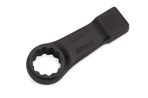

not sure a heat gun will do much, any way you look at it they nut and fitting needs to come off, its a possibility the nut was tightened so much it fractured the elbow, the issue with the way you used the impact its not fully acting on the nut as it needs to, can you get a hammer wrench in? they are heavy short wrenches designed to be hit with a hammer, with the pipe off the elbow you mag be able to use a ring wrench, the dealer has all the tools, we made lots over the years fixing the machines

you enjoy the weekend sounds like a fun time, if you visit the local dealer they will or should have one of those fittings, look and see how its put together, worst case buy it and if the other one comes off take it back
the impact does little if offset, at this point I would be using a chisel to turn the nut and if not turning cut thro it to turn the fitting
