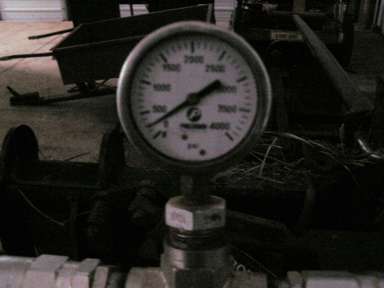

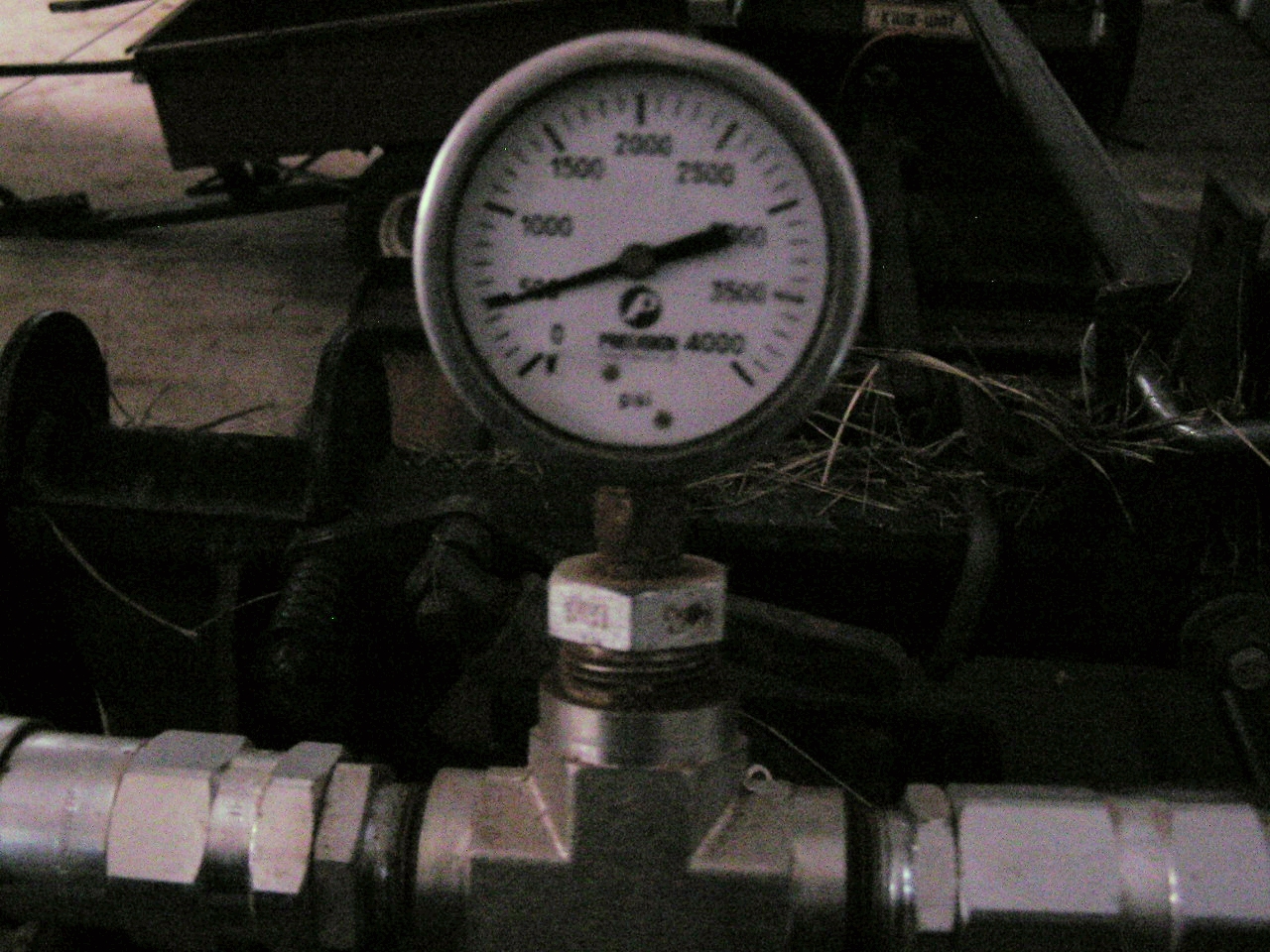

In order to eliminate the cross over as a potential problem I had previously removed it from the circuit and ran a line directly between the 2 remotes, with a pressure gauge in the line. The result was that at idle I got about 50 psi line pressure and at full throttle there was 600 psi. So there are 3 possibilities; 1) this is normal but I don't think so, despite the Bobcat dealer telling me it is, 2) this is due to line and fitting loses or 3) there is a restriction in the hydraulic system. As several people on this forum have pointed out, their machines run with significantly less back pressure. So I am inclined to agree with those that suggest a restriction somewhere. I just need to find it somehow.
Your machine will develop full pressure at idle. Full flow happens at max RPM. Resistance to flow causes pressure to increase.
The 600 psi reading may be from the tee fitting the gauge is on. Can you post a picture and give the size of the tee?

Sorry, I didn't get a pic of the test setup and it has been dismantled. But it consists of a 6' length of 1/2" ID hydraulic hose connected to the 1/2" Pioneer QC at the remote and the other end connected to a 1/2" x 1/2" x 1/2" tee. The other end of the T has the same setup back to the other 1/2" Pioneer QC.

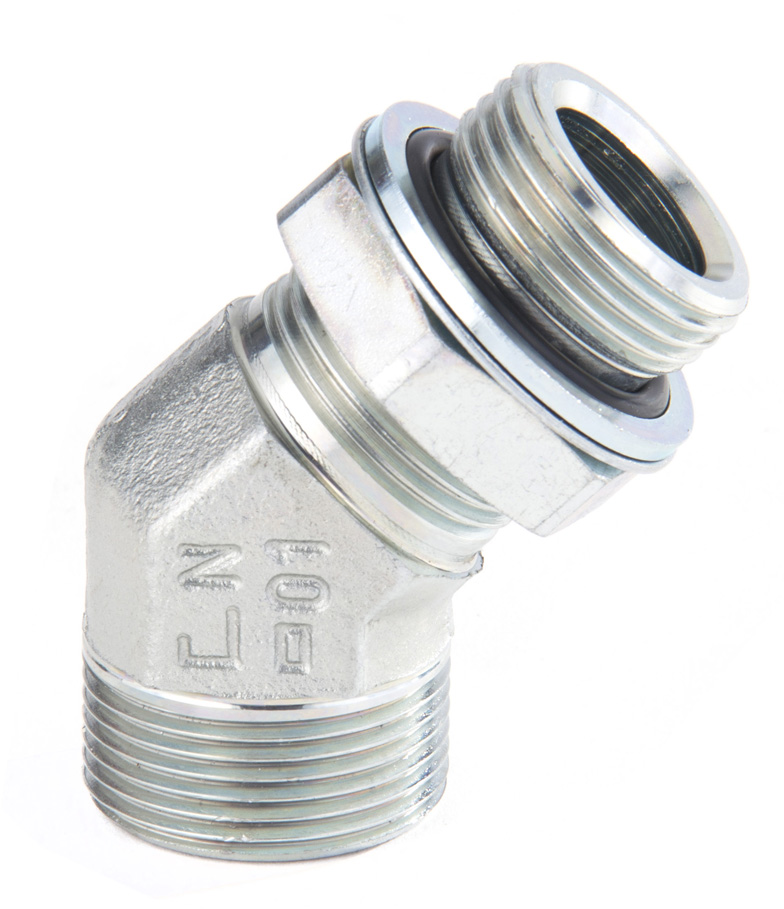

I'm pretty sure I found the leak. It may not be the only one but it is definitely a significant one. It is between the pump side of the 45* male x male elbow and the female part of the female x male adapter that screws into the pump housing.
Does anyone know what type fittings these are. I can't get it apart to see for myself. I'll need to run into the city to get some special tools for this and would like to get the right replacement parts while i'm there. Maybe I'll just stop by the Bobcat dealer and get the parts there. They can probably tell me what tool they use to get access to these fittings too.

It is a 45 degree, O-ring face seal fitting: http://blog.worldwidemetric.com/products/an-overview-on-o-ring-face-seal-orfs-fittings/
The O-ring is bad or overtightened.
Do a search for how to measure the size, or check the Bobcat online parts manual.

Thanks Xfaxman. I didn't know there was an online parts manual. That really helped. Now I can see how it goes together plus I can follow the hydraulic circuitry. The seal must have blown when the pump deadheaded. If I'm lucky that will be the only thing that blew.

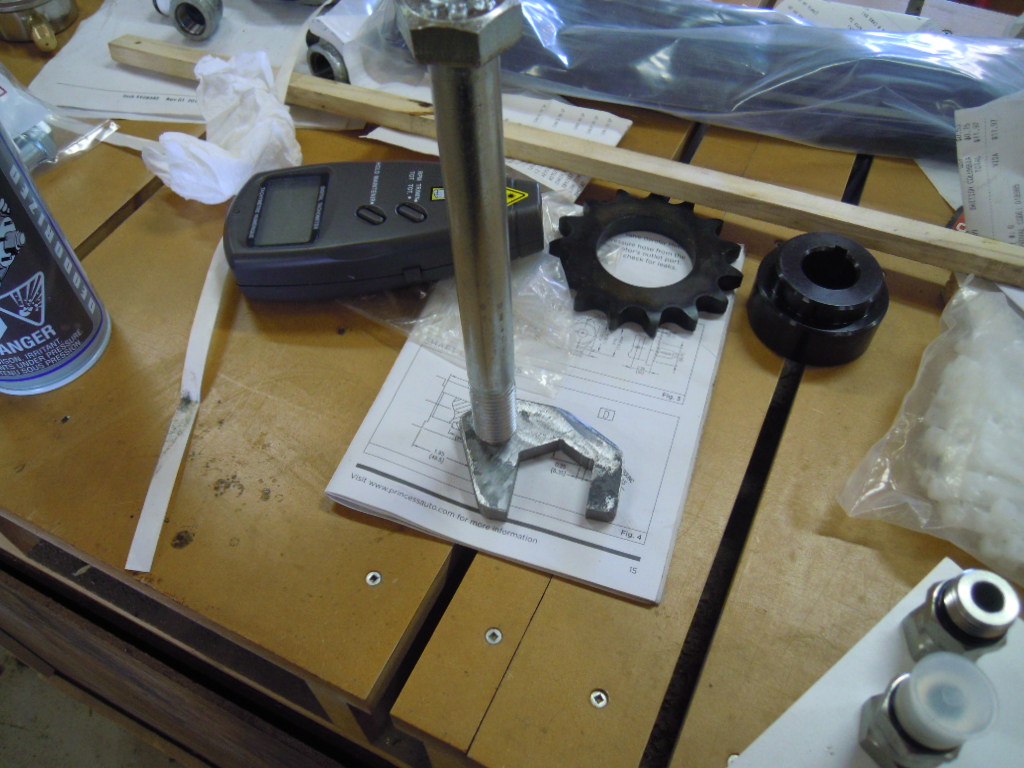

I can't get the above fitting loose. I can get a 1 1/16" open end wrench on the bend but the wrench ends up against some piping and doesn't leave room to turn it. I can't get a wrench or socket on the nut that is screwed into the pump and I can't find a 1 1/4" crow foot wrench anywhere in the local town or the closest city. So I made this, hoping it would do the job.
I got the wrench over the nut and the fit was good but even with a 1/2" breaker bar and a box wrench over the end of the breaker bar I couldn't get the nut to break free. I have some WD40 soaking on it now and will give it another go. I'm thinking of using an air impact gun on the end of the wrench I made but I'm not sure if that is a really bad idea because the center of rotation is offset or if it has a chance of working.
Thoughts or experienced advise are welcomed. I certainly don't want to damage this. I can imagine this could really expensive in a hurry.

Hillbilly
I mean this as no insult to your intelligence but are you sure you are turning the nut the correct direction. I know that while standing on your head trying to work things can get mixed up or at least I hope that don稚 happen to just me.

A very good question and no offensive taken. Unless this is a left hand thread, I'm sure I'm trying to turn it the right way, ie. counterclockwise. I managed to get the swivel fitting to turn but for the life of me can't get the bend or the nut (they may be one piece based on the pic that Xfaxman posted) that screws into the pump to budge.
What do you think about trying an impact?
