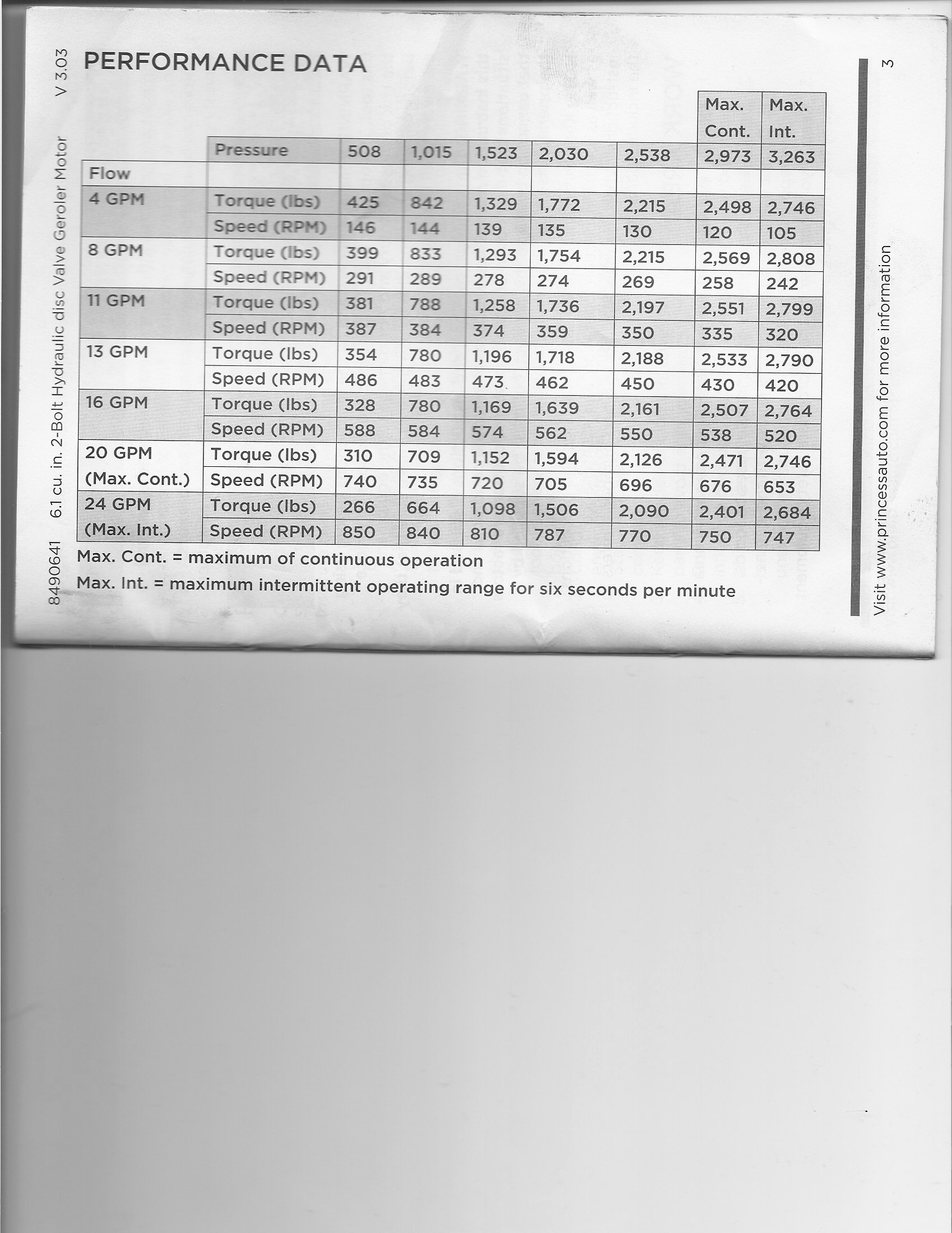

I got it working and have a cross over relief valve between the SS and the blower motor. The relief is set at 2900 psi. The motor is rated for max continuous pressure of 2973. At full throttle the blower works but does not throw the snow very far and bogs down quite easily. I think the problem a lack of flow, like you say. I thought about putting sprockets on the motor and the blower gear box to increase the blower fan speed but that would reduce the torque and then I'm back to the blower bogging down. I talked to the hyd motor dealer and asked about using a larger displacement motor but they are rated to run at even slower speeds. I guess I'm stuck with this setup, unless you have any ideas to improve on it.
/ Bobcat 763 Help #4
What make & model of motor did you use? Did it have a flow Vs RPM chart?
Also be nice if the chart included torque vs differential pressure
What size hose did you have on the loop when you where initially trying to check pressure. The 600 PSI is all back pressure and reduces the amount of power to run the motor.

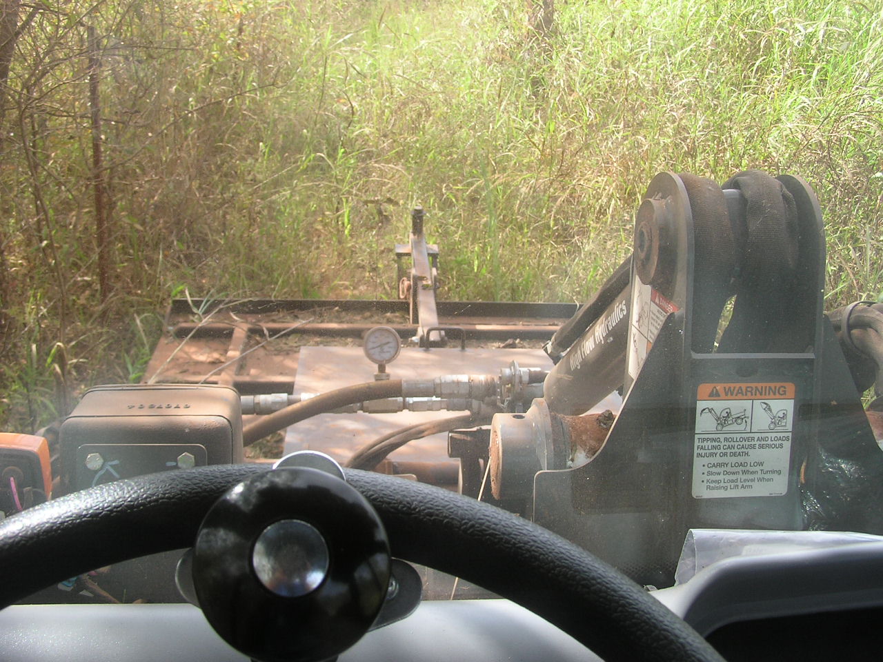

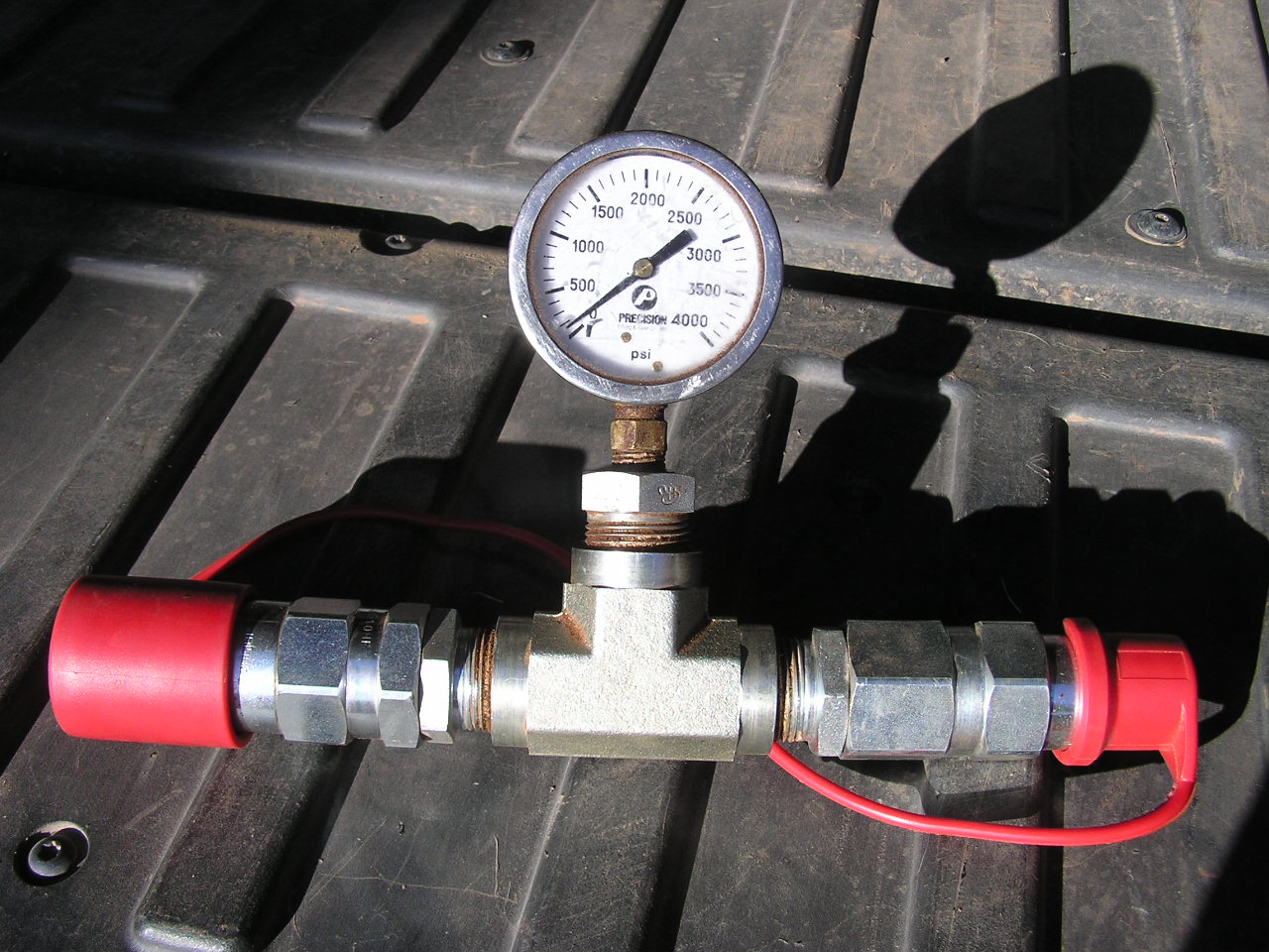

This is how I setup my pressure gauge:
I can put it in line to see if I am going too fast in thick grass or heavy brush:
The low-flow brush hog uses 3/4" hose.

The pump is a house brand from Princess Auto and here is a copy of the table in the owners manual.
I used 1/2" hose. Which I think is too small but the steel lines to the Bobcat aux connections are only 1/2".
View attachment 541819 View attachment 541821
View attachment motor.pdf
I like that setup and thanks for the tip on the 3/4" lines. I think that might be part of the problem but I think there is a bigger one producing that 600 psi back pressure.

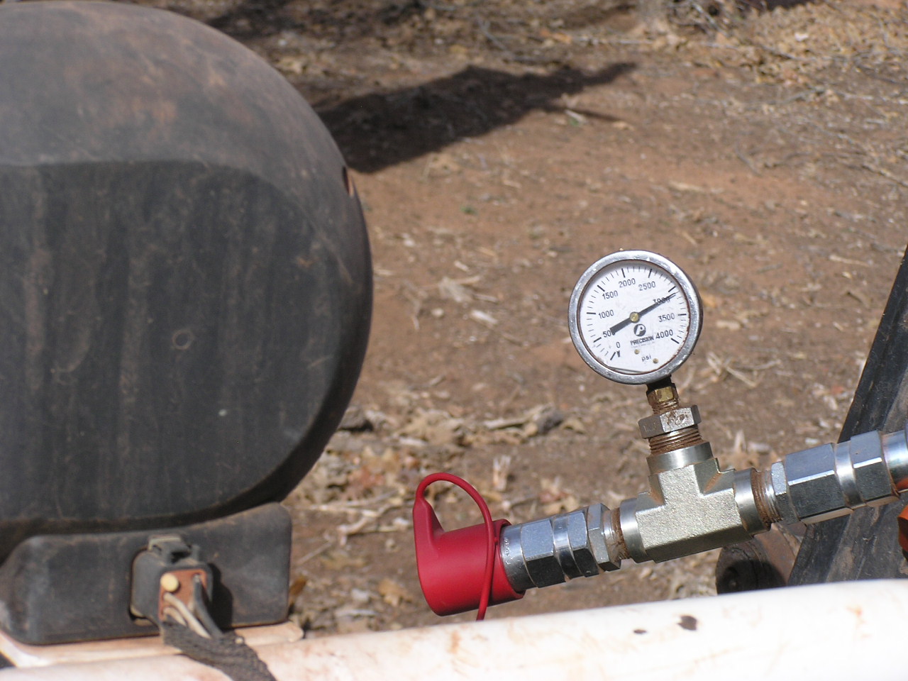

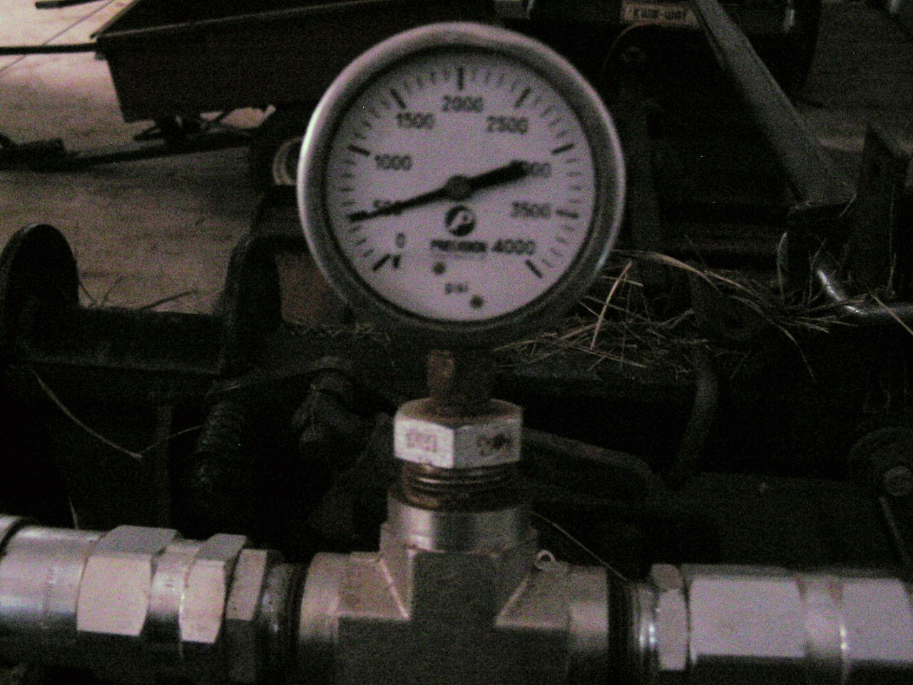

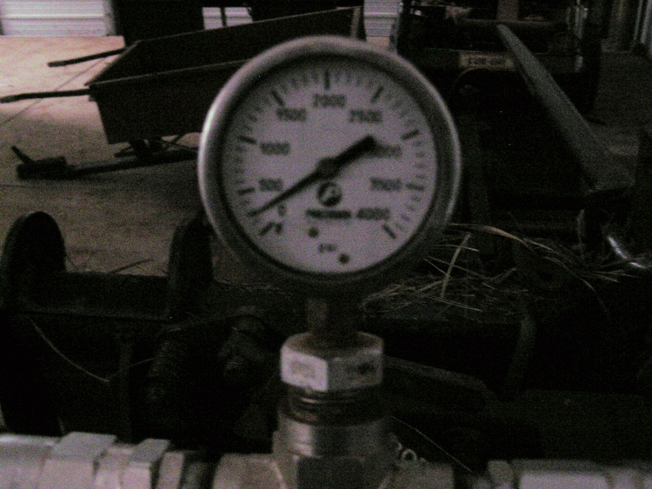

I went out and took pictures with the brush hog parked on concrete, no resistance to the blades, showed 500 pounds to spin the blades at max RPM and 175 pounds on the return hose.
Cutting heavy grass, moving fast the pressure will go up to 1,000 or 1500. Too fast in brush will show 2500 and you can hear the pressure relief in the brush hog open. :eek:
View attachment 541969 View attachment 541970
Thanks for doing that. It would appear I have a problem if I get 600 psi with nothing hooked up. I called the Bobcat dealer 2 days ago and asked if this was normal and if not where I should start looking. He said he would call back shortly. I don't expect to hear from him now, unless his idea of shortly is a week or so,lol.
