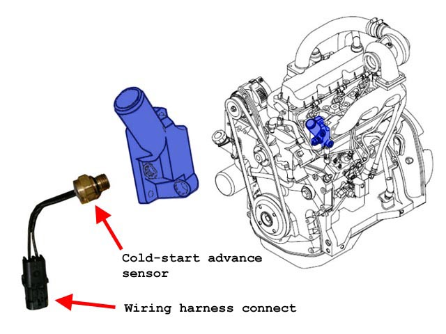

I have a 5205 JD . driving with a load of wood and the tractor just stopped as if it were out of fuel. tried to restart it and it did nothing. found a blown key switch fuse , I replaced it and when I tried to start it the fuse blew again . It did not turn over at all. What is causing this to happen?

You said key switch fuse, could it be fuel-solenoid, if so/would not hurt to try.
I believe the problem is the temperature sensor. On the thermostat housing there is a temperature sensor that is connected to a two wire harness that goes to the injection pump, this is the "cold start advance" portion of the system so it starts easier when cold, the sensor is so it doesn't activate once warmed up. If you disconnect the sensor and it works fine ohm the sensor, probably shorted.
The sensor on the thermostat housing, that controls the advance on the inj. pump. When it fails it shorts out and blows the fuse. Try unplugging it, replace fuse and see if it starts and runs. The part # is RE503242 (see picture), if you are quick changing it, you don't have to drain the coolant, just make sure it's not hot at the time.

The tractor was on level ground, no harness was hanging ,tractor acted normal ,all of the lights are working properly. I just have to turn the key to the on position for the fuse to blow , it just died. help!

I went out to the tractor and pulled the wire off of the stat and it started, no blown fuse . You just saved me a lot of money! I'm sure the dealer would have found something else that would have cost alot more to fix. I will take the savings and buy me more 30 amp fuses, I used all that I had. lol THANK YOU VERY MUCH You guys save us guys alot of time and money . I'm glad we have this site to go to .Thanks again

Here is what the tech manual for the engine states as the reason for the sensor. To comply with the exhaust emissions regulation, the timing of injection pump should be around 6 to 9 degrees before TDC. These timing values do not allow proper start-up operations when engine is cold. To ease engine start-up, a cold advance system gives to the injection pump a temporary over-timing.
When coolant temperature is below 50 C (122 F), the solenoid valve is activated and opens the cold advance circuit.

The best I can do to answer your question is provide you with a page from CTM125 that outlines how it works. The solenoid kit is RE502747.
  • Timing_Advance.pdf
