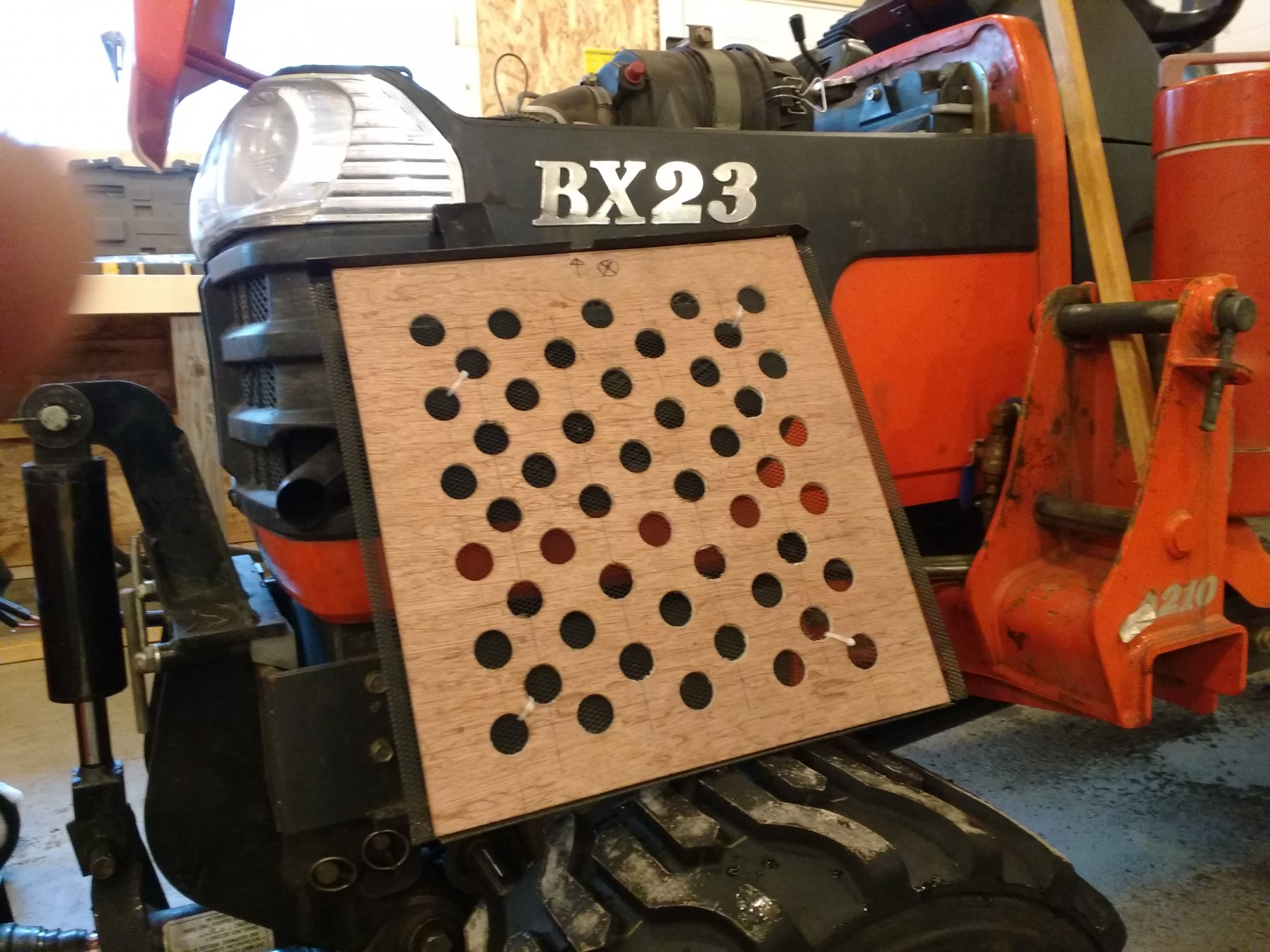

I have a BX23 with a front snowblower, with the same problem that you have. This is what I zip tie to the removable radiator screen and the gauge goes to about the same temperature as in the summer.
