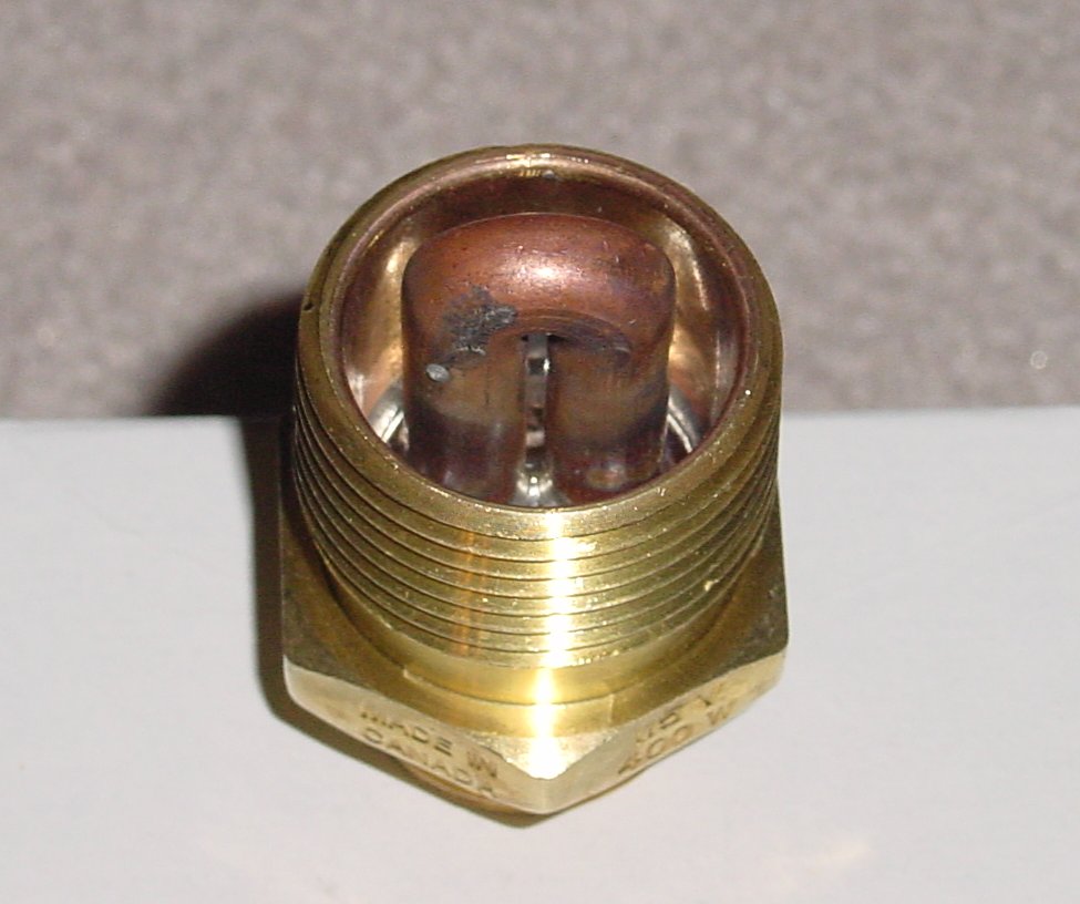

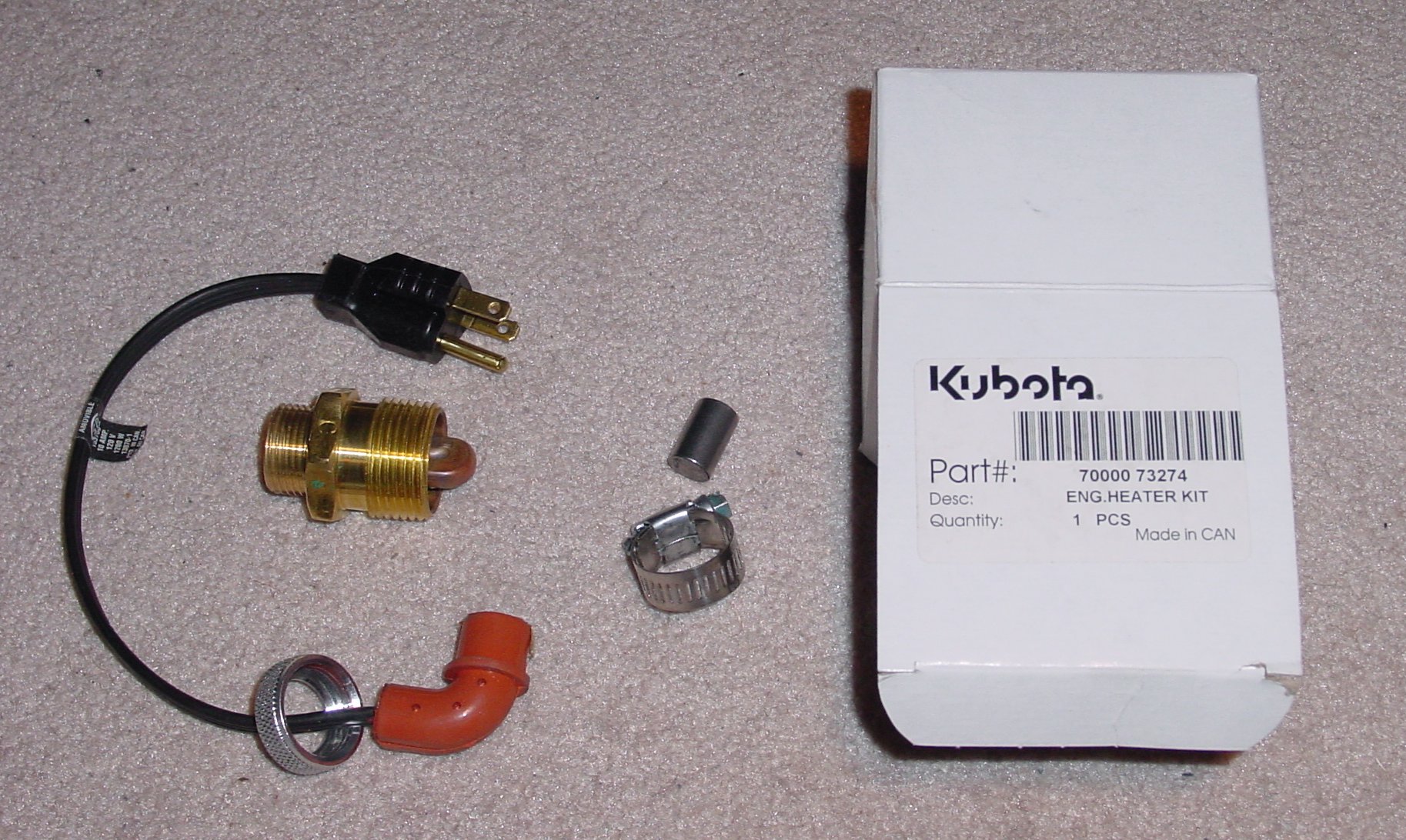

I recently installed a block heater in my B3030 and have used it a few times so far this winter. It's a screw-in type designed to heat just the coolant. On a 10 degree morning, plugging it in for 1 1/2 to 2 hours warmed up not only the coolant but just about everything else under the hood. The engine fired up as soon as I turned the key. I would recommend one. The hardest part of the install was removing the existing plug from the side of the engine - very tight.
I installed the same 2 years ago.. Great cheapo investment... I plug it in for 10 minutes...have a coffee, takes the curse off the cold start then idle for 5 minutes to let the hyd fluid warm up...
Some guys put the block heater on a timer if they know what time they're going to start in the morning...
