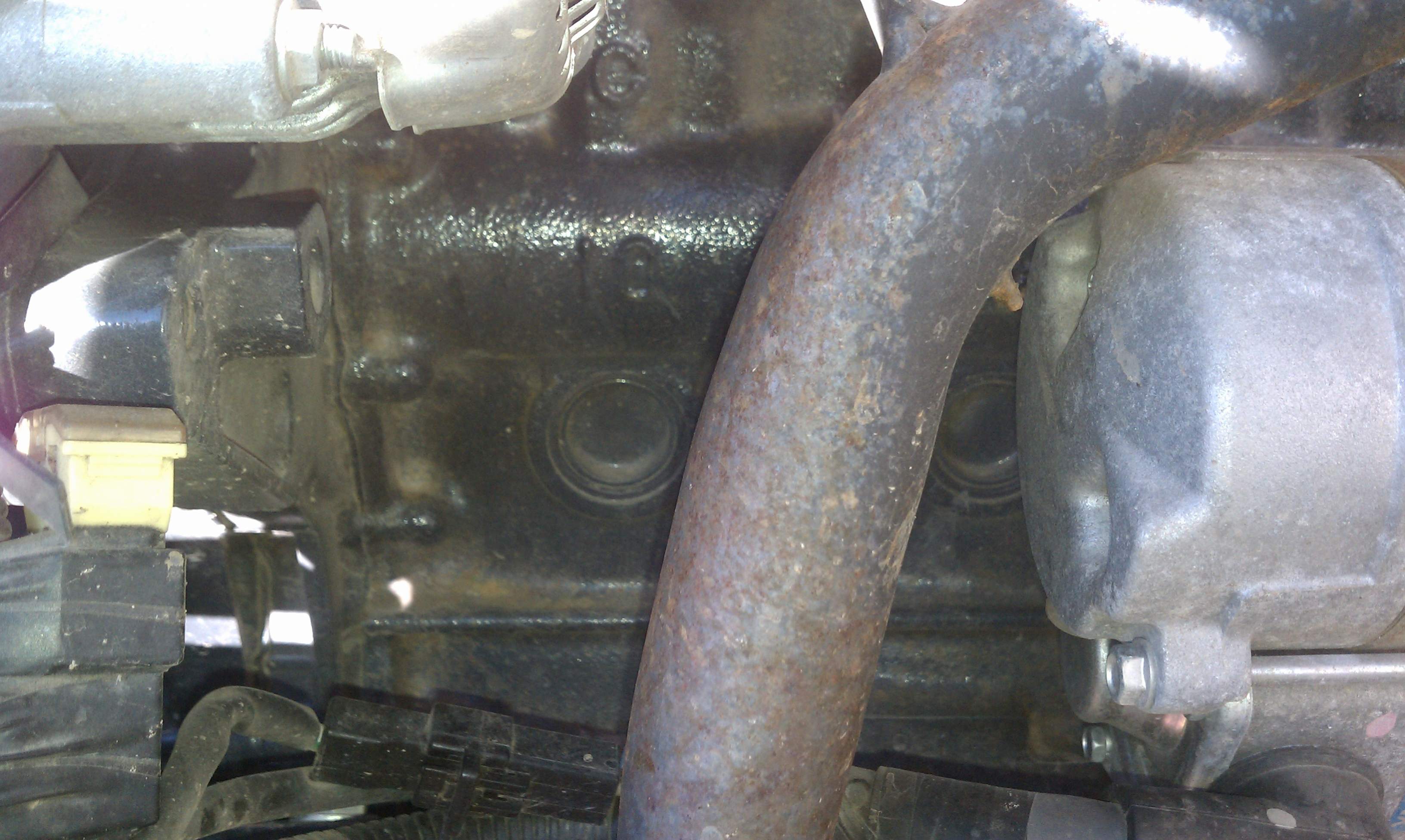

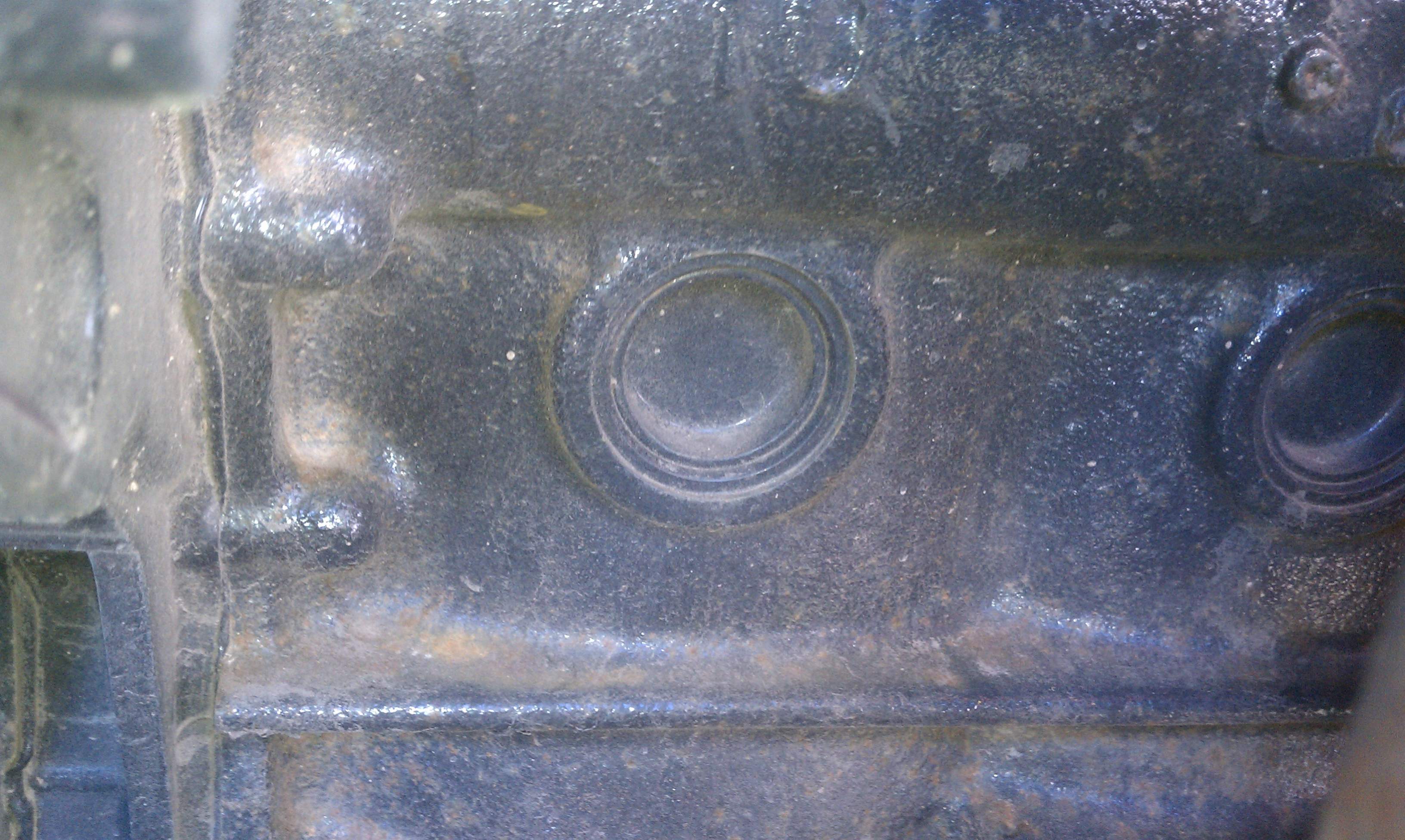

Are these the freeze plugs?

Yes, they are just sheet metal stamped in a cup shape and pressed into the recesses. I usually drive a screwdriver through the center and then pry them out for removal.
