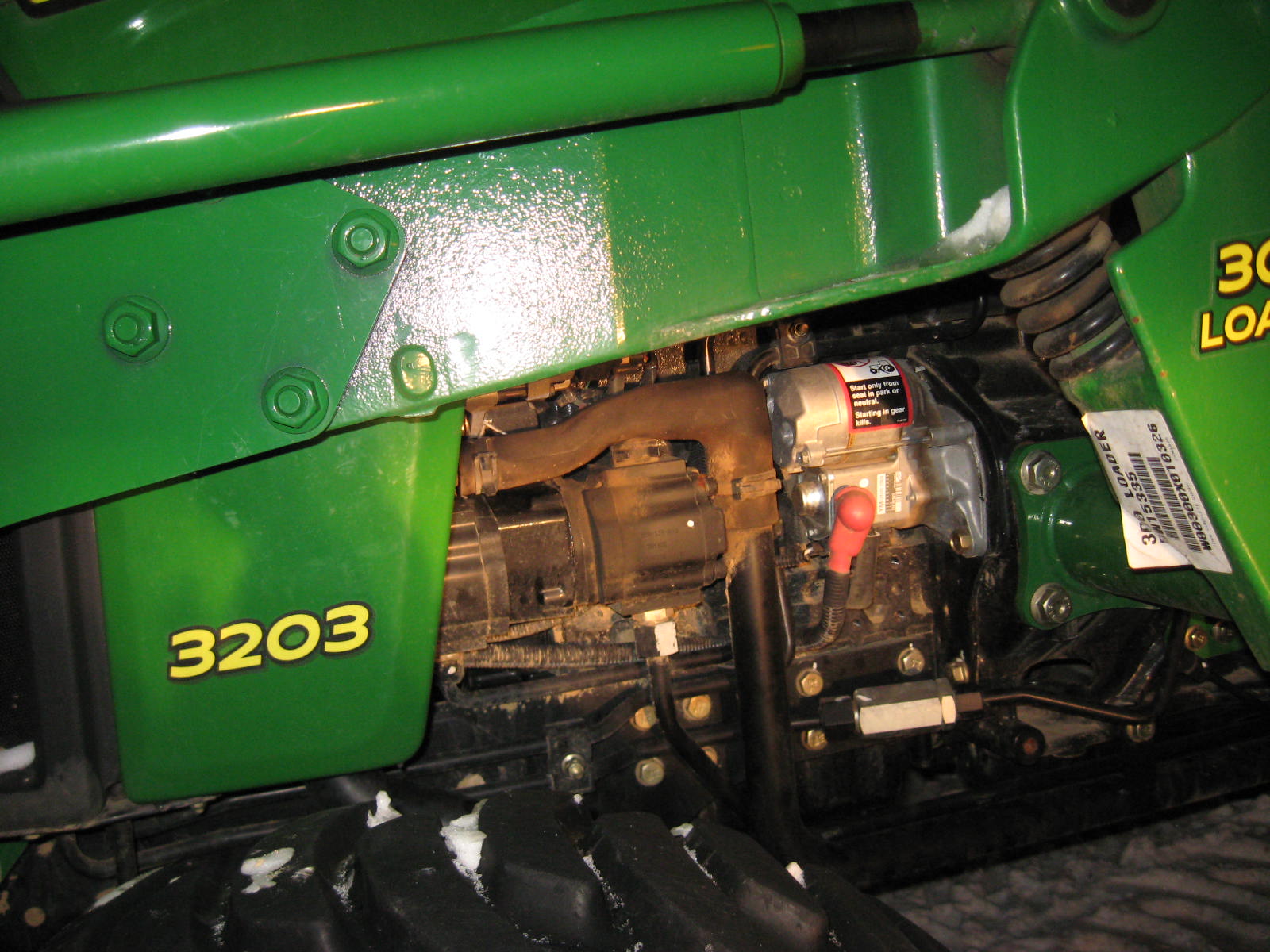

Yes, another block heater question. But with a couple specific questions.
First, what is this hose in the '3203 hose' picture? The one with the two spring hose clamps holding it on? It appears to be easily removable, but I would like to know what is inside before I just have at it. The removable section links two hard pipes, one comes from the front of the engine area and the other runs to the rear axle area. I'm pretty sure it is not a liquid in there, but I would like to be very sure.

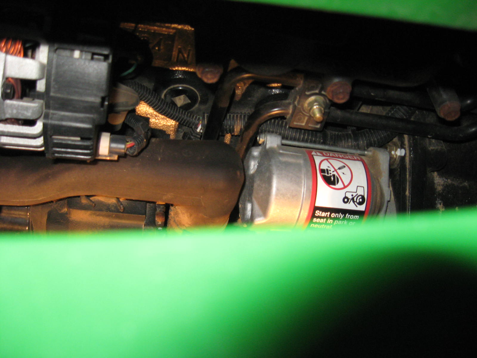

The second question; do I need to drain the coolant from the block and radiator before removing the plug in the block? The plug can be seen in the '3203 plug' picture. How much coolant would I lose if I didn't and how much mess would it make?
I plan on doing this tonight because it is going to be below 0F and that just seems to be the way I do things. Garage door openers for instance, I've installed 6 of them so far and I think it hasn't been warmer than 35F for any of them. This heater install will be performed outside in the driveway, by the way, can't get the ROPS in the garage.
Thanks for your help.
Matt

I don't know for sure, but it sure looks like some sort of radiator hose. In which case when you pull it you will likely dump at least 1/2 of your radiator coolant. That is my best guess without more info.
No idea on the plug. sorry.

2) Clean the hole out really good before you go putting the heater in. A little emery paper may even be in order. If that hole is good and smooth, you'll have no problem getting a good seal.

As for the plug hole, the JD plug and heater are threaded. You may notice in the picture showing the plug it accepts a 1/2" drive. I did get a service guy at my dealer to tell me that they just use Teflon tape on the threads for a seal.
I'll find out for sure tomorrow, but I don't think that hose carries a liquid. It is only secured onto the hard pipe sections with spring clamps, they don't look liquid tight to me, but if I knew exactly what I was doing I wouldn't be asking questions...
Metal constricts when it gets cold doesn't it? So at sub zero temps that plug shouldn't be to difficult to remove, right?

Threaded? Neat concept. In a coolant system it probably won't matter as much, but it's still a good idea to leave the very end thread without any teflon tape on it. The point there is to prevent any of the tape from breaking off inside the system and plugging things up.
It seemed to me when I did my block heater that the position of the frost plug was such that most of the fuild would have to be drained. I'd plan on catching all of it.

Hey Matthew, I looked up your machine in JD parts. After looking at the parts photo/schematic, I see it's listed as being a transmission/service line. I'm guessing it's a return line because of the size of the line and the lack of pressure fittings!! Hope this helps!!

Mathew, IF you happen to run into any trouble getting out the plug. I DID!
I first used a 1/2 inch breaker bar to try and remove the plug. NOT!
Then I tried an 1/2 inch electric impact gun. NOT! Then I went back to the 1/2 inch breaker bar and added a 7 foot cheater pipe. NOT! I was beginning to wonder if I was ever going to get the thing out. Then I tried a 3/4 drive breaker bar with a 1/2 inch reducer plus the cheater bar. NOT! I couldn't beleave that plug still won't come out. Lastly I used the 3/4 drive breaker bar, cheater pipe and heated the block around the plug with a torch. Finally............success! (lots of cussing on this one)
I didn't drain the anit-freeze and if you are quick you don't loose much. I would suggest removing your loader as this gives you more room and you can get closer to the engine. As far as the hose you are refering to you can loosen the clamp and slide it out of the way without removing it. I did not use any teflon tape or thread sealer on the heater as the original plug did not have anything on it. Although tape or thread compound may have made it a lot easier to get out. Good luck with your install.

Right, well JT you are right. I also was finally able to find that hose on the Catalog Parts website. It a manifold on the Transmission Oil Suction line. So I was wrong before, it does indeed carry a liquid.
I haven't got much in the way of mechanics tools, just bought a 3/8 to 1/2 adapter for my socket set the other day, so I'm going to wait until I see my neighbor tomorrow night and ask him for some help. He just rebuilt a Chevelle so I think he'll have the tools and know how, plus a heated garage.

On my JD4300HST that is the line that brings the HST oil from the sump in the rear dif up to the HST pump. My dealer had installed the optional oil heater where the line leaves the dif. Right on the bottom, exposed to all branches and rocks, with a 6" power line hanging off of it. The power cord lasted about a week, the heater until the first oil change.
