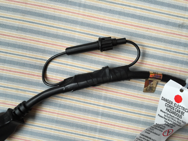

I was wondering if anyone makes a fused outlet or cord that I could install between the block heater and the extension cord. If I had a fuse that was appropriately sized for protecting the pig-tail, I think the fuse would blow safely and the cord would not catch fire. I'm going to look for on on-line today. If I find one, I'll post the details.

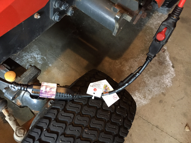

I looked around for a convenient way to add a fuse to the cord and here are my findings...
First, the cord on the block heater is 18 gauge wire with a 10 amp rating. My extension cord is 16 gauge, my circuit is 12 gauge with a 15 amp breaker, so the block heater cord was the weakest link.
I didn't find anything that was available "off the shelf" that fit my application. I decided to make something simple. Here are the parts I used.
A 12" long 16 gauge extension cord, lighted plug, fuse holder, 10 amp fuse...also two wire nuts and some black electrical tape. I purchased most of these parts on Amazon, just because it was easy.
I carefully sliced open the cord jacket and teased out the black wire. I snipped it and stripped it as appropriate for wire nut connections. I snipped and stripped the fuse holder leads as well. Twisted and applied the wire nuts to both ends. Then taped the cords.
I installed the cord with the lighted plug on the end nearest the block heater so I can quickly see the power is still available to the block heater or conversely, I'll see when the power is off for some reason...fuse or otherwise.
That's it. Pretty simple. I feel better knowing my little fuse should blow before the cord fries.
