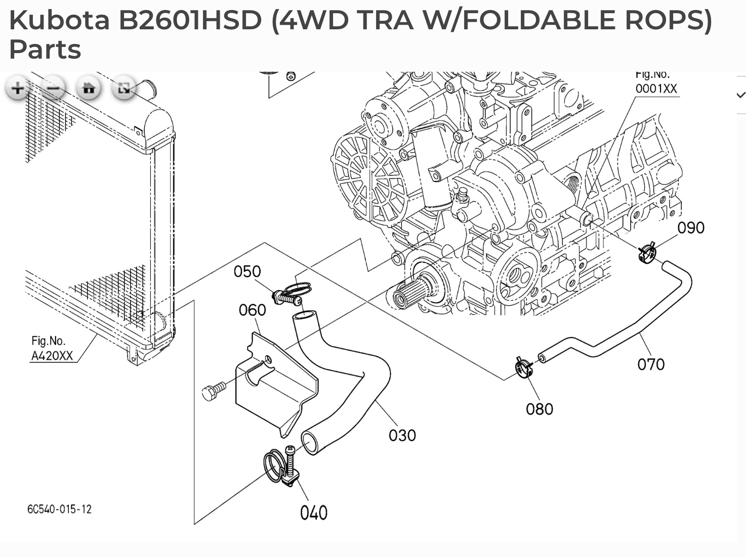

Time for a coolant change on my B2601. Does anyone know if there is a plug or something on the engine to drain the block. I would guess that just removing the lower radiator hose, you would still have near 50% of the old coolant remaining in the block.

The workshop manual says to remove the engine side coolant return hose on the left side of the block as shown in the below parts diagram to drain coolant (#70). There appears to be a hex plug immediately above the hose also.
Not on a B2601, but I just remove the lower radiator hose and flush with clean water as JWR does, and use undiluted coolant to get the correct 50/50 final mix.
