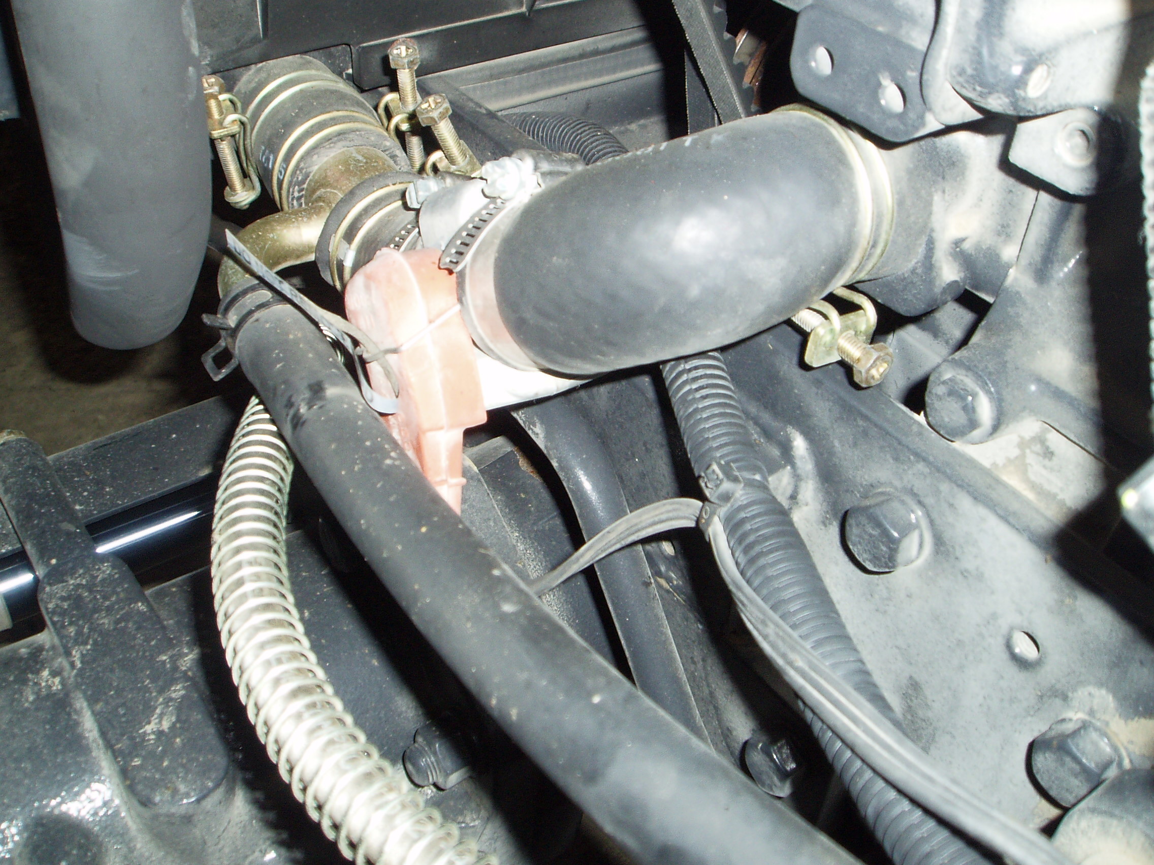

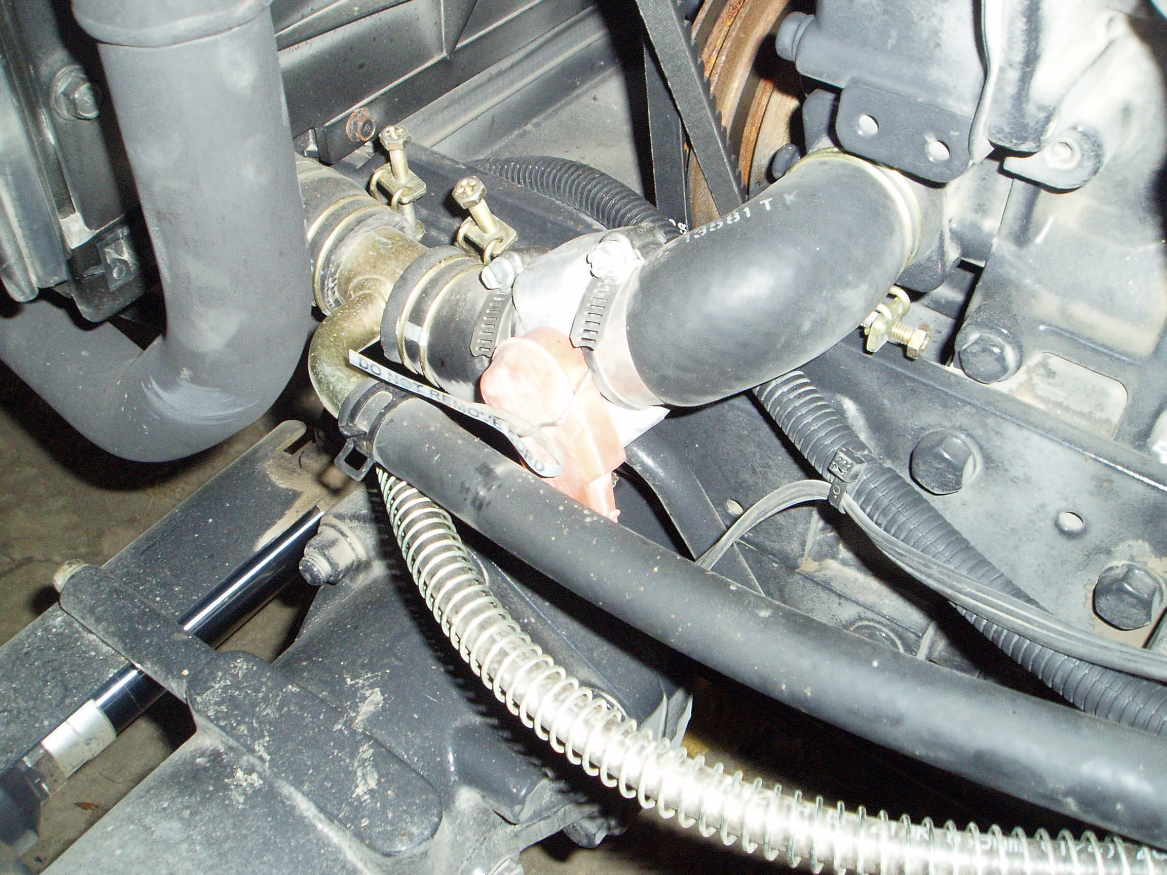

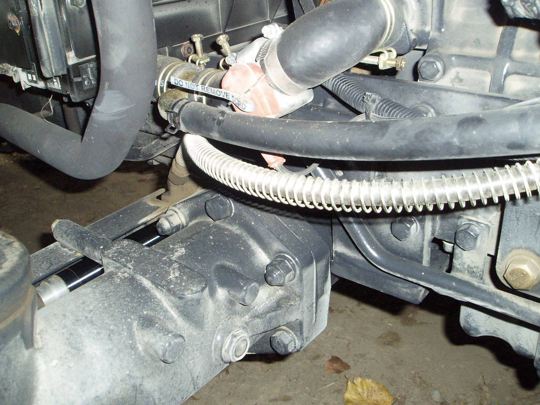

I don't like starting a cold diesel in the dead of winter and it can be plenty cold where I am located in January & February.
I discussed this with my dealer and he told me that Kioti's official stance on this is their tractors do not require a block heater.
The dealer agreed with me that a block heater is preferred and it means you get instant heat in the cab with you start it up.
The dealer recommended a lower rad hose heater and if there was ever a problem with the engine, a simple swap of the lower hose would bring the tractor back into warranty compliance.
I inspected the lower hose on the weekend and noticed that return water line from the cab heat exchanger is located there, I think I can sneak the heater in front of the cab return line but the heater will be sitting level with the ground which is sub optimal from what I can understand and there isn't enough room to put one after the return line.
Has anyone else run up against this problem? What was your solution? At this point I'm thinking that it's either going to be a case of doing without or get the Bobcat kit and modify then engine or go with a magnetic heater if there is a clear spot to stick one.

My dealer installs lower rad heaters standard and did so on both my CK30 and DK45 cab. It's a little tight in there, but it fits exactly where you described on the DK. I haven't had the DK45 though the winter, but the heater worked very well with the CK30. I had a true block heater on my JD 955 and I think it was faster, but the lower rad heater does the job too. I've never heard about the warranty being an issue. I've never asked to have it installed, they just come that way from my dealer. I'd have to imagine he'd have to stand behind it.
Can you get a picture of how they installed it so I can compare to the factory layout?
Jason
/ Block heater for cab tractors #12
Jason
No problem, I'll try and get it for you tomorrow. It's a really busy day, so don't feel bad reminding me tomorrow night if I don't post a pic by then.
/ Block heater for cab tractors #13
Jason
Here's what I have.
#14
I see what they did, and it's what I was thinking about too.
The cab heater return line is normally placed (at least on my tractor) where the heater is located on yours. By placing the heater where the return is normally placed they were able to l mount it on an angle. Clearly your tractor had enough slack in the heater hose to move it a couple inches down, hopefully mine has enough slack too.
