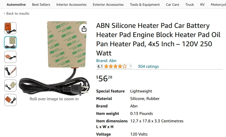

/ Engine heater #13
I did the same thing. What I do is use a bottle jack and use that to hold the magnetic heater up against the oil pan, works fine.
Cold humans can be ingenious creatures......
Look.......they created a 3M stick-on made of silicone for those pesky aluminum oil pans (careful on how you torque the oil pan drain bolt).
Silicone oil pan heater with 3M adhesive

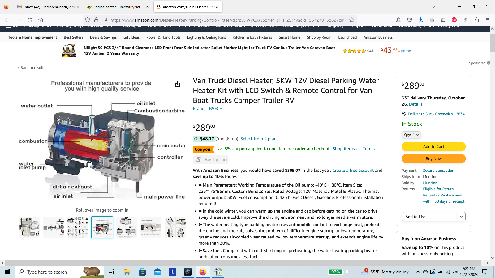

Block heaters are very good and efficient, lower radiator hose heaters work somewhat well.
The convection and circulating heaters work nicely.
However I have been thinking more and more of trying one of these;
/ Engine heater #15
/ Engine heater #16
I bought an Espar coolant heater 20+ years ago for a Mercedes car I had with a diesel engine. I would park at the train station and set the timer so that it would start 30 minutes before I arrived, one of the greatest investment I made.
Fast forward, I scrapped the car, but kept the heater, it now is in my old JD backhoe. 20 minutes of running and the engine is ready to start.
I contemplated adding it to my Kioti, but there is no good place to mount it and I've never had an issue with starting it in cold weather.
I think I paid $1000 for the Espar unit, I'm sure you won't get the service life out of the Chinese unit, but for the price of one, buy 2.
/ Engine heater #17
When I lived in Alaska, we had lots of folks just smear the oil pan heaters with JB Weld to hold them on to their cars. Luckily my Tacoma at the time had a ready made insert in the rear of the block for a heater which I installed.
