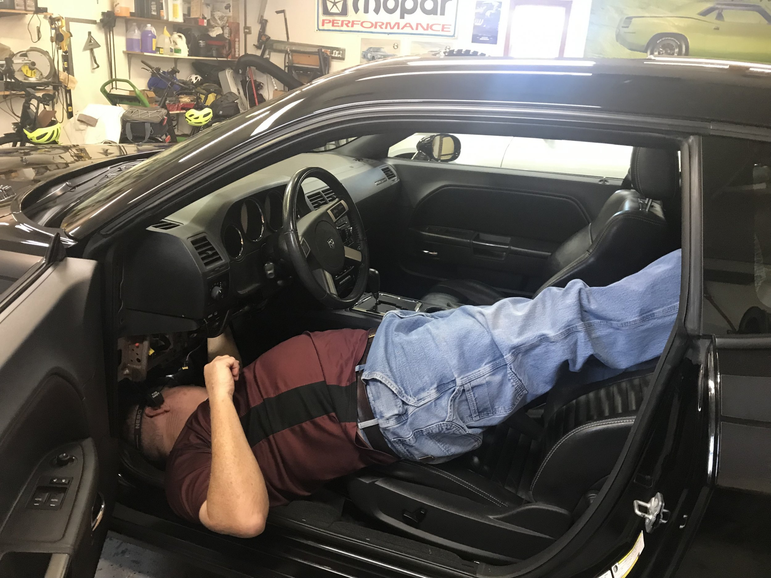

I replaced two of the blend door actuators on my 2010 Challenger today. Car has 22,000 miles on it. I drove it to town yesterday and no heat. I think only one was bad but I did both while I was in there. You have to stand on your head to change one of them. Apparently they sharpen everything under the dash because I darn near needed a blood transfusion afterwards. Took me about 3 1/2 hours, about $75. I did one several years ago on my daughters Impala and it was behind the glove box but still took a while to do. I don’t know why some of these parts are so cheaply made.
My wife thought the first picture was funny, the second picture shows the scrapes, the other arm was worse.

You have to be a real contortionist to do some of the work on cars.
/ Blend door actuators. #3
i learned real fast its easier and better for my back to just remove the seat completely, its usually only 4 bolts and a couple electrical connectors.

Well, I spent 3 hours upside down in both the passenger and driver seats in the 2013 Impala and changed two of the 3 door motors. The easy one to get to wasn't bad! Go figure. :ROFLMAO:
Word to the wise... watch many u-tube videos. The first few I watched said I had to take the glovebox apart. After taking at apart another video showed how to just pull two pins underneath it and the whole thing pops out. Grrr... 🙃
The outside air/inside air door motor was bad, and the driver's side temperature control motor was bad. The first one had a couple teeth missing from the gear on the bottom, and the 2nd had some missing from a top gear.
$38 at autozone. Could have gotten them cheaper on line, but I wanted it done.
My wife walked by the car and started laughing as my contorted body was hanging upside down in the seat.

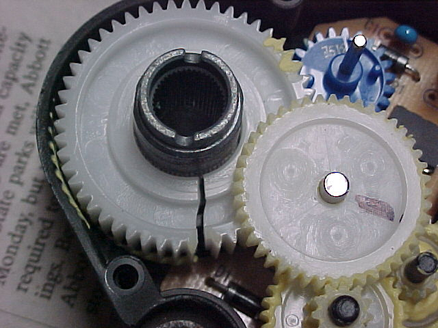

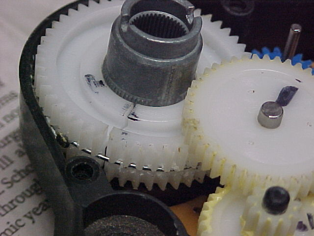

You are lucky that the replacement part was available to purchase. Two years ago, the blend door on my 1999 Dodge 3500 8 passenger van stopped working. Took me a while to figure out what the problem was. So after determining that the blend door mechanism was not working, I checked with the local auto parts places, nope, nothing for your van, sorry.
Then went to Dodge, sorry, Dodge no longer carries parts for that van. So now what ?
I took the part out of the van, was not to hard once I figured out that taking out the glove box first was the trick. Took the motor apart to find that the cheep why that they put the thing together was the problem. They have a plastic gear in which they pressed a metal shaft into the center of the gear. Well what a surprise, the plastic gear split and thus the shaft would slip and not do the job.
Here is a photo of the split plastic gear:
Well crap, it's either throw away a 99 Dodge van, or do something. So here was my fix.
I carefully cut a grove all the way around the center of the plastic gear, then put a small wire around it in the grove and twisted it very tight. As the rotation of the large gear was only about 90 degrees, I just made sure that the wire twist would not get in the way of the drive gear.
Still working fine.

Nice repair.
