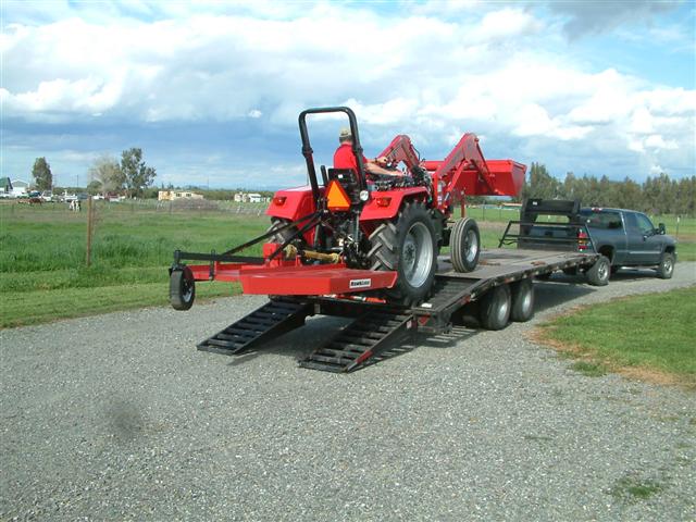

80 acres, huh. Rolling terrain I would guess. I wouldn't tackle your plans with anything less than 50 hp pto. Something like my 2008 Mahindra 5525 (54 hp engine, 45 hp pto, 2WD, gear tranny 8F/2R, power steering) with the ML250 FEL (6-ft wide bucket, 2950 lb lift to 10.5 ft, skid steer quick attach option on the FEL arms). Cost: new, about $19K plus tax.
DSCF0056 (Small).JPGDSCF0061 (Small).JPGDSCF0062 (Small).JPGDSCF0110 (Small).JPG
JD has one or more models equivalent to this 5525 if you like green and yellow.
That's a 6-ft Hawkline rotary mower (aka bush hog, brush hog, shredder, slasher) hanging on the back of the 5525. OK if you have 40 acres or less to mow. If you plan to mow your entire place, it'll take a lot of seat time with a 6-ft mower. YOu'll need to get a bigger tractor/mower combo--10-ft dual blade for example.
I'd think very carefully about your detailed plans for the next 5 years and size your tractor accordingly. My first tractor was that little 2005 Kubota B7510HST in the photos (21 hp engine, 17 hp pto, 4WD, hydro tranny, power steering) with the LA302 FEL (4-ft wide bucket, 800 lb lift to about 8 ft height). It was fine for the work I needed to do around my 10 acre place (flat pasture) when the house was being built 6 years ago (installing paver block walk ways, patio, landscaping, general toting jobs with the FEL, etc). But when I decided to become a hay farmer (another moderately expensive hobby of mine), I traded that 7510 after 3 years for that much larger 5525.
Good luck and have fun with your new tractor.

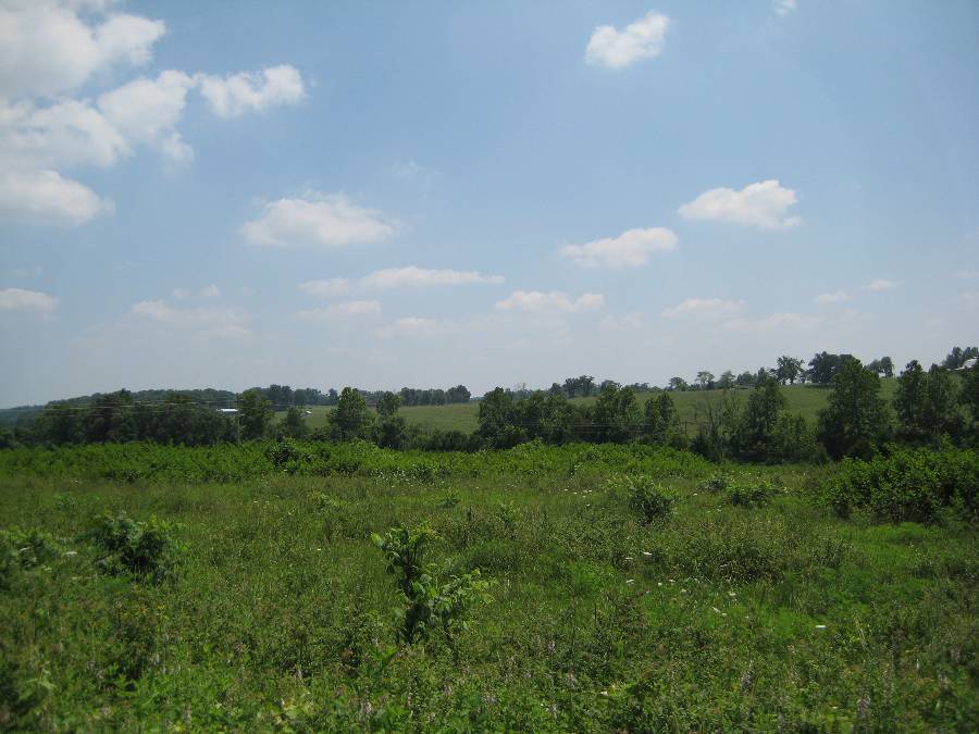

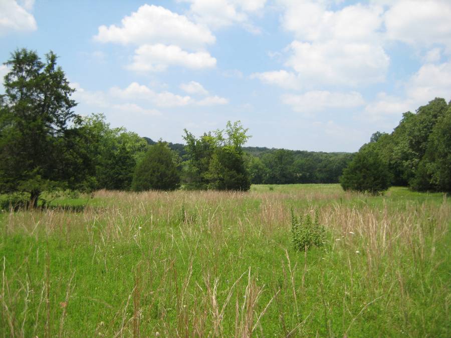

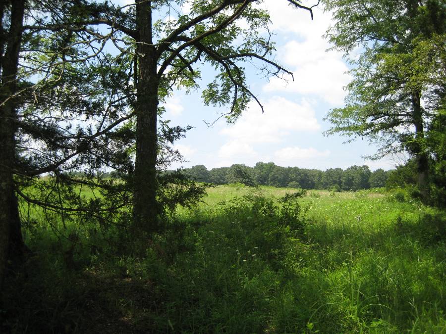

Here are some pics of my new property as promised:

Looks like a nice property congrats on that too.
