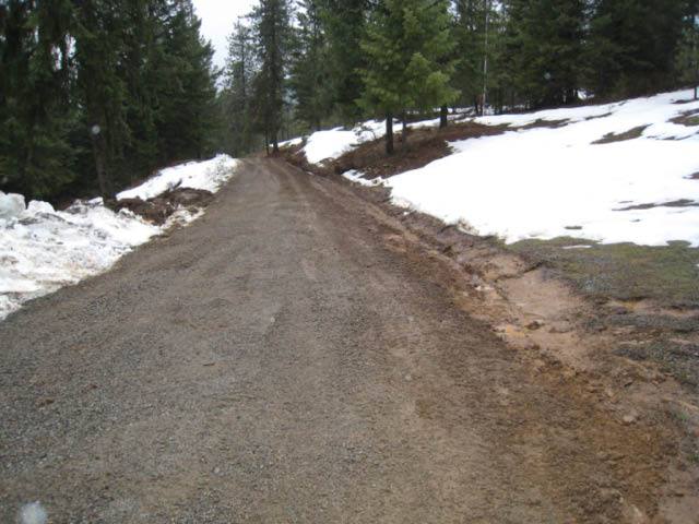

My road needs a ditch on the up-hill side, to prevent run-off from washing over the road. I'd also like to smooth out some bumps and depressions.
The tools I have at hand are a JD2210, and a 6' blade. So I went out yesterday to see what kind of damage I could do. I don't yet have a box blade.
When I'm driving along the front wheels will drop in to a depression, and the blade will lift, leaving a mound. Then the back wheels drop in and the blade scoops out a divot. By the time I'm done, I've taken one hole and turned it in to two, plus added a mound! What can I do to reduce that effect?

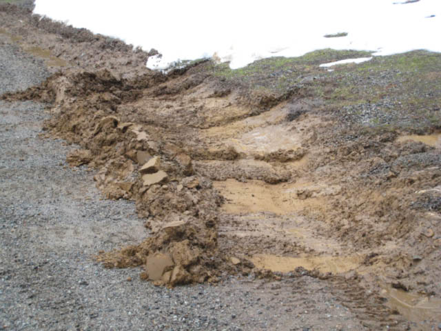

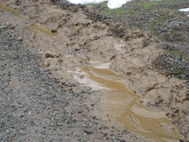

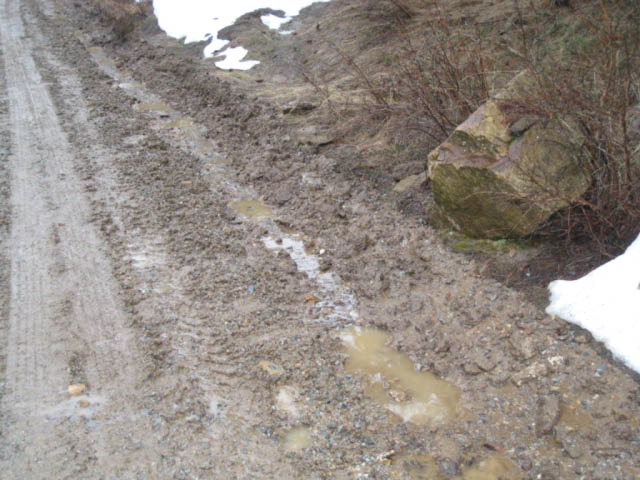

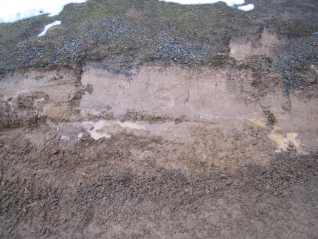

I went back out today to have some more fun in the mud. Yesterday I was trying to use the blade to carve out the ditch as I drove down the road. That mostly just put mud on my gravel for me, and left a pretty rough ditch as the blade bounced over rocks.
Results from yesterday:
So I decided that I'd scrape out the ditch a bite at a time by backing up and dropping the blade, then use the loader to scoop up the dirt and cart it away. That made a nice rounded ditch but took a lot of forwards/backwards. Also quite the pain to pickup the mud/dirt and throw it over the edge of the road.
Then I made some passes with the blade, but ended up cutting though the gravel to the dirt underneath in a few places- hope that doesn't make mud puddles before the road restrictions come off and I can get some gravel up here...

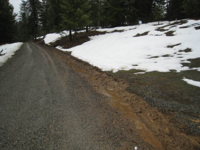

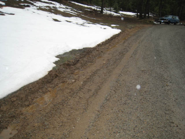

I just walked the road again, and it is still pretty rough. Looks like I need to work on the ditch more and get that looking better (I'll try the bucket as suggested).
I don't have down-force on my 3ph, so I think it just floats all the time. One thing I'm not sure on yet is where to adjust the angle of the blade. If I set it to cut shallow, I can't even lift it off the ground- not enough clearance with this big blade. So I mostly leave it so the support arm is horizontal to the ground.
From what you guys say, it looks like I need to make a few more passes to drag material to the center, then a pass to spread it back out again with the blade backwards. I'll give that a try too.

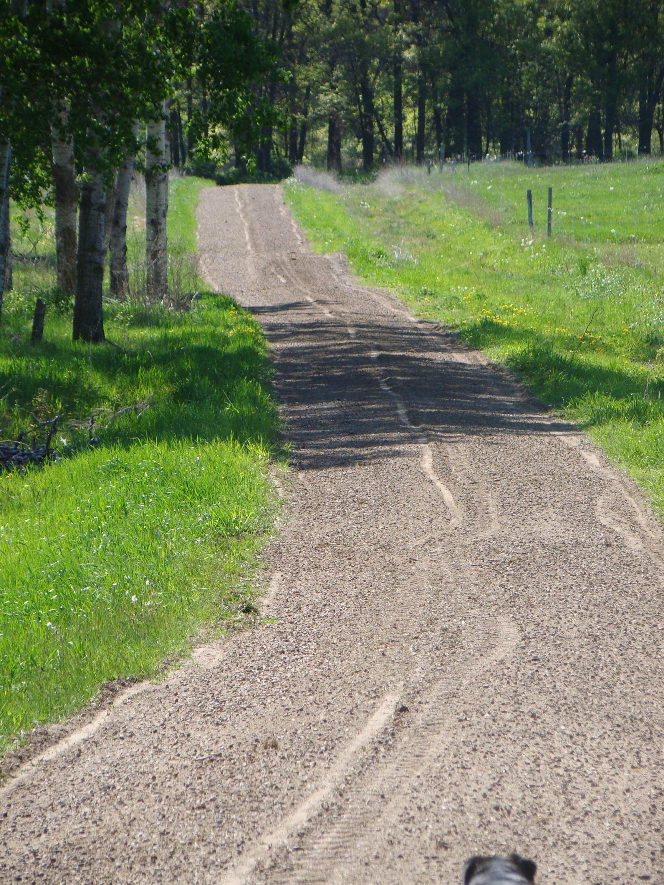

If you want to maintain a gravel driveway with a rear blade you need to take the same approach as the counties do with the big road graders. It is best to wait until after a rain. The gravel and fines will mix together better. They angle the blade so it moved the material to the center of the road where it leaves a windrow. Then they make another run with the blade angled so it will smooth that material out as it pushes it back out were it came from. They will repeat this process for both sides. They will also re-establish the crown down the center of the road.
Here is a picture of my driveway now. I planted some pature mix grasses in the ditches and on the slopes. I had just gone over the driveway with my Land Pride grading scraper. This impelement makes maintaining a gravel driveway a piece of cake. It even works best if the driveway is dry so I don't have to wait until after a rain. I just drop the implement down on the driveway and drag it along, no need to keep adjusting the 3 point. It helps maintain the center crown and it brings all the gravel back to the surface. I just drive down and back on the driveway. I just stay on the right side of the driveway and it build the crown back up. It's a huge time saver and is pretty much fool proof.
