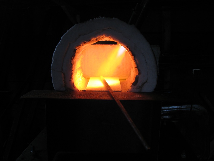

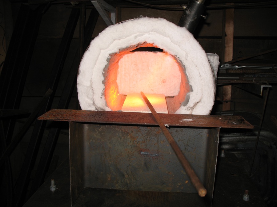

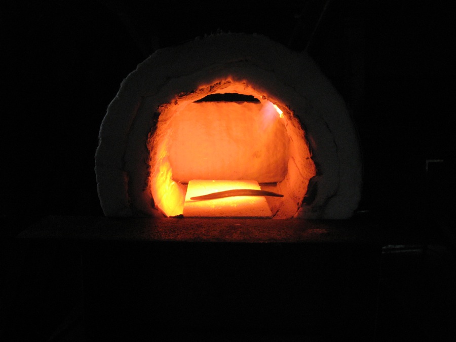

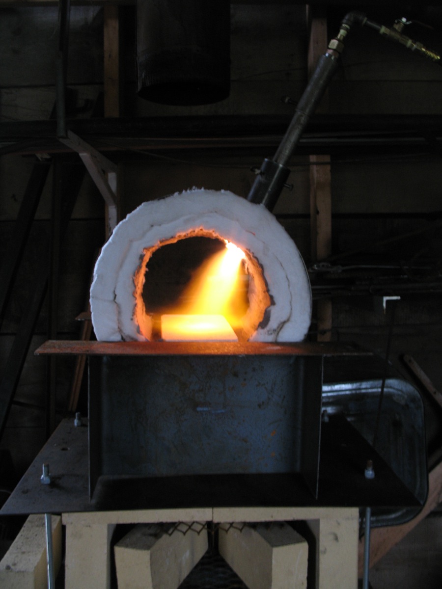

One of my 'country' interests is blacksmithing.
We (blacksmithing group) recently spent a weekend building 22 propane forges.
The following is the result of our two day workshop. I used coal in the past but find it dirty
and not safe. My shop has a wood floor and I would spend too much time checking on the building well after using the forge. With the gas forge (it cools down in less than 30 minutes) I can walk away and check it once. The forge will get to a welding heat 2700f degrees.
Lloyd

What is the insulation material that is used for the walls?
/ Blacksmithing
The material is from a ceramics/kiln supplier:
1 inch thick 8 lb density 2600 degree F ceramic fibre blanket - Kaowool.
The two layers provide a 5200 degree blanket.
We also coated the blanket with Mortar Vesuvius 3000 degree F.
I can send you a PDF file on the construction if you like.

Polo,
I am new to this. But it can achieve welding heat no problem. I will go through my books to get specs on temperature. What you see is a flame based on 4lbs pressure out-put from a 20 lb. (BBQ) tank. From experience within our blacksmith's group some members have welded with this unit and the pressure is increased from 4 to 10-15 lbs but no higher than 15 lbs. Running at 4 lbs, generally you can run 10 to 12 hours straight. I have not tested this yet. No sure about natural gas - you have more expertise than I.
There are lots of sites on the net dealing with this type of forge and burner design:
anvilefire.com, you tube has great video of forge production, holisticforgeworks.com,
Forge and Burner Design Page #1, Building the forge
These are just a few I googled.
See my previous post #6 for PDF.
Lloyd

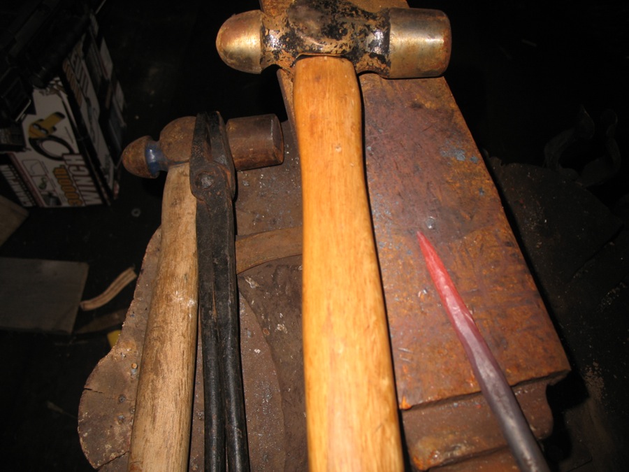

I just checked one of my books and forge welding occurs as follows:
Colour of metal:
red 1400f
orange 1800f
yellow 2100f
light yellow 2300f (need this temp to forge weld mild steel)
melting/sparking and burning 2400f
The image of the rod (3rd photo) shows yellow/white - 2100f+.
I guess tomorrow I will try melt/burn some steel!
Lloyd
