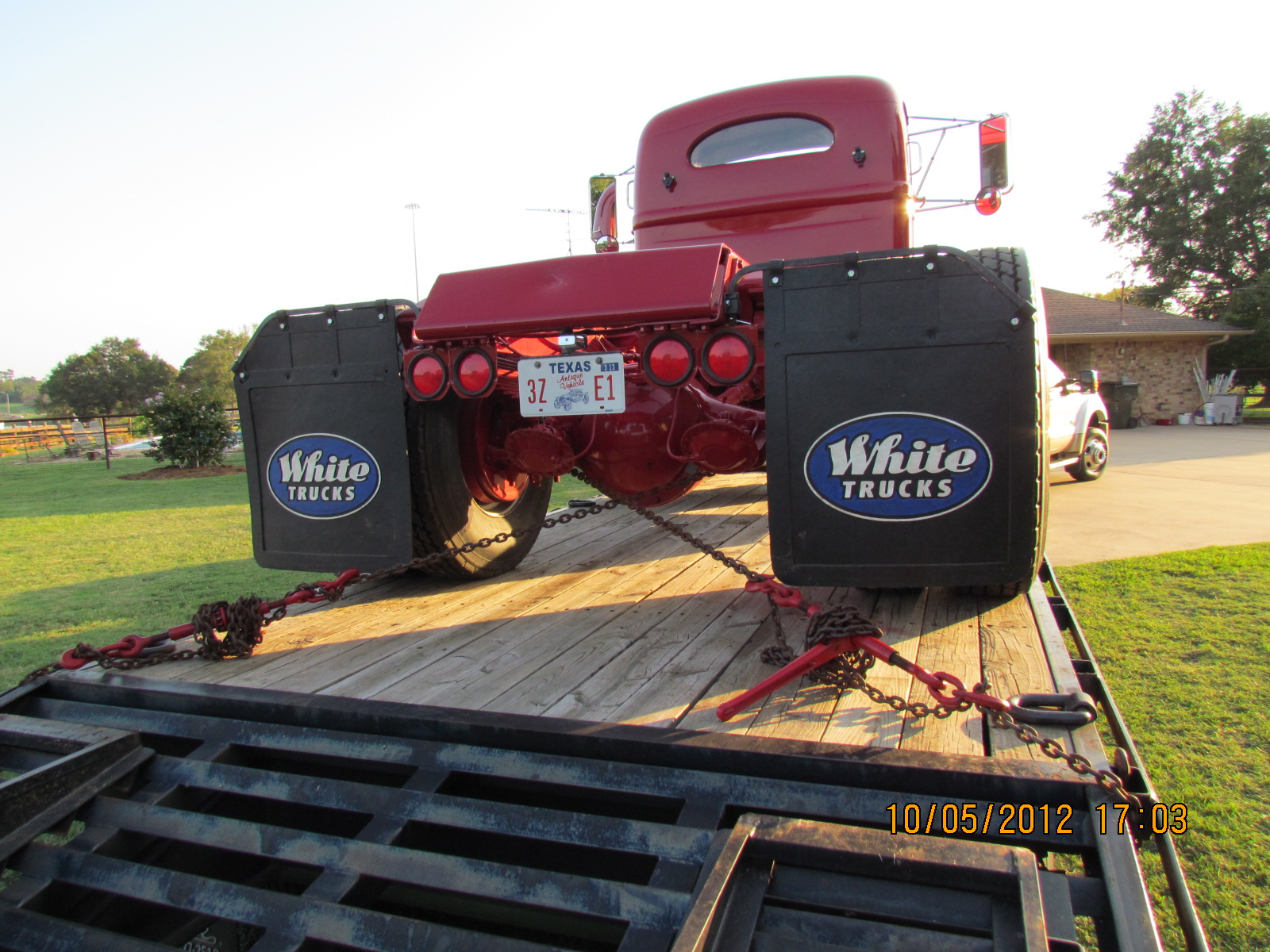

Just so happens I loaded up my '56 White Friday to take it to Temple, Texas to the Texas Early Days Tractor and Engine show. This is how I tie down my trucks or tractors. I use the breakover binders on the front and ratchet binders on the rear. I tie down the front first and can take up any slack when I tie down the rear with the ratchet binders.
Sweet looking truck, would love to drive one of those around the block.

The front looks like it is around the axle and paint. With the restore, you did not add hooks or something for chain points, to keep that paint nice?

There's not a good place to add hooks. I thought about nylon straps but where I hook the chains you really can't see the chipped paint. These trucks had a lot of chipped paint when they were being used, a few more chips won't hurt them. I am very particular about the cab and fenders, I won't take any chances with them. That red paint cost a lot of overtime!

Take old tire on cut it down and lay the tread down on the axle and the chain on the wheel side of the tire.
