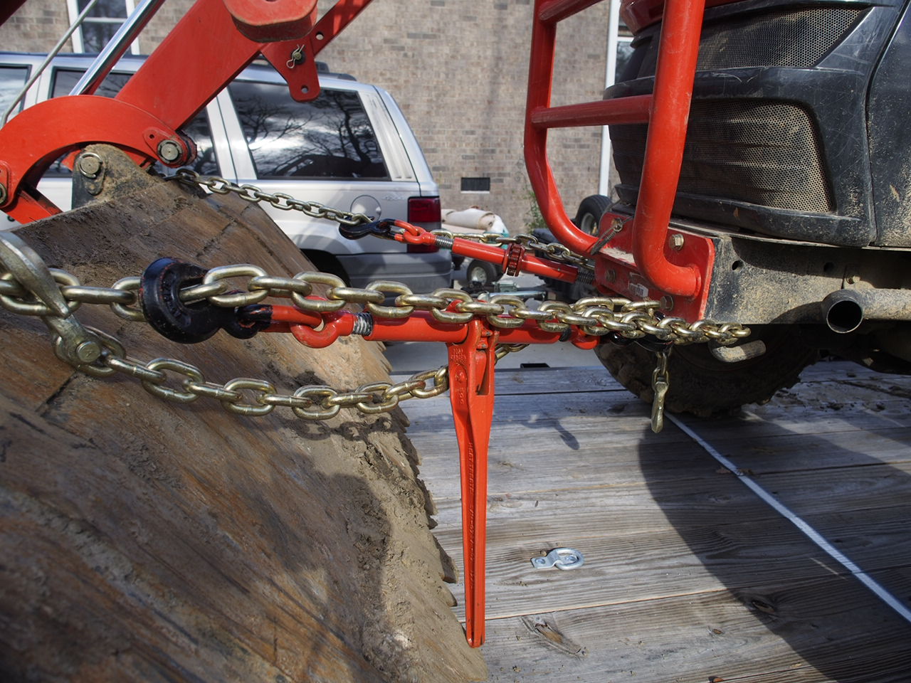

Some states require ratchet binders only FYI dont need the truck squad pinching you
I am not aware of any states that have that law. Lever binders are DOT approved. Many companies prohibit their use, but I am pretty sure they are legal in any state.
