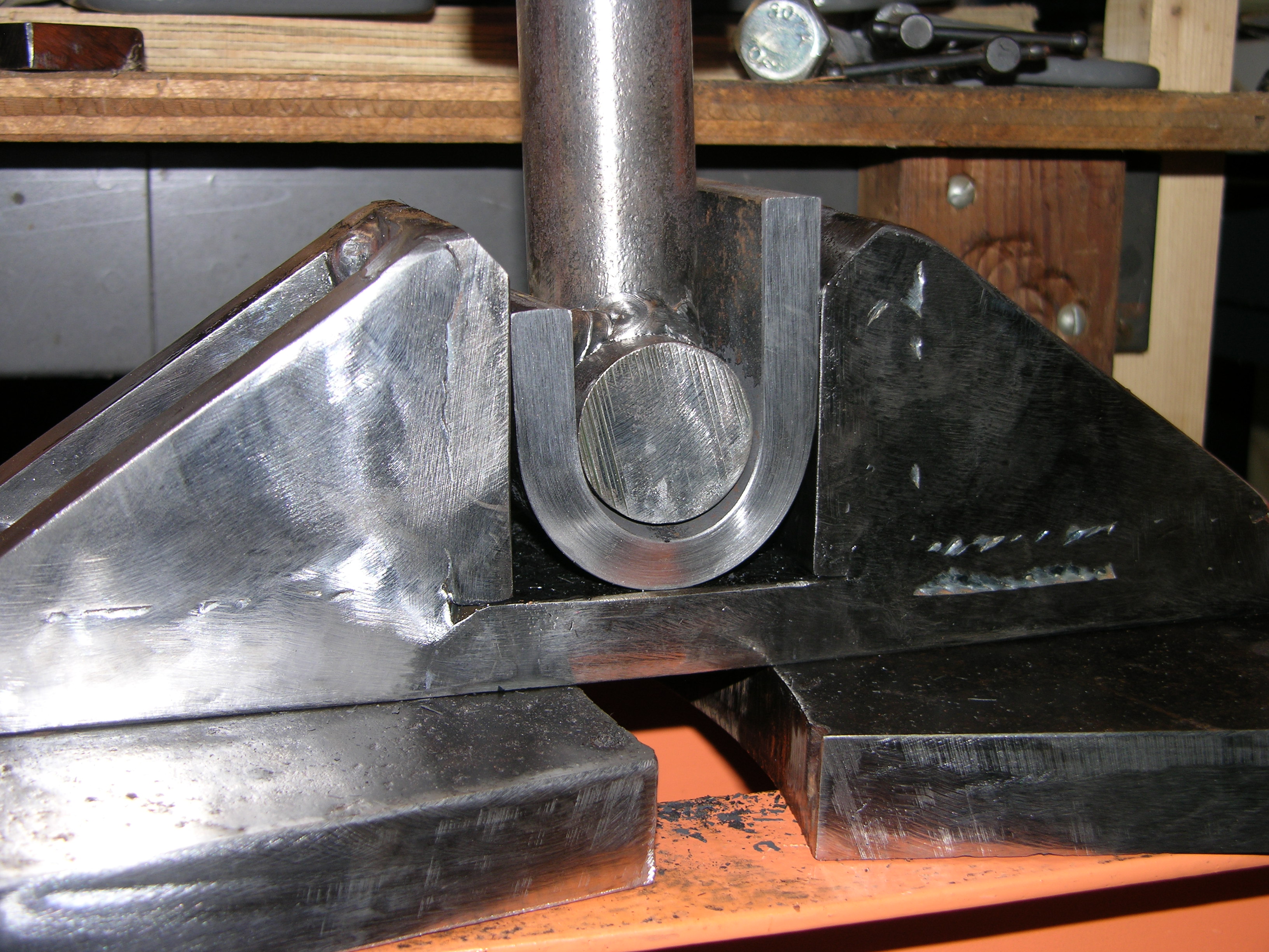

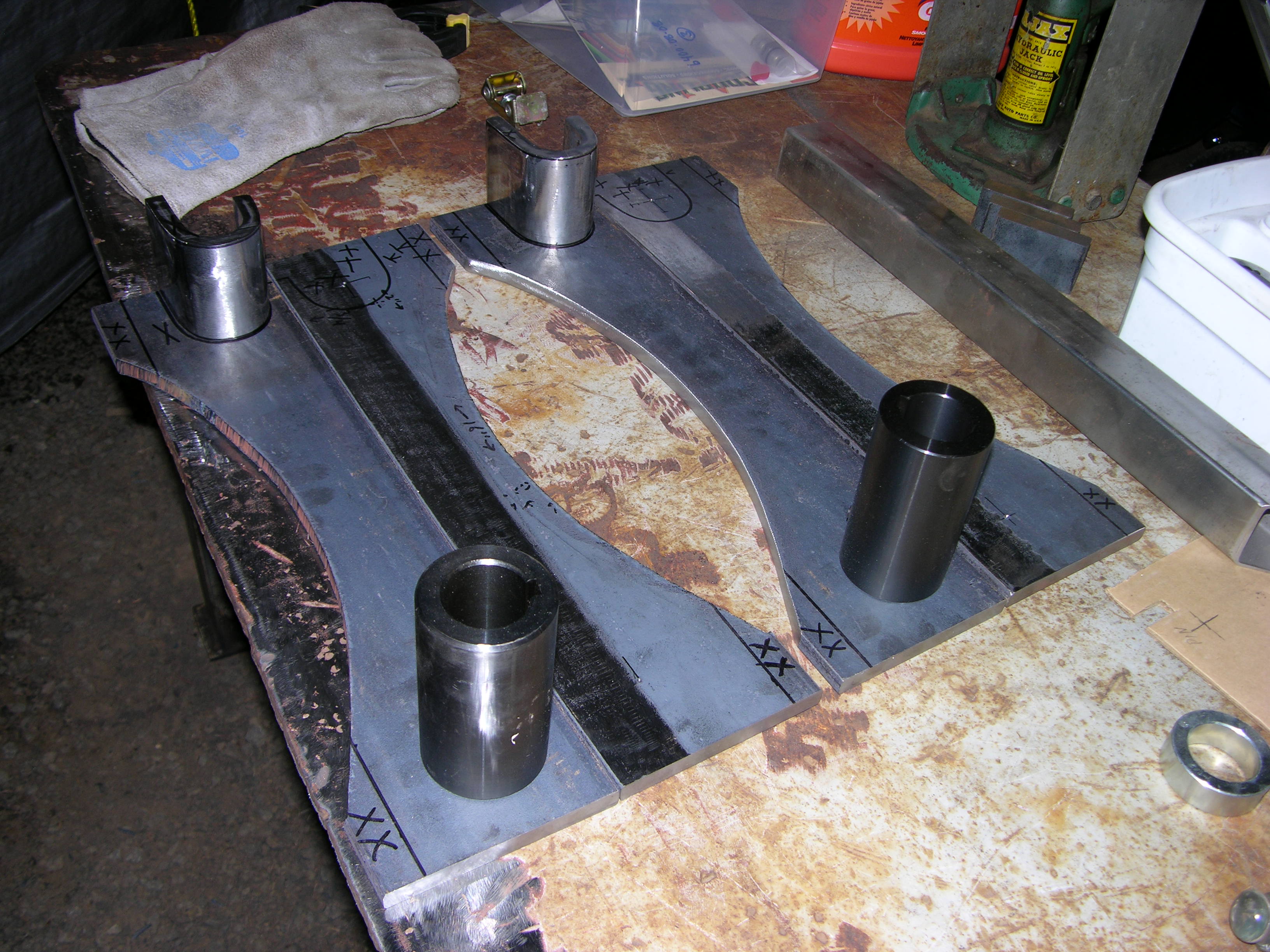

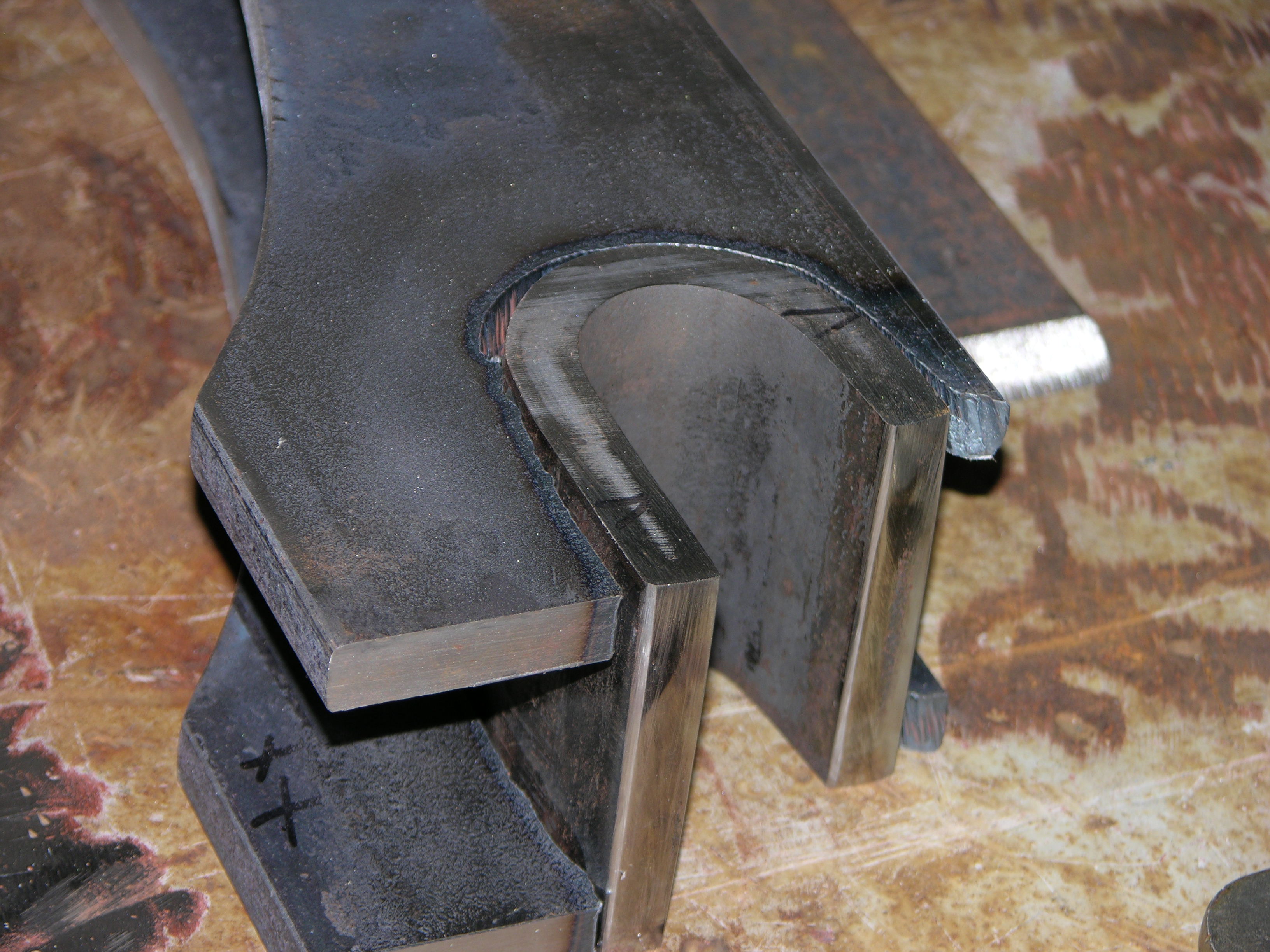

Agree with Downsizing and Ron; I got mine here
1-1/2 Shaft Coupler | Concentric International | Brands | www.surpluscenter.com
used 'em whole for parts of my loader QA setup (not finished yet) and sliced 'em into 3/4" thick weldable bushings for other parts (horizontal band saw)
DSCN1324.JPG Bent 1/2 x 3 FB "U" brackets into 1-1/2" ID for upper pin attach using my 20 ton press DSCN1327.JPG DSCN1296.JPG
The plan (when I get back to it) is to leave pins in all upper mount holes of implements (original bucket, grapple, fork lift, brush forks, brush bucket, 3ph adapter) so I can lift implement by the upper pins (in the hooks), then curl it up and insert lower pins.
If I get REALLY ambitious I may adapt the same plan to hoe buckets later... Steve
Also agree with making larger ears if necessary to get 1-1/2" holes without losing strength - my hoe has about 9400 lbs breakout, not a job for bungee cords...
