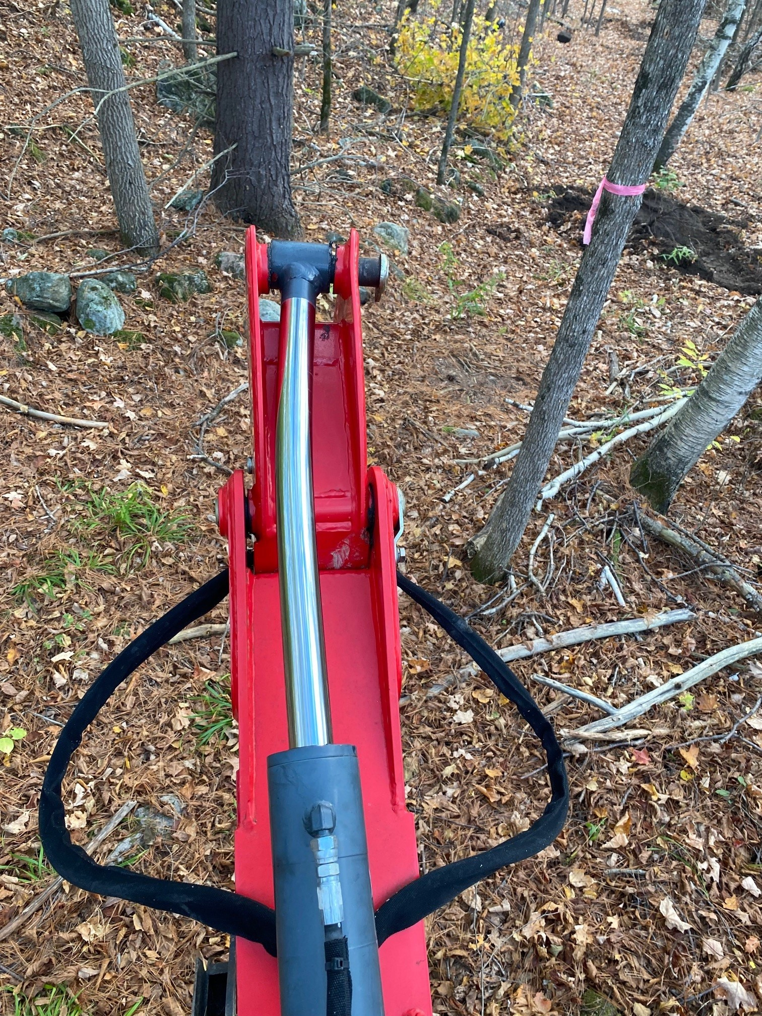

Does anyone know the length of the Branson BH860 backhoe, from the front of the frame to the back of the hoe?
I need to get it from my woodlot to the dealer/repair shop (unfortunate encounter with a very large boulder...) and I'm trying to figure out if I can transport it myself on a 6x12 utility trailer or need to float it. I've found the backhoe weight (1500 lbs) online, but not the length, and neglected to measure it when I was at the woodlot yesterday. I'm now back at home...
BTW, interesting(?) accident.
As far as I can tell, somewhere, somehow the bolt holding the pin at the top of the stick in place sheared, and the pin probably started wiggling out. I didn't notice. I did do a visual inspection in the morning, so it either happened since then or I just didn't notice.
Nothing happened while I was digging dirt. But then I was rolling off (to the side) a large 30" boulder, at the backhoe's capability limits. I extended the stick cylinder to get a better angle while the weight of the boulder rested against the side of the bucket. With the stick pin held only by one side plate, the cylinder itself ended up getting torqued and bent as it extended. The side plate where the pin is still holding is bent too, so the pin won't go back in the other side.
The cylinder still operates and -- so far -- no leakage. But doesn't feel like a good idea to continue digging boulders and stumps, and more than I can fix in the field with crescent wrench, hammer, and large boulder as tools :)

I’d simply pull the cylinder off instead of hauling the entire backhoe to the shop. I’ve bent a cylinder one and with my 20 ton shop press and some oak blocks, I got it straightened out & worked fine ever since.
/ BH860 backhoe transport length? #4
+1
Definitely seems like less effort to haul that way
And as the force on the rod is along the length (most of the time...), a minor reduction in strength from the bending and (un)bending shouldn't affect usability much at all.
My guess is that the side weight didn't make much difference on this failure; the tweak would've happened without it because the pin not being anchored at both ends allowed some rotation up there which set up the cylinder not to extend in a straight fashion. I'd check the bore that the pin goes through on the right side if you pull the cylinder yourself for repair; I leave it to more knowledgeable folks to provide a repair suggestion if the bore got ovalled by the tweak.

Thanks. I'll take another look, but I think it's not only the cylinder that's bent but also the hoe side plate "ear" on the side where the pin stayed in. But it's possible it's just the cylinder end throwing things off; I'll double check.
I'm still pretty new to all this. Is it easy to disconnect the cylinder from the hydraulic system, and then refill the hydraulic system after replacing it? I don't relish squirting pressurized hydraulic fluid everywhere (disconnected, of course), or having to "bleed the system" of air after filling it back up like a home heating radiator. Or maybe that's not needed?
/ BH860 backhoe transport length? #7
There shouldn't be pressure in the system if it's at rest (move the valves a bit). Unscrew the connections.
Bleeding = exercising it briefly before digging and the fluid will dump back to the reservoir.
I agree that that "ear" looks bent outwards. The ear has a nice heavy channel for the pin, so I doubt the pin ovaled the hole.
I wonder if you could use a hi-lift jack to clamp/bend it back?
/ BH860 backhoe transport length? #8
I agree with ning. The rod repair is the easy part. Getting force to bend the ear back is the challenge. Best method I can think of is to position the tractor between two anchor points, lower the inner boom, and get a high carbon steel rod with the same diameter in the bent ear hole and chain/strap the outside of it to pull it back in place. I’d imagine an 18” long will do the trick.

I appreciate the collective brainstorming on how to bend the metal "ear". Unfortunately, on closer inspection it turns out both ears are bent, and the small holding bolt was torn out with enough force to mangle its hole pretty badly. Since the machine is on an off-grid woodlot where I have no workshop, presses, bits of rod lying around, etc., it's more than I want to attempt to fix on-site myself.
I measured the backhoe myself. For future reference if anyone finds this thread, the length from front tip of subframe to the back plate where the boom is attached is precisely 108" (the boom and stick then hang off to the back from that). So it will fit a 12x6 trailer.

Returning to update, in case anyone ever excavates this thread from the archive.
The normal way to "park" a backhoe, with stabilizers and bucket down as a tripod, exceeds 12' in length. More importantly, it comes in at about 9' in width, exceeding not only a 6x12 trailer width but normal legal transport width of 8'6". My route to the shop passes a govt weigh scale and two police stations...
With the bucket and stabilizers up, it would fit widthwise and lengthwise (with a bit of overhang). However the centre of gravity is high and the backhoe doesn't balance in this position. Nothing creating a frame from 2x6s plus a bunch of straps wouldn't solve, but then I realized the weight distribution on the trailer would be off, and so I'd have to add concrete blocks or similar to even it out.
At this point I decided the writing was on the wall, put it back the tractor, and had it all professionally floated to the dealer's shop. To amortize the 6 hour 2x round-trip float time, I had them also do accumulated other small stuff that was needed but could have waited, perform the regular maintenance that I was going to do myself, and bring it back with a spanking new PTO woodchipper as an early Christmas present :)
Sometimes you just gotta make lemonade from lemons. And lesson learned; make sure your daily visual inspection actually looks at everything, not just random stuff.
