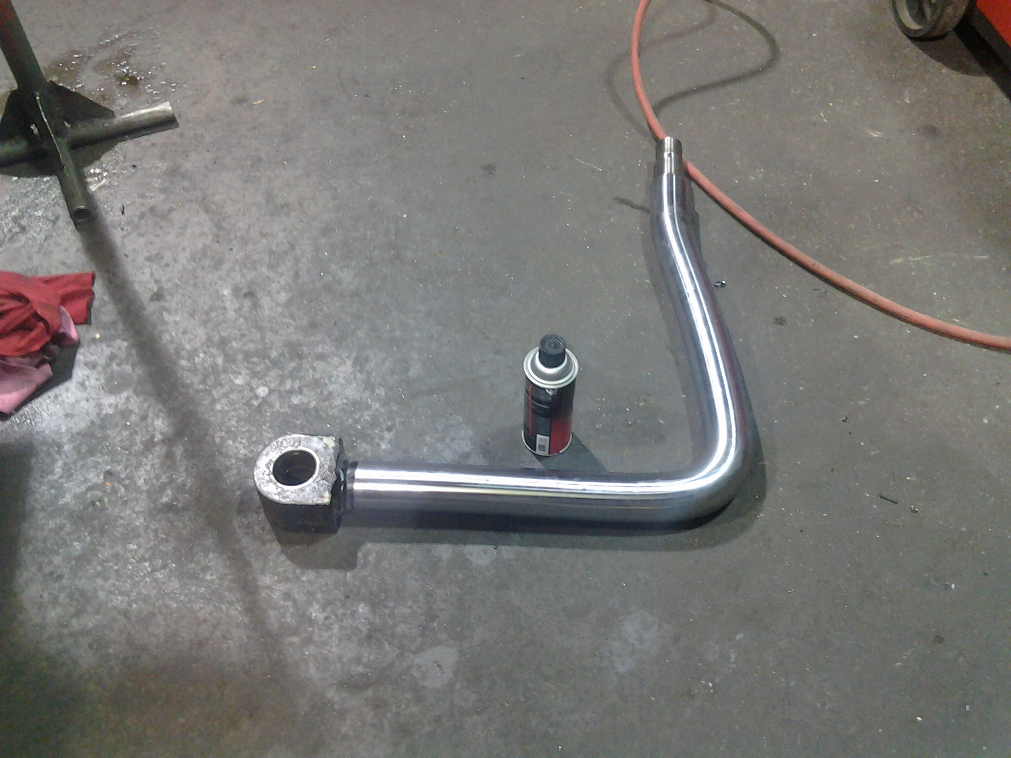

Check out this one from a thumb
it was 2.500" dia......believe it or not the cyl barrel was not damaged, the gland was wrecked though

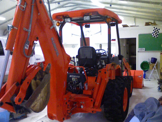

Just to clarify for those that may still be interested in the option of joystick control of the thumb. The electric solenoid push button switch that can be mounted on top of the joystick will switch back and forth between thumb open/close and boom left/right swing, so when you hit the switch to use the thumb, the right joystick curls the bucket and the left joystick opens/closes the thumb. And yes, you can FEATHER the thumb with this configuration, just like you can with the foot pedal configuration.
Gary, thanks for the heads-up. They're working on some ideas for keeping the foot pedal out of the way, and the B26 flip setup is one of the options they're investigating.
