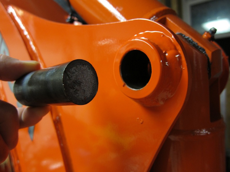

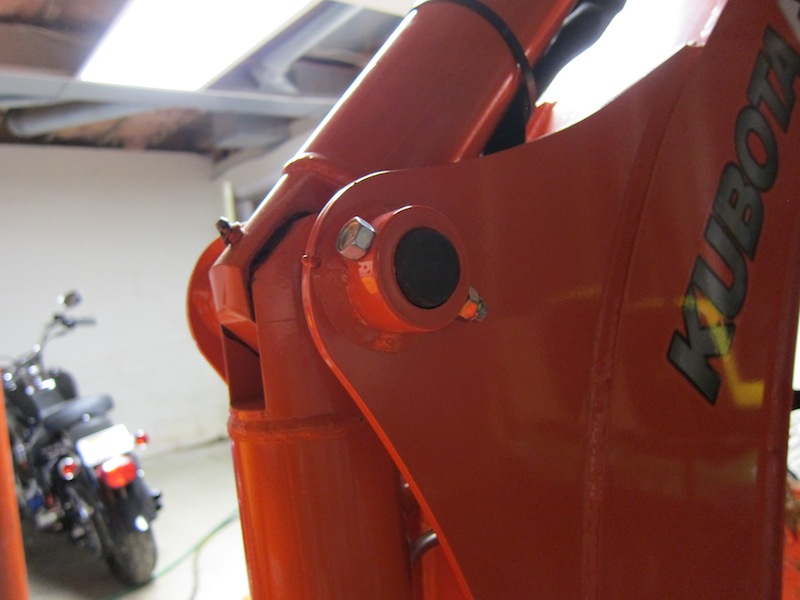

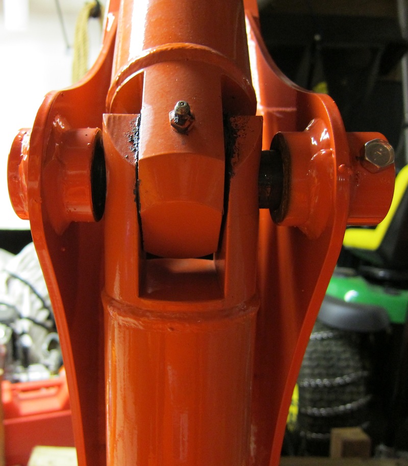

could be multi things. regardless for now need new pin.
pull the 2 cylinders apart. and double check inside diameter of each cylinder. by just putting the pin in. and see if it wiggles around some. if it wiggles to much. you might have found the problem.
beyond that, the frame would need to flex.
to me there seems like a good amount of spacing, and looks like washers are missing between cylinders and frame mount. but not a mechanic by no means. 555c TLB i have, everything fits fairly tight, exception of wear and tear of holes in the frame and pin wear.
/ BH77 broke - defective part? #22
I haven't seen a new one, but it sure looks to me like the frame is bent. Looks like it is tweaked out on both sides. Seems to me that it all should fit up pretty close with nowhere near that much space. Looks like the frame needs some strengthening in that area.
I would absolutely insist on a new unit. Keep working your way up the corporate ladder until you get results. Your dealer should be working on your behalf. That sort of damage to me is absolutely inexcuseable. It would certainly seem to me that it would be in Kubota's interest to remedy this situation. If not, I would think you could fight it in court and win pretty easily.
/ BH77 broke - defective part? #23
Move the cylinders out of the way and the new pin should fairly easily slide in.
If they are bent at all the holes wont be pointing at each other.

:) Hi all,
Just reading around to see if anyone else had the Bad Bh77 problem and I see the anwser is yes:laughing:. Well the pictures are not photo shopped or fake in any way. Kubota is aware that they have a problem.:mad:
I got my boom replaced and both cylinders also replaced along with my pin and gess what :mad: The pin broke a second time after about 1 hour into digging out a very small and rotted stump. Just like the Bh 77 that broke in this topic,very light digging had not even got to the point of wiggling the stump. My damage is not as severe because when the pin snapped it made a metalic pop sound and at that point I stopped digging and inspected the pin and discovered the fracture. At this point I am still waiting for kubota to contact me with a answer to the question of: What are you going to do? I dont really want a backhoe I have to dig in sand with:laughing:WTF Kubota.
ps. the spreading and or twisting of the ears on the backhoe is from pulling back the boom with half a pin in the boom(half that is bolted stays in other half falls out ) this makes the ears spread or twist depending on bucket load.:)

You guys who have call my post into question are correct, 99.9% of the time. Had a good friend that I grew up with who now works at a dealership (not a Kubota one) who was telling me that some time, when things don't go right at the factory (no grease on the pin) that a pin can corrode and get stuck in the bore. Backhoes are not very fast moving items (at least at his dealership) and he says that they often time sit in the crate or on the lot in the same postition for an extended peroid of time. I will say that I looked at the pictures (missed them the first time) and in my humble opinion, the pin did not look like it was froze in the bore in this case. Anyway, sorry for any confusion from my post.
/ BH77 broke - defective part? #32
Oh I forgot to add something. After see the pictures, the metal to me looks very crystalized in the center of the broken pin. Althought this in and of it self may not mean anything, it could point to a material defect. Again, just my opinion.

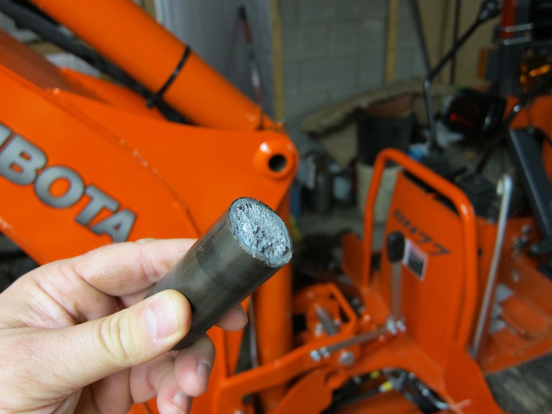

Here's some pics of the defective/broken pin. I've contacted the dealer that I purchased the tractor from and they are sending me another pin for it. I'm just a little worried that this may be a bigger issue than just replacing the pin now. It looks to me like it may have actually bent the frame that holds the cylinder...maybe torqued/pushed it out a little (see pic 3). Not sure how I'd get this pulled back in. I'm also concerned that it may have damaged the inside of the pin sleeve...perhaps scuffed it which could lead to additional wear later?
Feeling pretty sick about this right now...
I would be sick as well. It looks like it has bent. Replacing the pin is a temporary fix at best. Best of luck in getting this sorted out. Keep posting.
I thought it was just me. I've never seen the inside of one of these pins before, but that doesnt look right to me. I would think it should look like a solid piece of steel which has been cut, not like a broken piece of cast steel.

TwinCam88 this is not pointed at you:
I have to throw the BS card on the link posted to the broken bh77.
Look at the wear on the bucket. There is no way you can wear the paint off a Kubota bucket in 3 hours of use.
Then look at picture of the 3200 in his heated garage. That picture is PhotoShopped:ashamed:.
i dont see any indications of photoshopping it. Ive seen brand new buckets look like that in a few hours of digging. the machine looks cherry.
When a hardened pin or shaft breaks this is typical.....
The pin in question from the OP'r shows it was hardened (the outer layer is finer grain).......
Here's a pic of a 1.750 dia hardened hyd rod that snapped in one clean shot from todays machine work......notice the hardening in the outside approx 1/8 thick.....
This comes from an OEM CAT skidder hyd rod.....in the background you can see the finished rod installed....
