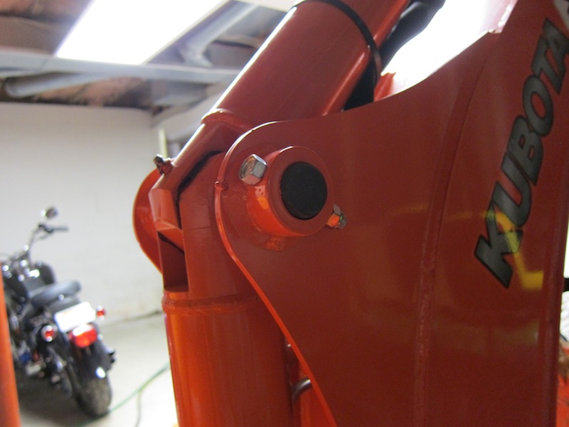

Well, somehow :confused: I managed to break my brand new BH77 the very first time using it. :( Not sure how as I was just digging the dirt around a stump that I was planning on removing. Thing is, I didn't even start trying to rip the stump out yet...so it wasn't working the hoe very hard. :mad: Anyway, as I'm swinging the boom around to dump the bucket, I notice that the pin (about an inch thick) that connects the hydraulic-cylinder to the boom looks like it is hanging out on one side. I stop everything and get off to look, and somehow the pin is broken in half. :shocked:
I'm not sure what the terminology is for each component yet. :ashamed: so I hope this makes sense. If not, I've attached a pic and marked the location of the pin that broke.
I'd appreciate any opinion/advice/wisdom on what I could have done that would have broke this pin (or thoughts on if it could have been defective) ...and of course, what to do to fix it?

That pin should last thousands of hours and slowly wear from friction but never crack in half. If this is a new unit, I'd assume a factory defect. Have the dealer replace it under warranty.
/ BH77 broke - defective part? #3
I beat the snot out of my BH on my little BX and nothing like that has happened. I vote for a defect.

That's a very common setup on the curved boom backhoes. All of the larger machines (Deere, CAT) use a similar design with two cylinders meeting at one pin. Personally, I don't think it looks like a very good idea. I'd much rather have independent pins.
And to think, here I was wishing I had the curved boom with the cylinder on the outside - I had just pulled my cylinder from inside my boom (BH75A) to replace a hose. I'm sorta glad now. Two identical failures like that on brand new backhoes is most definitely NOT coincidence. I wouldn't stop fighting until I got a new backhoe. Shouldn't happen - period.

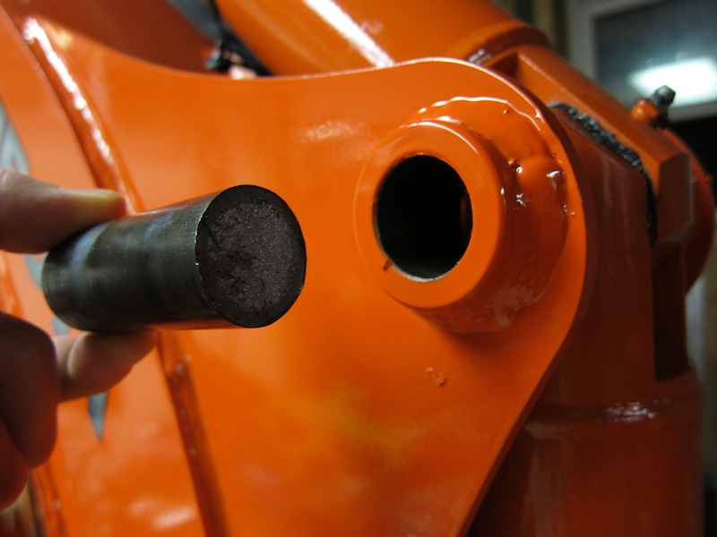

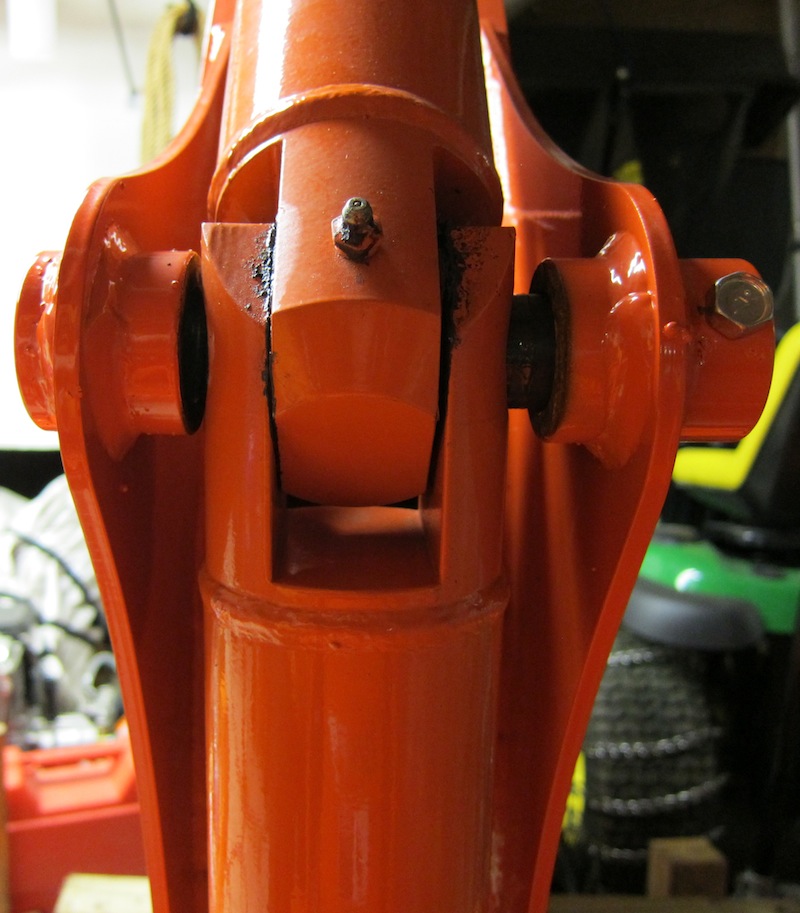

Looking at the picture of the other broken pin with the bent pin flanges, I would be very concerned. Are your boom flanges bent, or did you see the broken pin in time?
Obviously the pin diameter is too small. The tempering might also be wrong. I would demand a lifetime warranty on the pin, cylinder eyes, boom with full coverage for parts and labor. Have the warranty notarized or whatever it takes, to make it a binding legal document. If Kubota will not stand behind their product, then return it for a full refund. An identical pin will eventually break in the same fashion. Once the standard warranty has expired you will spend several thousand when the boom and cylinders are mangled.
After spending several thousand you will have the same setup, that will break again in the same fashion.
Everybody is building curved boom hoes, only because they look cool and modern. Looks like a poor design to me. The dipper cylinder is often times pushing on the center of the pin that is spanning a wide distance. Sand box engineering tells us that the pin only flex so many times before it breaks.

I agree....Sand box engineering also dictates that a machine is only as good as its weakest part......You found it......
I wonder if the yield and tensile strength was not enough for premature failure...there are many grades of steel with different methods of hardening for strength.....could have been an oversight with these pins or weak pin bosses welded into the structure/sideplates......
After this is repaired I'd be putting on a dial indicator in a vulnerable spot to check for flexing under strain while digging or simulating digging......
If it is flexing then it would show inferior/undersized materials used in manufacturing the BH

Here's some pics of the defective/broken pin. I've contacted the dealer that I purchased the tractor from and they are sending me another pin for it. I'm just a little worried that this may be a bigger issue than just replacing the pin now. It looks to me like it may have actually bent the frame that holds the cylinder...maybe torqued/pushed it out a little (see pic 3). Not sure how I'd get this pulled back in. I'm also concerned that it may have damaged the inside of the pin sleeve...perhaps scuffed it which could lead to additional wear later?
Feeling pretty sick about this right now...
