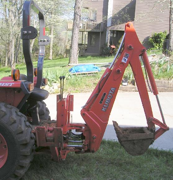

Volnavy,
thanks for the photos. Was the broken piston rod hollow by any chance? Lowering the system psi would anger me if it is currently at the recommended setting. You might find a valving problem within the hoe control to be at least one of the issues here. The hoe should not rely on the system relief valve to open and if you think about it, it really can't work that way. There are two hoses from the tractor system connected to the hoe. One is supply, always at system psi, the other is a return always dumping back into the reservoir. The hoe valve must contain a blow-off to dump into the return. When a cylinder is overloaded it should simply open the blow-off. I think maybe this is one of the issues. I doubt you could get two weak cylinders by coincidence. That said, the cylinder just may not be up to the job, and if so, Kubota will be aware of the issue but in an early state of denial (replace customer cylinders until they have a fix). I'm certain they will make you whole, given time. And by the way, that buckling can happen with the rod fully retracted if the piston bottoms and the dipper keeps trying to push it farther in through externally applied dipper motion. That cylinder will then extend much more easily than it will retract due to the difference in area on each side of the piston. It may only extend once. As stated in a previous post, travelling with the bucket in ground contact will load the hoe hydraulics if a relief doesn't open (I'm don't mean to at all infer that this is what happened).
Good luck with the dealer, don't settle for less than satisfaction.

The piston was not hollow, I wish I would have taken a picture of it now.
I see what you mean about if the bucket hits the ground during transport, it could do damage. And I have had it contact the ground before when I went from level surface (road) to a bank. However, this last time it was fine when I started digging and 20 minutes later it was bent. But it is good advice, and something to think about when it is attached.

Well, I got a call from the Quality Assurance Engineer in their manufacturing plant in Gainsville GA. He and several others came up here to TN, put on a new cylinder and ran it through a bunch of tests, even trying to get it to break again; no luck. They do not know what the root cause of the failure is.
When I get it back I will set up a video camera to record myself trying to finish my project. If it breaks again, we should know what position it is in when it happens. I guess we are in a wit and see, fact finding mission.
Here is my best guess of when it can happen. Suppose you are digging the 4' ditch, and are digging close, and are pulling in and up with the boom and dipper stick. You look down and see that your bucket is not very full and you decide to go down for some more. Well, if you just extend the bucket back down, you would have a lot of leverage against the dipperstick cylinder. The leverage from the curled bucket may be enough to bend the dipper stick piston. I don't know whether to test this hypothesis or to try to avoid it.
I think it would be best to test it while under warranty rather than to get into the situation again and have to buy another cylinder myself. Of course, I could just be an engineer overting the problem. I'm gone the next few days but should have the tractor back when I return.

</font><font color="blue" class="small">( Here is my best guess of when it can happen. Suppose you are digging the 4' ditch, and are digging close, and are pulling in and up with the boom and dipper stick. You look down and see that your bucket is not very full and you decide to go down for some more. )</font>
In your scenario, what if you went down with the boom (and the bucket)? This could pick up the back of the tractor and place lots of force on the extended rod.

Being a new owner (17 hours) of an L3400DT with a BH75, I've been keeping a <font color="red"> </font> very <font color="black"> </font> close eye on this thread. Not having seen what you're doing, I can't get any real idea of what sort of action you're putting on your hoe, but I've been digging out stumps by first digging "moats" around them--smaller stumps only require one setup and a 1/2 moat, and then I use the curl cylinder to see if it'll pop out. If not, I switch sides, complete the moat, and then pop it out.
What I've found to be the main problems are cedar and elm stumps. Roots galore! /forums/images/graemlins/tongue.gif The only solution I've found is to keep moving away from the stump until the curl cylinder can break the root; then I move back in and re-start the moat.
In doing it this way so far, I've gotten quick and shifted the rear end around only once or twice. If this is something close to what you've been doing, there are two possibilities: 1. I'm lucky or just working on borrowed time or 2. perhaps your dealer is giving you the wrong type cylinder?
When I went down to pick up my tractor, I took a couple of printouts of the pictures you posted at the top of this thread, and when the salesmann saw them, he scratched his head for a minute. I asked him if he'd heard of any possible defects or recalls on these cylinders and his response was "no, that looks like the results of someone trying to hammer something with the bucket." I am quite certain that you haven't been doing this, but I didn't say anything. I'm still a bit uneasy.
