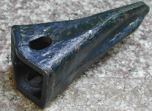

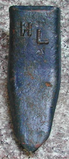

I am building a bucket and need teeth.where do i find them.and what is the best to use in rocky ground?

Here are the teeth and shanks that I made:
http://www.tractorbynet.com/forums/build-yourself/120888-bucket-dentistry-better-teeth-b.html
I remember making my 13" bkt for my CADDigger homebuilt hoe and the
carcass was 1/4" plate. Tough to bend in the arc I needed. Now I know
that it would have been easier and better to make the carcass of 1/8 or
3/16" steel and add wear strips to the edges and middle. Amazing what
you can bend with the right heat and persuasion.....

I just bought this tooth at a JD dealer. It goes on a 35-degree shank that
is 1.5" wide. I plan to use it on a single tooth ripper attachment for my
backhoe. This is my preferred "bluetooth".

There is a guy from California on e-scam that sells both the shanks and forged teeth pretty cheap. I got the ones like dfkrug's.
