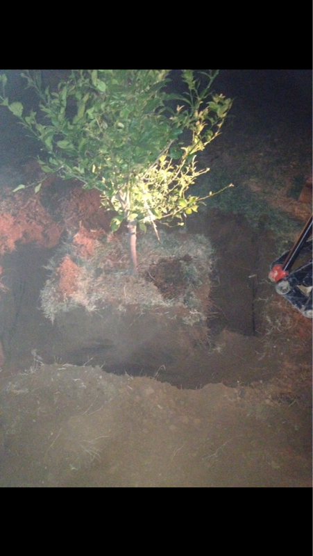

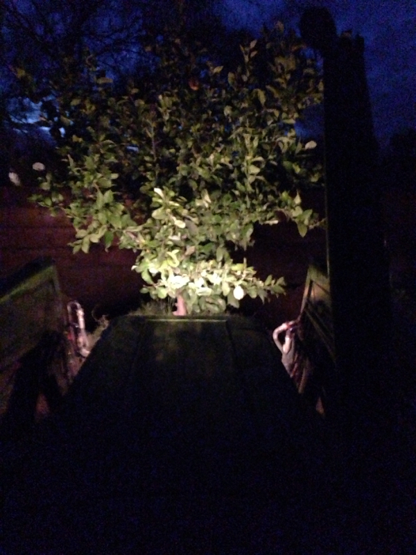

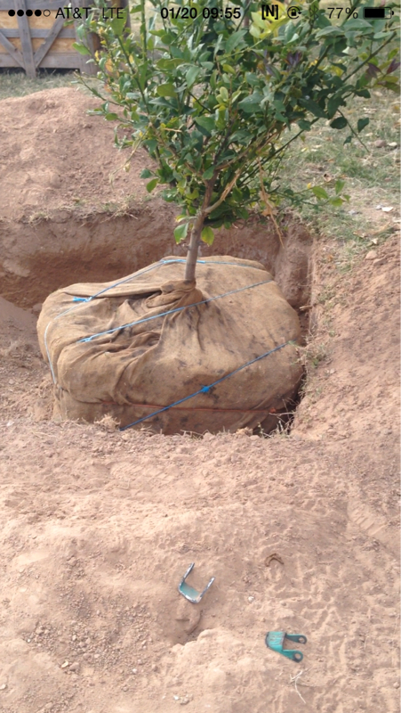

I used a backhoe to dig a 16' perimeter around a lemon tree, 3' deep.
Tied a cable around the base and pulled a cable through the bottom to cut whatever roots were there
Then wrapped in burlap
Lifted it out with the forks, all in one little root square.
Got over the tree spade idea pretty quickly.

/ Better than a tree spade #4
Not sure what you meant about the cable through the bottom.
After after he dug around the tree there will be dirt directly under the root ball. He pulled the loop of cable through this dirt, from the opposite side towards him, loosening the root ball from the ground.

/ Better than a tree spade #5
Didn't the whole thing kind of fall apart when you did that?
No it didn't. Maybe it was the soil, maybe the amount of roots, but i let it sit wrapped in burlap for a few weeks because i had to fix the tractor, watered it and it pretty much stayed intact. The bottom lost a little bit of dirt from the forks going under but for the most part, the tree didn't wither, looks happy and is still out of the ground! In a cube of dirt. Pretty happy about that. Plus, I dont have 3k for a spade or the time to make one. I have a dozen or so to relocate.

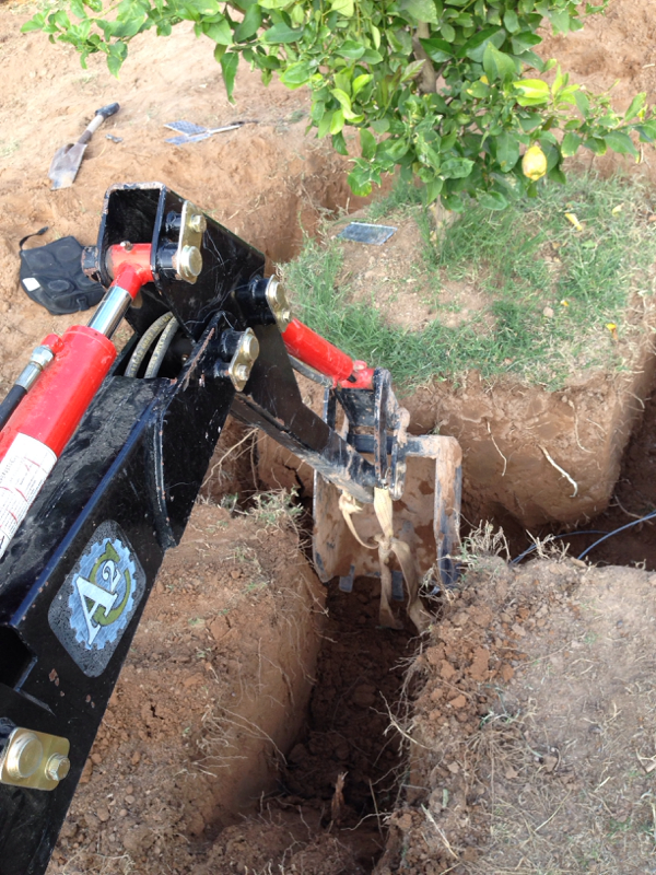

How thick was your cable? What type of soil do you have? Mine is a crap shoot, sandy in one place and clay in another and could be rocky anywhere.
It was a thin cable 1/4. Attached to the teeth of the hoe, at the base, a channel 3' was dug out from the square perimeter where the hoe could pull it through all while maintaining the depth.
Soil here is pretty not sandy at all. Pretty normal soil after 1' down..

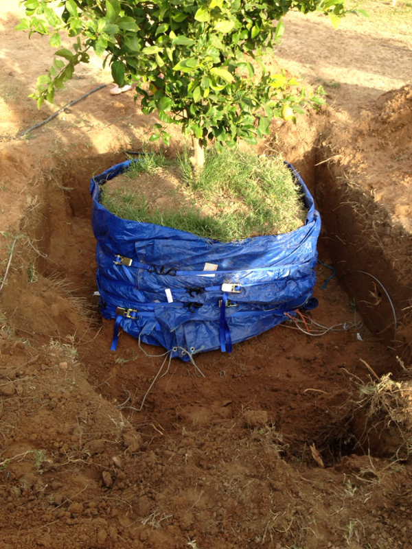

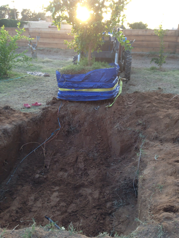

#9
Thought to post some better pics.
1- Digging the channel - how the bh pulls the cable under the slab
2- tie down tight
3 & 4 removal
5 - in the hole
Sliding into place is tricky. Have to make the destination hole bigger.

/ Better than a tree spade #10
That seems to work really well, thanks for the post and the pictures really help.
#11
Update: I omitted the cable cutting step, and the removal was just as good.
