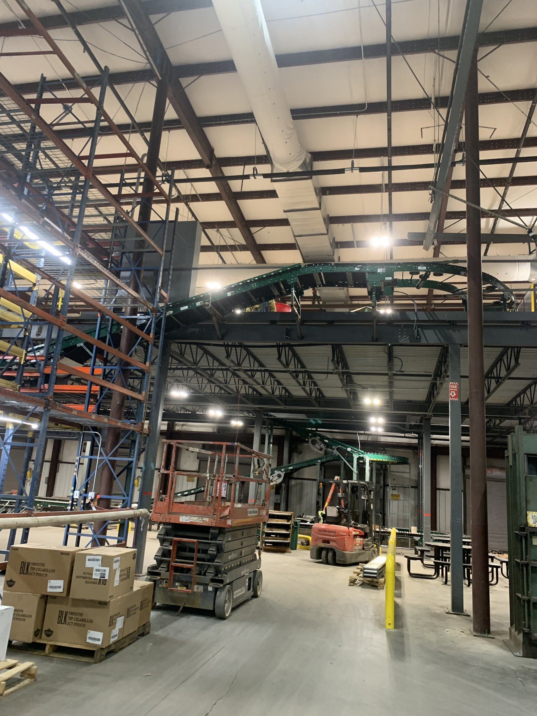

You might just be but only because nobody uses manual transmissions anymore. I was just down in Alabama again working on a three-story picker conveyor system and used the parking brake on a variety of forklifts only because they either incessantly beep at you if not set or fail to start if not set. On my own tractor, I don't ever "park" using the parking brake because the parking brake causes my brake switch to screw up but I do use the parking brake frequently to hold the machine in place and any air brake Payloader always gets the parking brake treatment.
