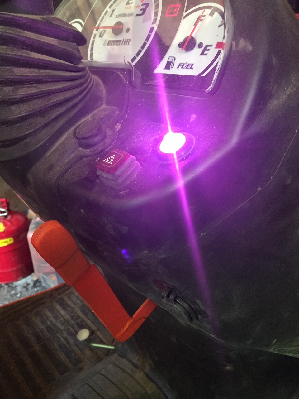

A better parking brake warning is needed. The MX52 will walk away with the parking brakes on without braking a sweat. :oops: :(:cautious: Happened twice now...
I'm thinking about adding a big flashing light. The tiny indicator in the cluster is nearly useless.
I'm wondering if anyone has made an improvement in this area.

Kubatuba is really lax in that. I added a red idiot light to both mine with a reed switch on the brake linkage.

I'm waiting for a bright LED light to arrive and I've got some micro switches. So I think I will rig something up along with extending the set and release lever. No need to touch your toes to work it. :) Would still be keen on some more ideas. I'll post whatever I do with this.
I actually added 2 reed switches in parallel because I have split brakes.
So you set up switches on the pedals, huh? So anytime the pedal is down the light is on. That would be easy enough - I was trying to think of a way to put the switch on the brake set rod. Are you using a solid light of a flashing light.
I saw a guy here who had a flashing LED when his electric SSQA was working.

If you have a brake light you have a switch.. Find that and hook into it, put any 12V light where you want it. I tried the buzzer and that well drive you nuts. I wired a 12V 2 pin flasher and put the light up where I would see it.
/ Better parking brake warning needed. #18
Early on my wife was sometimes leaving parking brake on the new B26. Easy to do unless you really set it hard. Fussed at her but I did it also.
Two modifications. First added a bar to engagement handle for better ergonomics and improved visual confirmation of brake setting. Also improves setting the brake more firmly. Second was brake “on” lamp. Trailer side marker lamp activated by motorcycle switch. Under the dash there was already a drilled bracket for the motorcycle rear brake switch. Only had to drill a small hole for the switch spring.
Now she reliably sets the brake when getting off and never leaves it on when operating. Both modifications solved the problem and have worked reliably for years and over 500hours. Less to fuss and worry about.

Good posts! I'm ordering the motorcycle brake light switch from Amazon $6 and change. I'll make an extension like Smokey did. I remember seeing that inspiration before. It's hard to press down and touch your toes Kubota, your ergonomics are for yoga masters :LOL:
