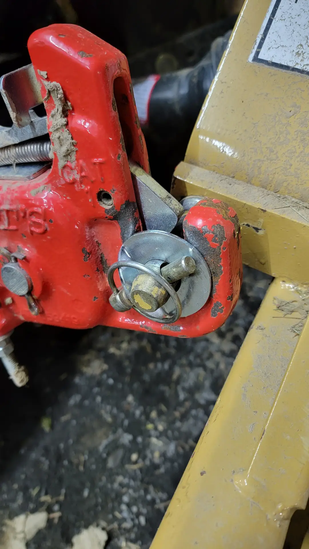

Is there anything more secure than this style of Lynch pin to the lower lift arms?
I keep losing them while brush hogging. I'm thinking about using a bolt and nyloc nut, but that would be a pain.
I buy the black lynch pins. They have a lot stronger lock ring. A little more expensive but well worth it. I get them at tractor supply.

I've got the 'regular' versions that get lost, and my high-$ finish mower had the so-called 'locking' style others linked, two of which have disappeared. The cure is a bolt with a 'nyloc' self-locking nut. Considering how seldom I *need* to remove a pin, and how often I have to replace them due to loss, bolts and nylocs are less time consuming. And cheaper.

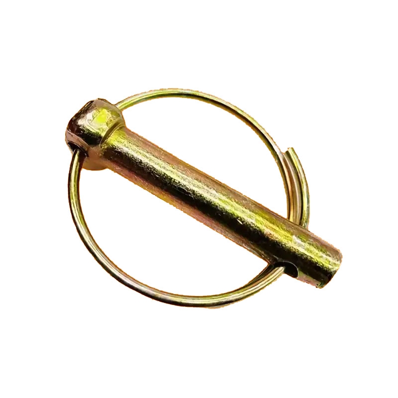

There IS...it's a locking type of Lynch pin. Sorry I don't have a photo. If you use "regular" Lynch pins, orient the pin so that the weeds/grass can't easily grab onto the loop when traveling forward. On that locking style, the loop part has to be squeezed before it can be rotated/released.

Perhaps in this specific situation, a pivot pin would be less likely to fall out? They come in all shapes and sizes.

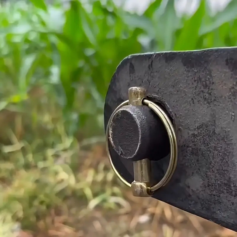

Lucky Dog, the one shown on your text are of poor quality. Bought them and thrown them away. They arr dangerous. Don't buy them, for security reasons. You can't find anymore those quality lynch pin any more. My old tractor still have some of them. They do the job. And, because I have to use the hydraulic bar to lowered my attachment , when I am loaded,,because of a down slope, some times these attachments scrape the soil which cause the lynch clip to pry open. The old ones don't open this way. We dhould be able to find the industrial type uses by machinery fabricant, on their new machineries sold, if that exist any more. Good luck.
