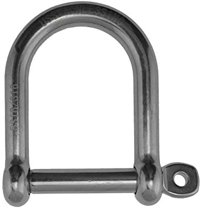

How about a shackle with a pin length and diameter to fit the end?
The pin in some are "captive" and can be tightened securely and alo be loosened fairlly easily.
