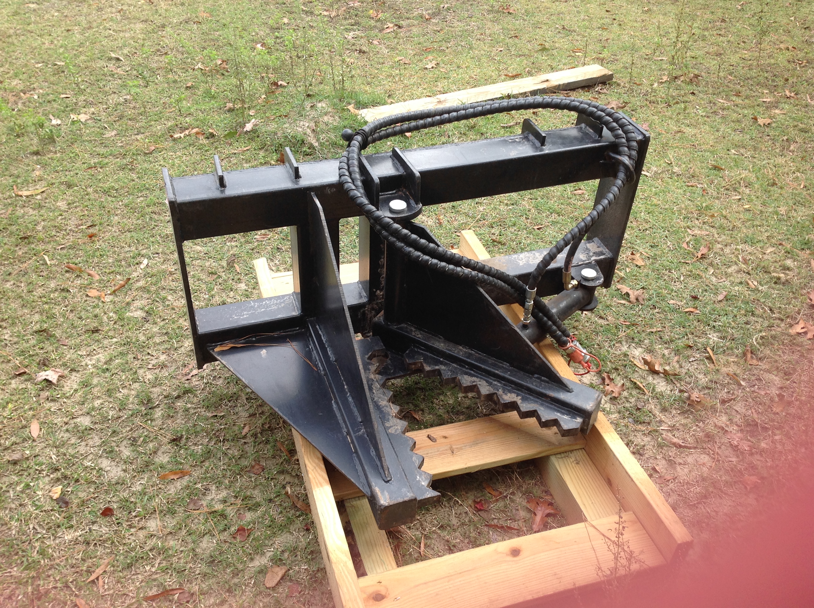

I use a post/tree puller mounted on my three point it pulls some pretty big stuff. I have 38 hp tractor with hydraulic top link. Most trees resist side movement but a straight up pull works very well, and the 3 point lift is much stronger than the FEL. IMG_0733.JPG

That is the ticket. I always had to get off the tractor to hook up the chain. The straight up lift with a little bit of pull moves a lot stuff.

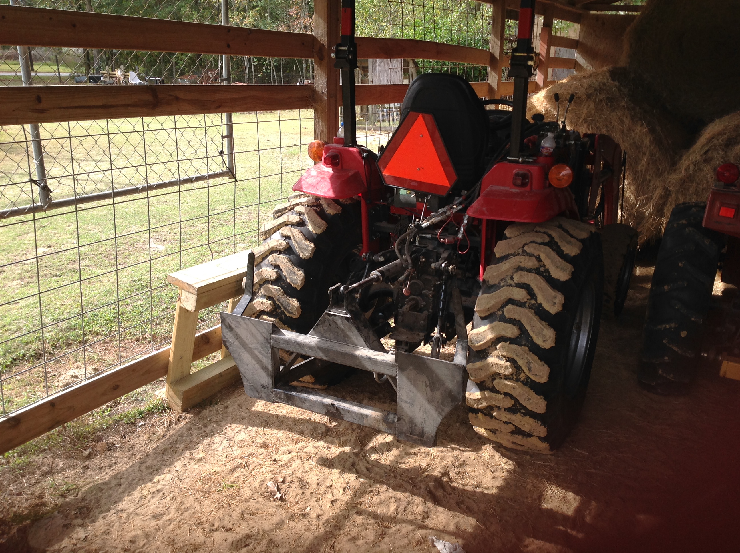

Please post pictures of it on the three point. I would like to see how you converted from SSQA. :thumbsup:

Do the jaws close all the way?
I'm looking to pull tons of jap barberry out

The jaws close all the way tight.IMG_0739.JPG I bought the adapter from titan attatchments also.
