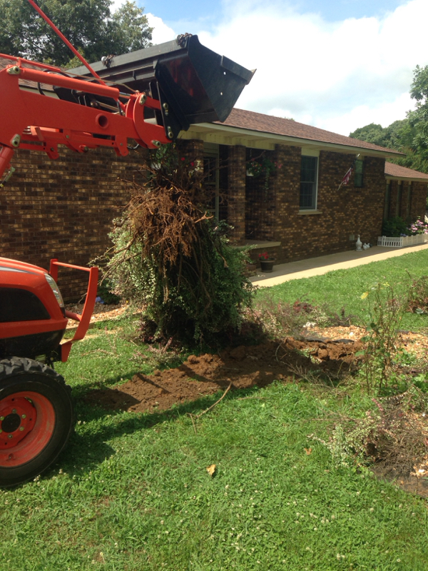

It really just depends on the shrubs and bushes and even soil types. If shallow rooted and lose soils some can be lifted out with the loader and others need to be pulled out using the draw bar. Deep rooted and heavy soils, can be made easier if soil is wet also. Just takes time to learn what' works best. I usually use a large chain, either wrapped a few times around the base, or use a choker type chain, harder the pull the tighter it gets, the one thing is to be very careful that what ever your using it doesn't slip off while under pressure.
