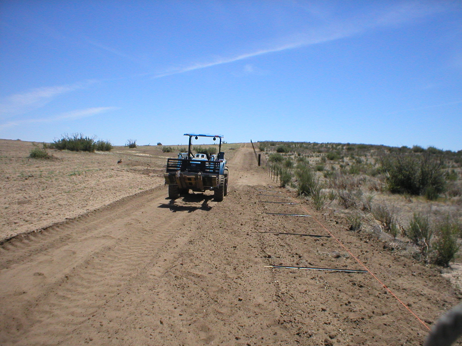

BigMccorm said:
I mean I wouldn't want to pound 5000 ft of fence posts by hand. would you?
66 posts a day, with range wire, straight, all within 1".:) Only 4700' more to go. 6000' total to complete, all posts driven by hand.

/ Best way to remove/reuse t-posts? #15
I guess you won't need to be going to the gym! I’ve set 120 in one day, but that was with a pneumatic t-post driver and a tow behind air compressor. The driver weighed 55 pounds so I was still pretty worn out. I have to pre-drill with a rock drill for most of my t-post. Looks like you have sandy soil to work with. Still, 66 a day is impressive.
/ Best way to remove/reuse t-posts? #16
The 66 posts are no problem, if that was all I was going to do. But to stretch and install the range fencing makes for long days. No rock for me, either topsoil or decomposed granite.:)
To actually have to drill for each post:eek:, now that is a lot of hard work no matter how you do it.
