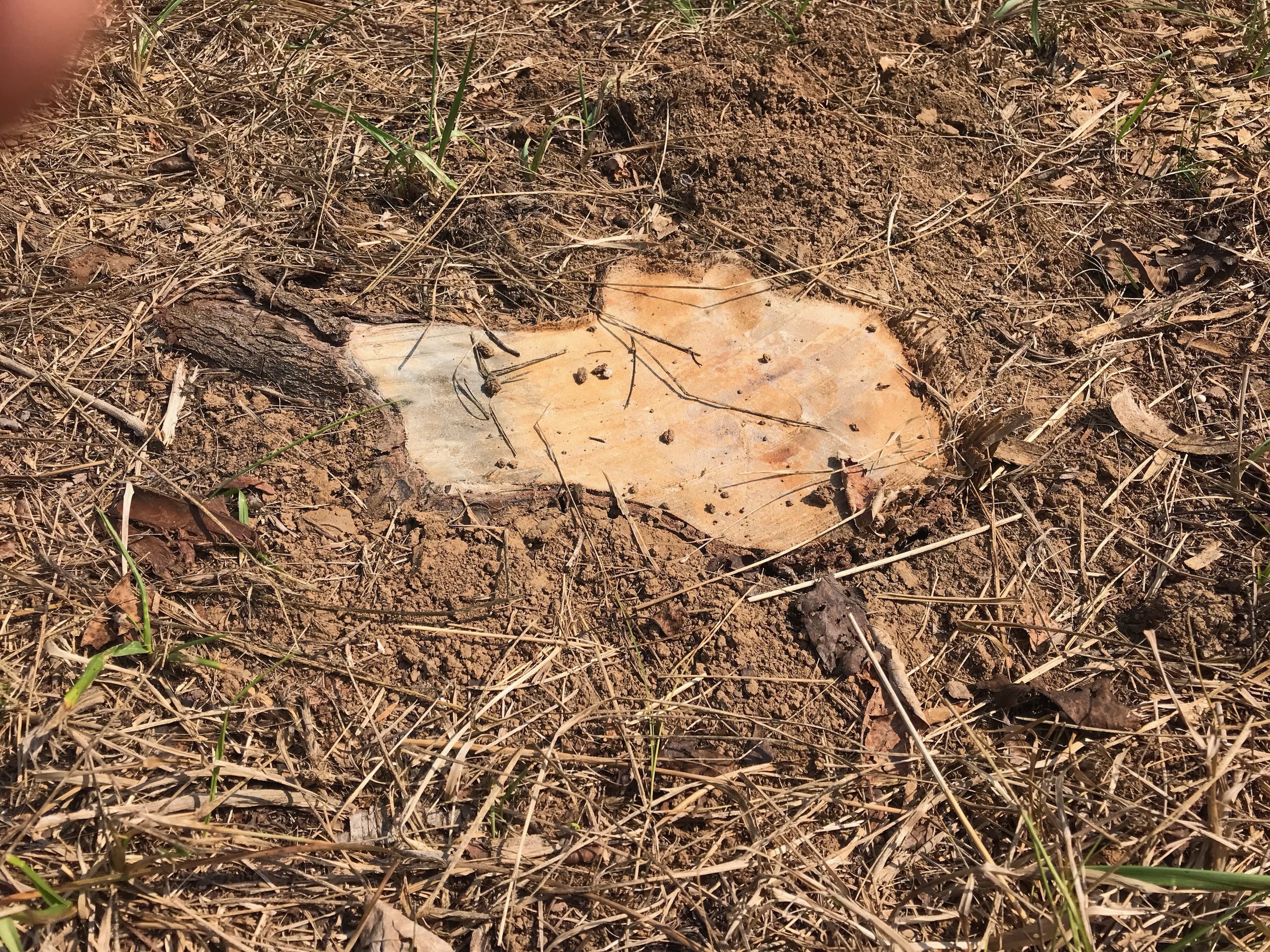

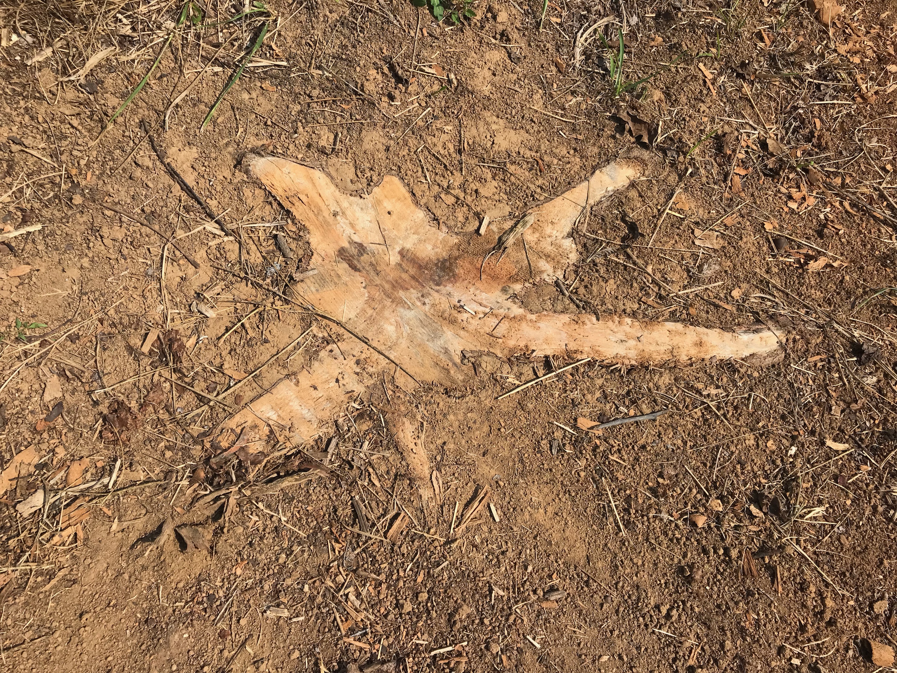

Ed27, Can you take a couple pictures of the 'stump' left behind after cutting the tree, or after re-cutting it lower (if you are)? How does it feel when you drive over them with your tractor afterwards?

When I'm out there this weekend I'll try to remember to get a picture. If you walked on the cut stumps with your eyes closed you would not know it. The stumps are literally at or slightly below ground level. The saw blade is resting on the dirt when it is cutting the tree.
