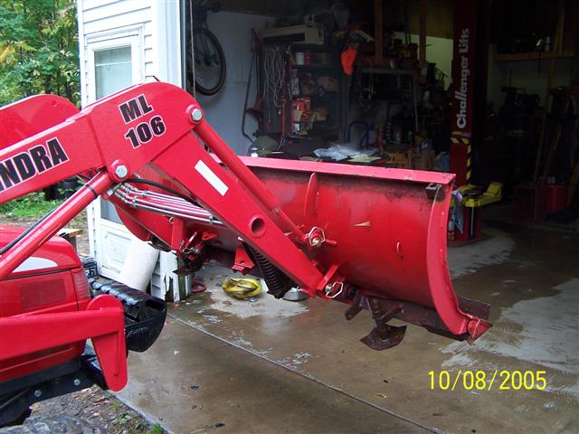

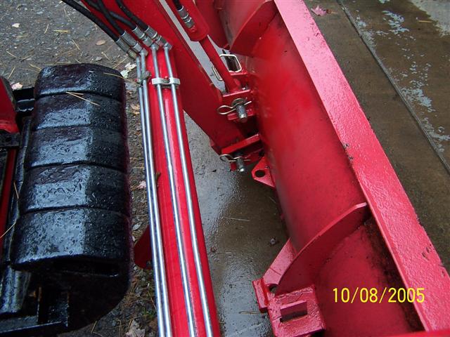

I took out my 4 bucket mounting pins w/ E-clips and replaced them w/ 1" dia. hitch pins from TSC for quick change. I got an old 7' truck plow blade and shaped and welded c-channel to the back of the blade to line up with the loader arms. Pull 4 pins to remove the bucket then mount the 7' blade with the 4 pins and go. Takes me about 10 min. to changover. Also welded skid plates or shoes to the blade bottom and by rolling / curling back the plow I can have the cutting edge anywhere from on the ground to up about an inch or two. I plowed about a half dozen driveways last year by straightblading like the guys that plow big parking lots do. Was much faster than using the back blade.

Re: Your question #4. I have just added a few photos in the Mahindra section of my 4 pin change over from bucket to plow blade.
George

When I take my bucket off and put on the blade I can then push a path 90" wide instead of the buckets 60" width. Plus I don't have to lift and dump a bucket load of snow each pass. I originally attached the plow blade to the bucket but at the end of the pass the bucket was full of snow that came over the top of the blade thus requiring me to try and dump out the snow from the bucket with a 90" blade in front of it. Since my bucket mounts to the arms with 4 pins it was simple to replace them with 1" hitch pins and weld brackets on the plow blade. Hope this explains your question.
George
