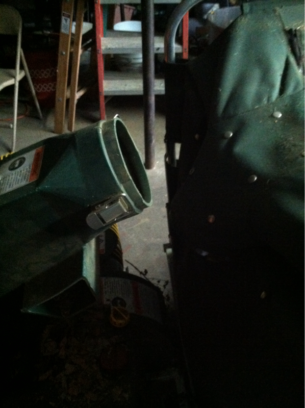

/ Best Tow Behind Leaf Collection? #3
I have a cyclone rake that I don't like. I can't knock it too hard though. We suck several hundred loads of leafs a year and it has lasted over 10 years. The motor on it is a pile of crap. It leaks oil terrible, and the starting pull cord kicks back nearly breaking your hand.
/ Best Tow Behind Leaf Collection? #4
I have a Cyclone Rake also. It's a quality piece of equipment. I think the DR, trac-vac and others are OK, but the CR is a step above. The new ones have the latest B&S engines which, in general, are highly thought of. The solid mount (rather than trailer hitch) has pluses and minuses. Doesn't really matter to me since I can back a trailer. What I like best is the fold up design which allows it to hang on the wall and take up very little storage space.

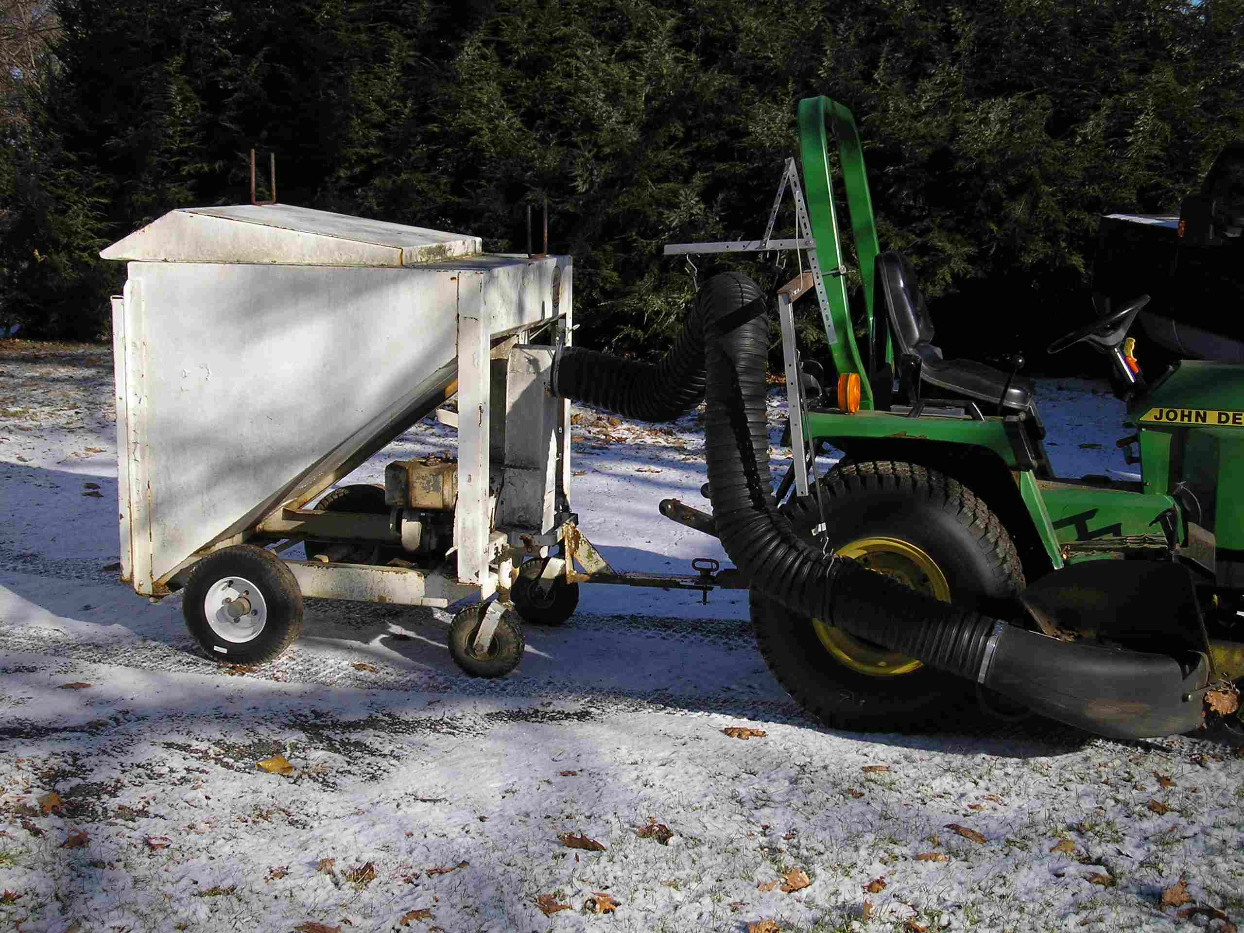

/ Best Tow Behind Leaf Collection? #9
I have both a self dumping Giant Vac and the new (purchased last fall) DR vac. Both empty themselves very well. The only time I ever had to dig leaves out was when I left the Giant Vac full for a week before emptying. I consider the emptying effort equal between the two. There's more separate actions on the DR, but the Giant Vac requires more strength to lift the heavy steel door and relatch it. Pic of Giant Vac attached.

/ Best Tow Behind Leaf Collection? #10
With the Cyclone Rake, you have to get off the tractor to raise the bed, but it tilts to 45 deg and then you can just drive off as it dumps.
Would part of that activity include disconnecting and then reconnecting the discharge hose from the vac blower to the bed/hopper ?
Do you also have then undump the bed and refasten/secure it ?

/ Best Tow Behind Leaf Collection? #13
yankee,
That's kinda the design I'm talking about ... with one exception:
Yours appears to be an older Giant-Vac ... on the newer ones the door was mounted on a pair of spring-loaded arms, kind of on an eccentric.
The eccentric held the door in place against the hopper (no "latching" required), but allowed it to be pulled out and up. A similar mechanism is used on fold-up garage doors ... although the only place I can recall seeing that specific type of garage door was in California.
I would think that the action of that type of mechanism would be quite amenable to be operated by a hydraulic cylinder.
In that case, one wouldn't even have to leave the seat ... other than to refuel the vac motor :D

/ Best Tow Behind Leaf Collection? #15
... see what I'm gettin' at ?
I guess it all depends on how much automation you think you need. Yes there are two quick release latches to disconnect the chute. And yes, you have to manually lower the bed and reconnect after dumping. However, I haven't had to manually rake more than the last 10% of the leaves out of the bed, and I only to that on the last load of the day when I want it really empty. I'm trying to imagine a rig that dumps the bed while keeping all the hoses and chutes connected and it seems like that would be a really big machine.
