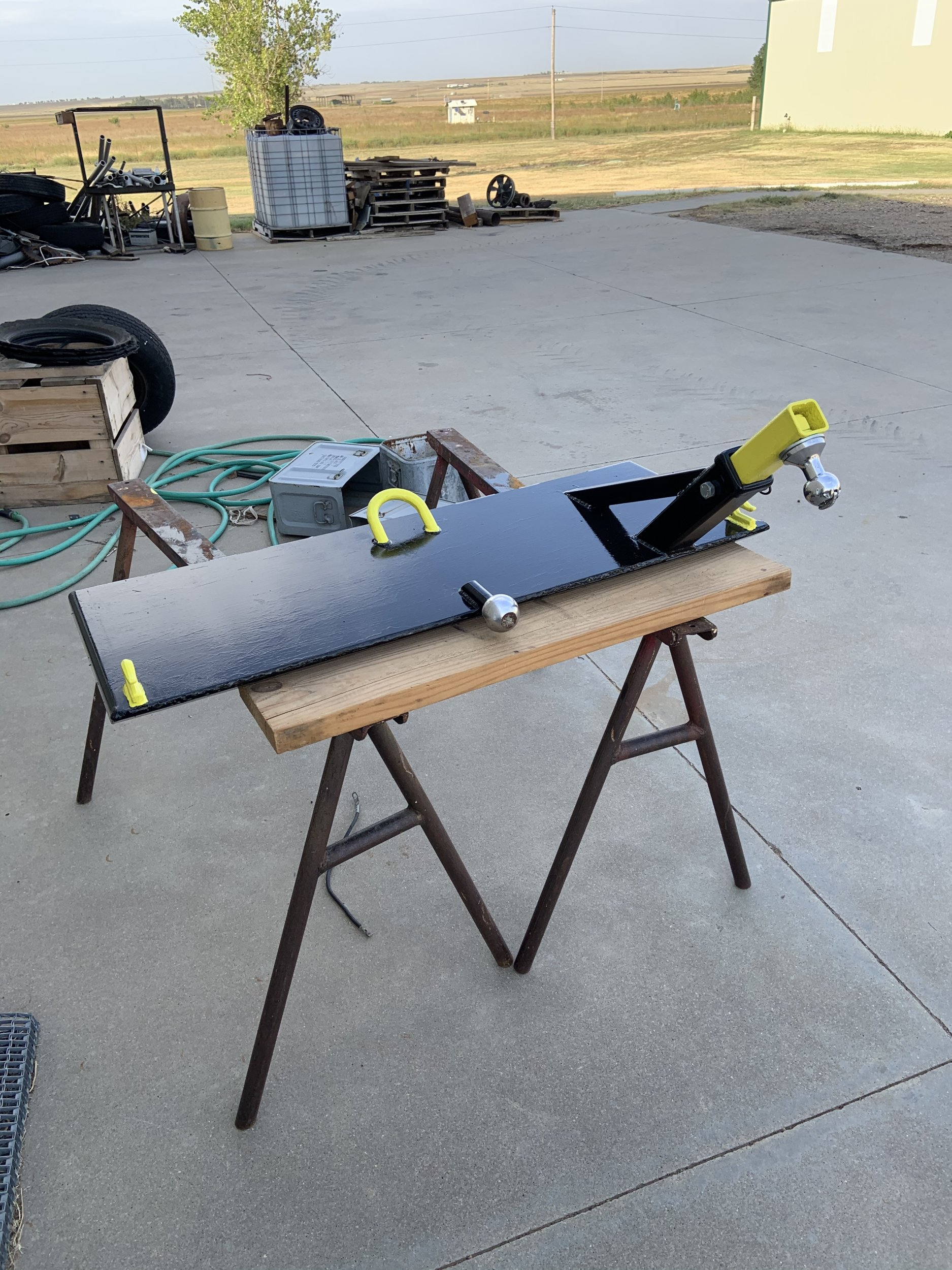

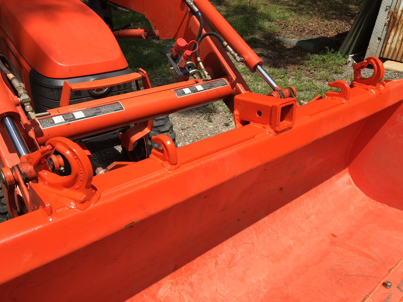

Weld a 2in reciever right on the cross bar between the latch boxes.
A $7 part with some welding needed.

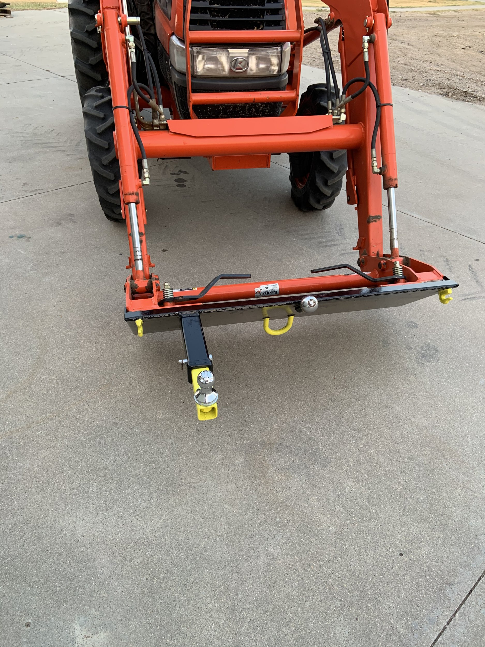

I just welded a hitch receiver tube on the center of my bucket. Then made a lowering bracket out of a piece of channel with a ball on it. Also have a fixed hook and an extended arm with a chain if I have to get up inside something to chain up and pull out.

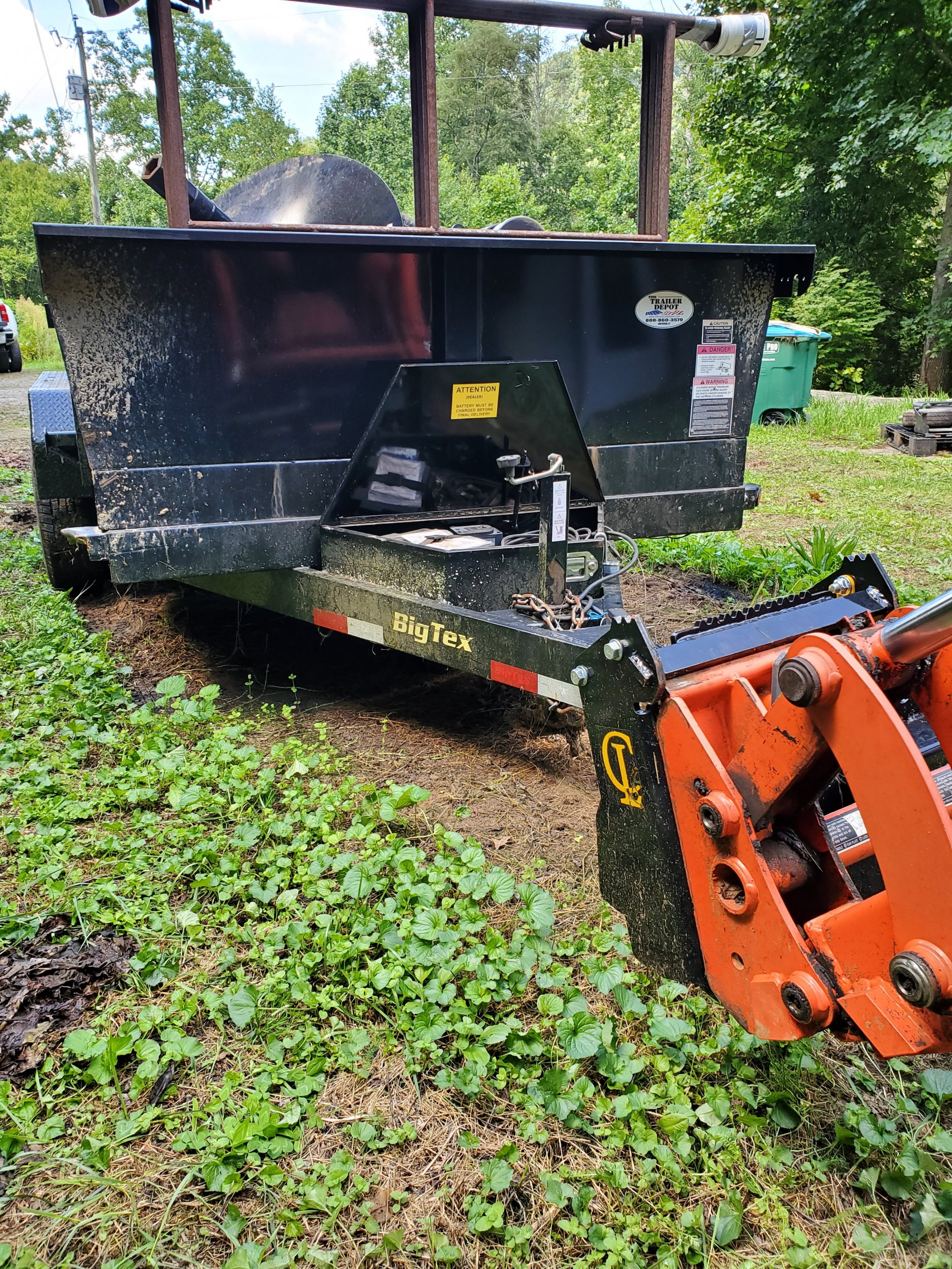

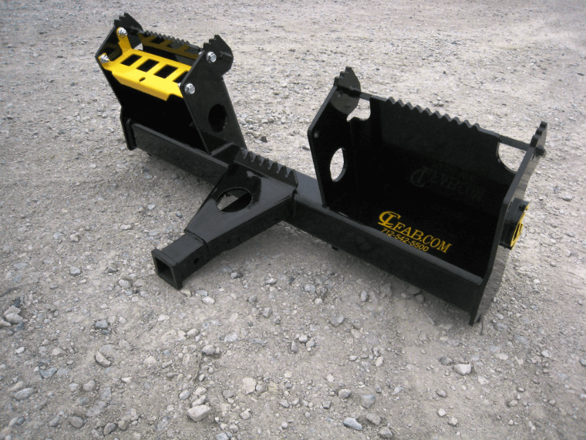

I have been using the CL Fab SSQA quick hitch for last 3-4 years to move trailers, including partially loaded at approx 6-7K Lbs, around the work space. Also has storage for different sized balls.

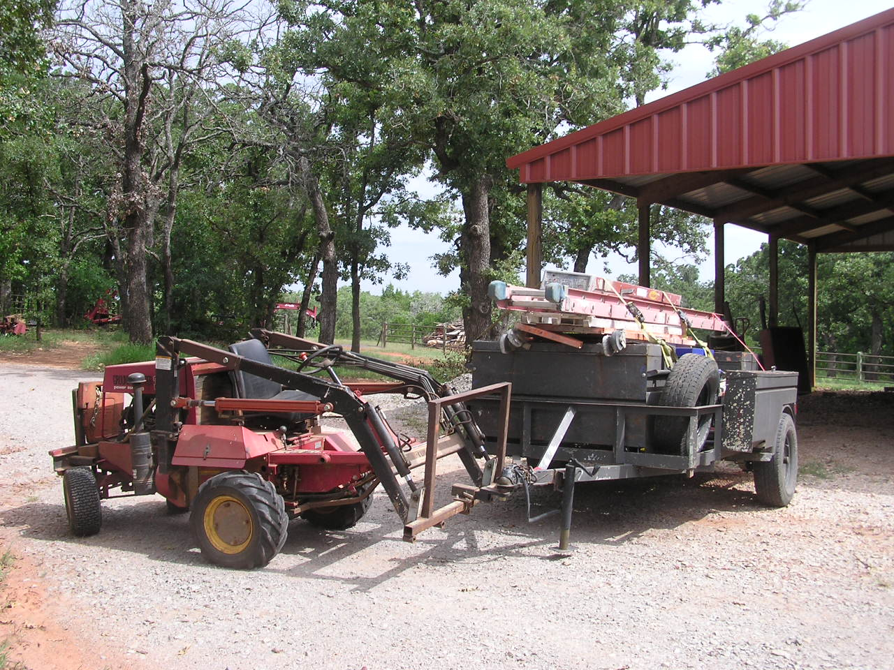

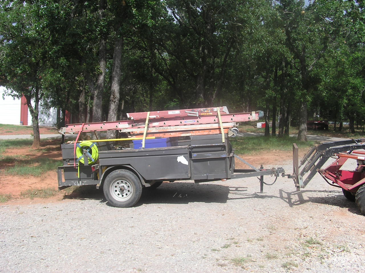

/ Best SSQA trailer mover attachment? #8
One I built, you can see what you are doing very well. The only thing I am going to change is put a small dozer blade on the bottom.

Simply welding a 2" receiver on the top edge of the bucket is making more and more cents to me...
/ Best SSQA trailer mover attachment? #11
Except if your trailer tongue is lower than the top of your bucket..
Yep. But a person can take the same ingenuity and make a drop for the ball, provide the OP welds.

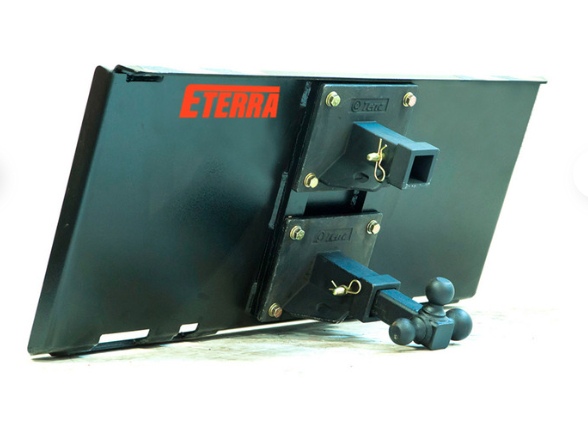

I am looking at the Titan receiver mount plate attachment v2, I have a Kioti CK3510 HST, I want to be able to move around my Jayco 26 foot RV. Trailer weighs around 5,000 lbs, would this receiver plate and my tractor be able to accomplish this task?

I did the 2" receiver tube welded to the center of the bucket like most folks do. You can buy a drop receiver if it's high for you hitch, or make your own custom length drop bar with some 2" box tube and a few minutes of welding. They make hooks, solid rings, winches, all kinds of fun stuff your can attach to a 2" receiver tube. And it's stupid cheap; maybe $6-$10 for the tube and few minutes to weld it on. Cheap-Simple-Effective. My fav!
