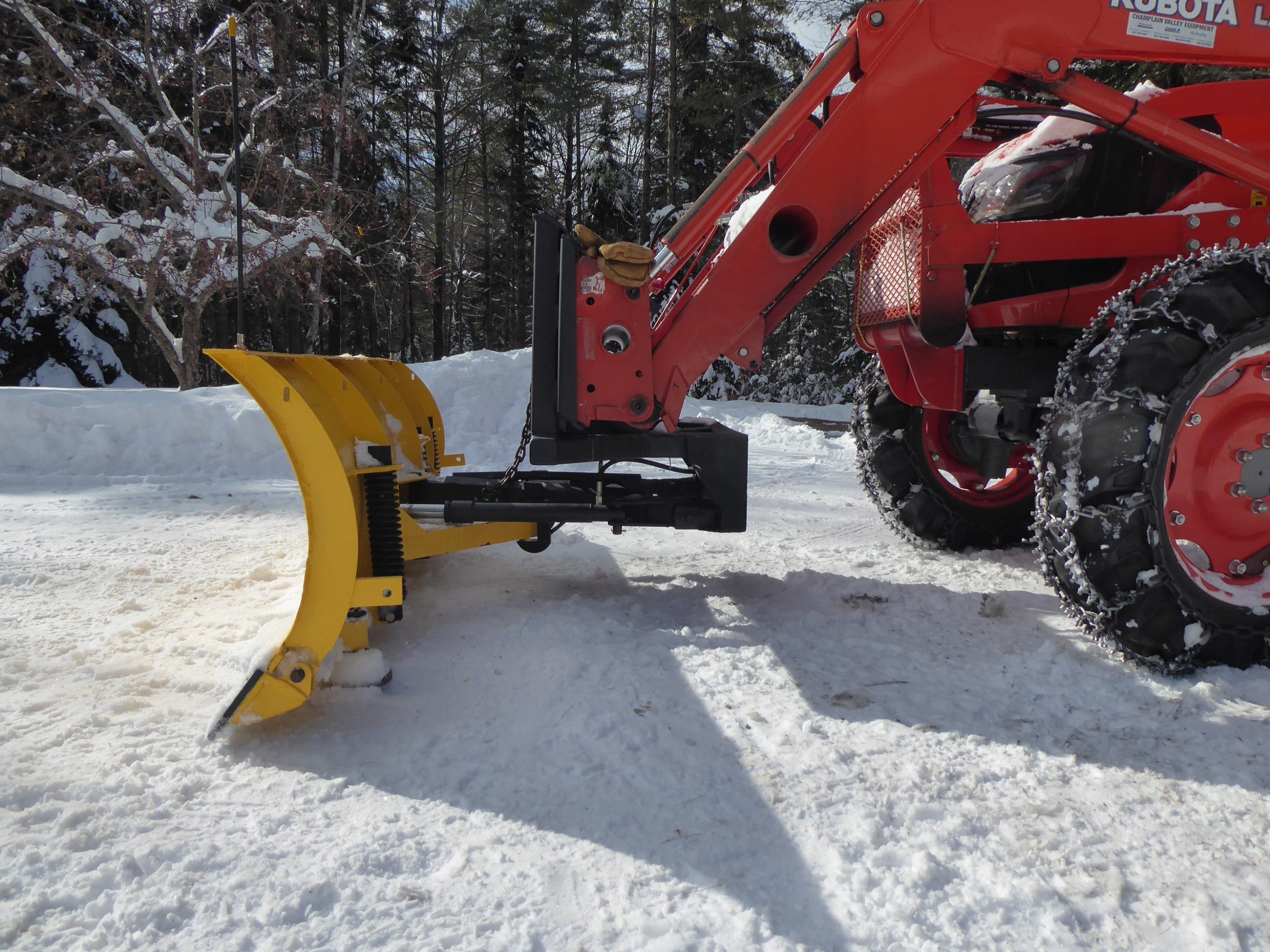

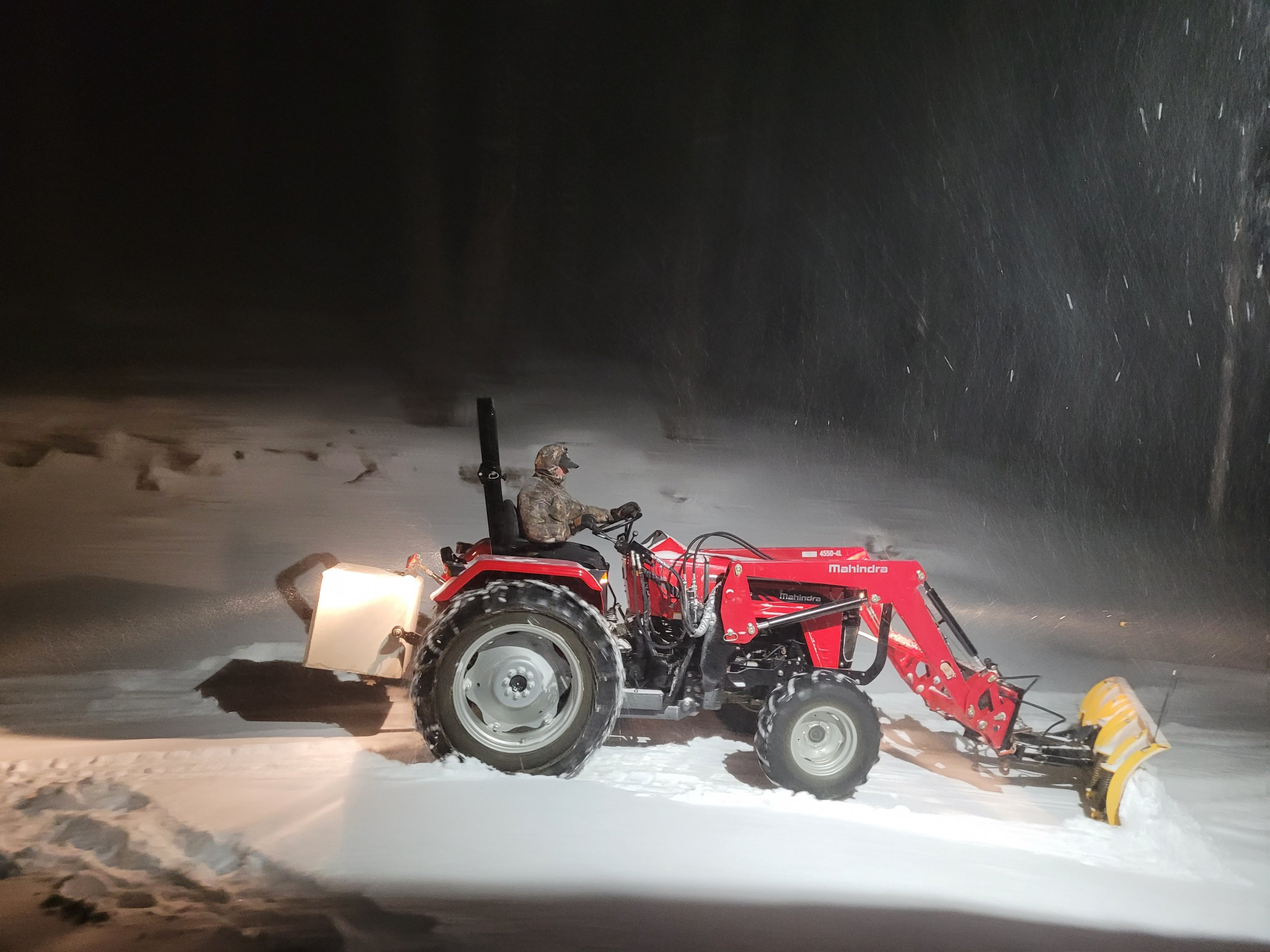

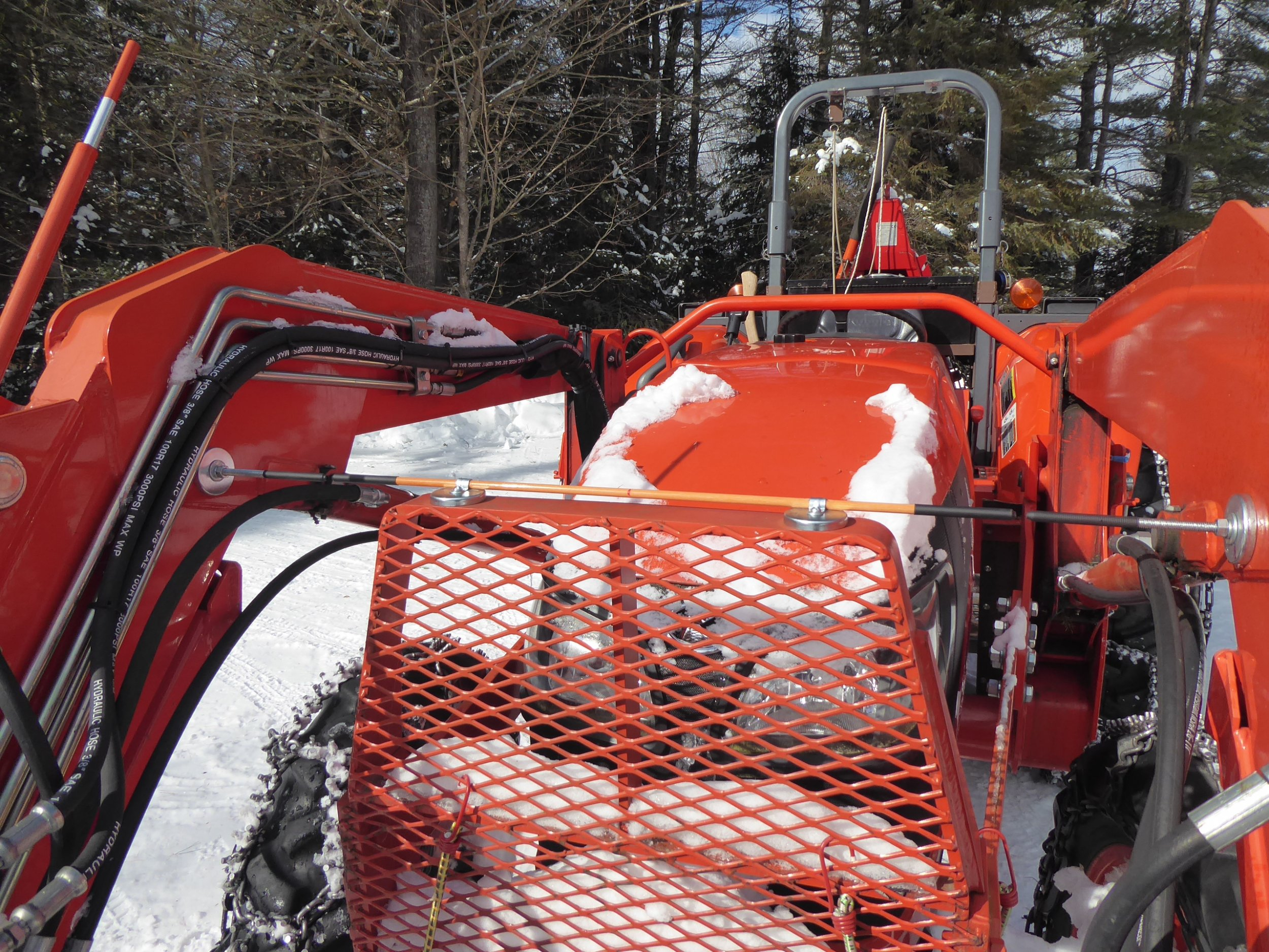

A few pics of my snow plow setup. It's pretty simple, an 8' Fisher straight blade (pickup truck plow) attached to a Titan SSQA-to-3PH conversion plate. I installed Cat 1 pins in the plows' a-frame where it previously attached to the headgear, then attached the lift chain to the top link attachment point. W.R. Long 3rd Function valve powers the angle cylinders.
To use it I'll leave the loader arms at a set height and use the curl function to raise/lower the blade, being sure to leave slack in the chain when the blade is lowered, allowing it to float independently of the FEL.

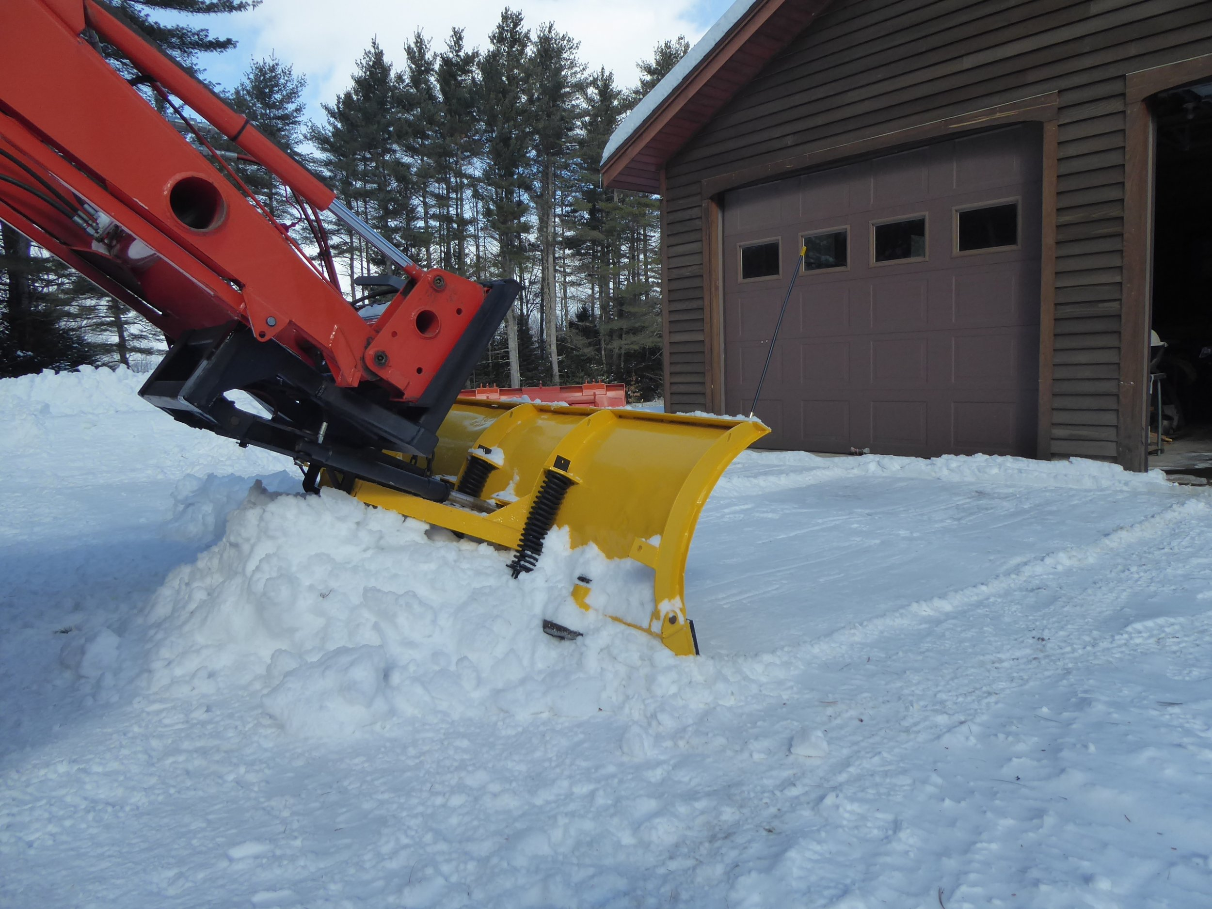

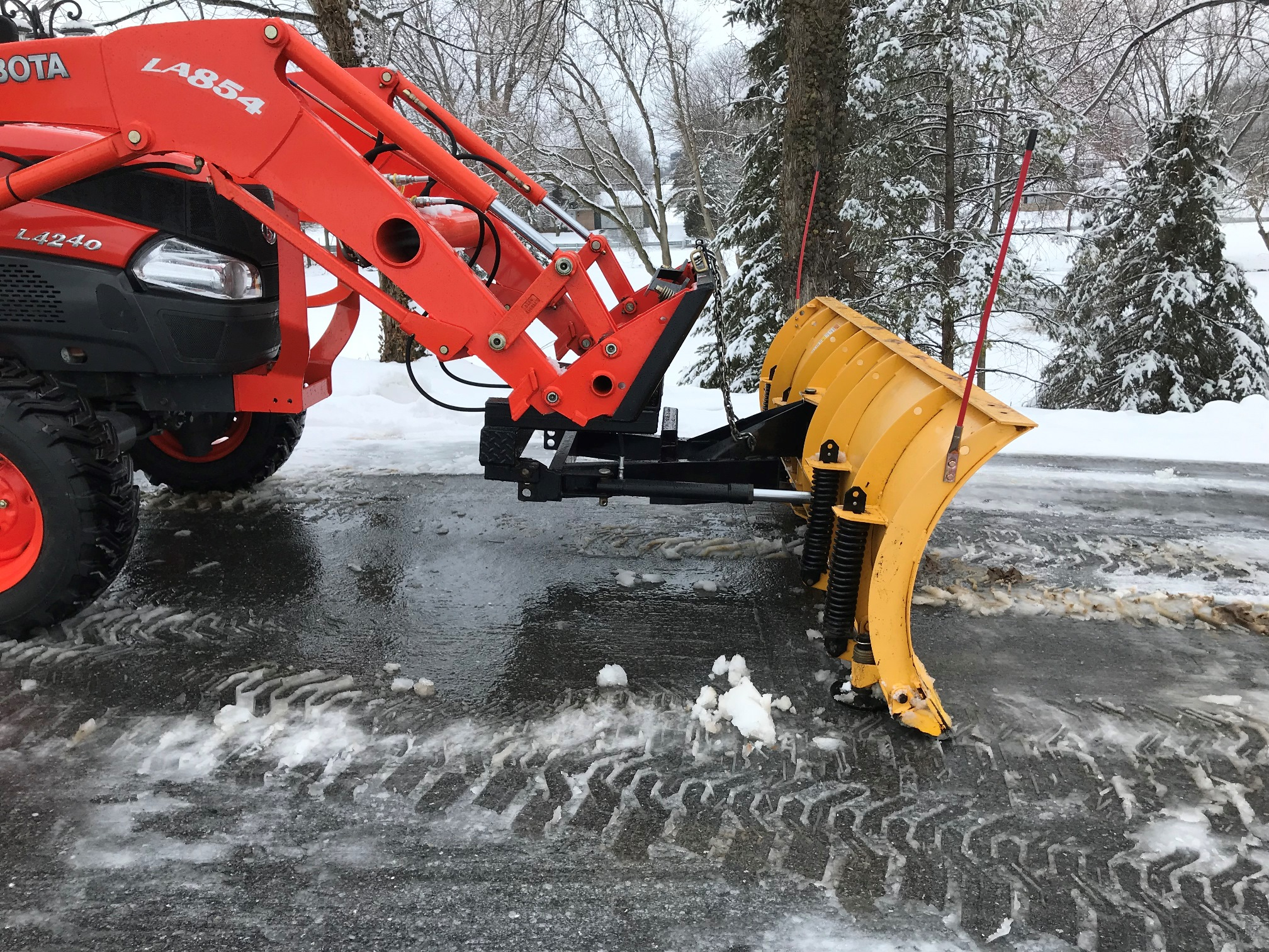

Walt, same plow but different mount. Used Gordon's "underslung" approach and the factory 3rd function lines on trhe loader turn it.

The two benefits of the underslung mount are:
1. The plow doesn't act like a rudder when angled. The only time it pushes the Kubota sideways is when it hits an immovable pile.
2. It reduces the overall length of the setup by feet.
   / Best Snowplow for Tractor? #35
3. Floats like a truck plow but you can get down pressure when you want it by dumping the SSQA plate.

Thankyou Walt - but I can't take any credit for the idea. The plow is just my rendition of the idea that I saw posted here on TBN by TractoNH. It is a little more complicated to build though. And while operating it is best to have a way to set/check your plow frame for flatness or level with the road surface from the seat. Like any plow if the plow frame is not flat the corners of the cutting edge will dig in when you angle. I use my bucket level indicator to set the SSQA plate angle and a FEL height indicator stuck on with magnets, Chims genius idea, to set the frame height. I need these because I do a lot of stacking snow and need to be able to get set level again before plowing an other stretch.

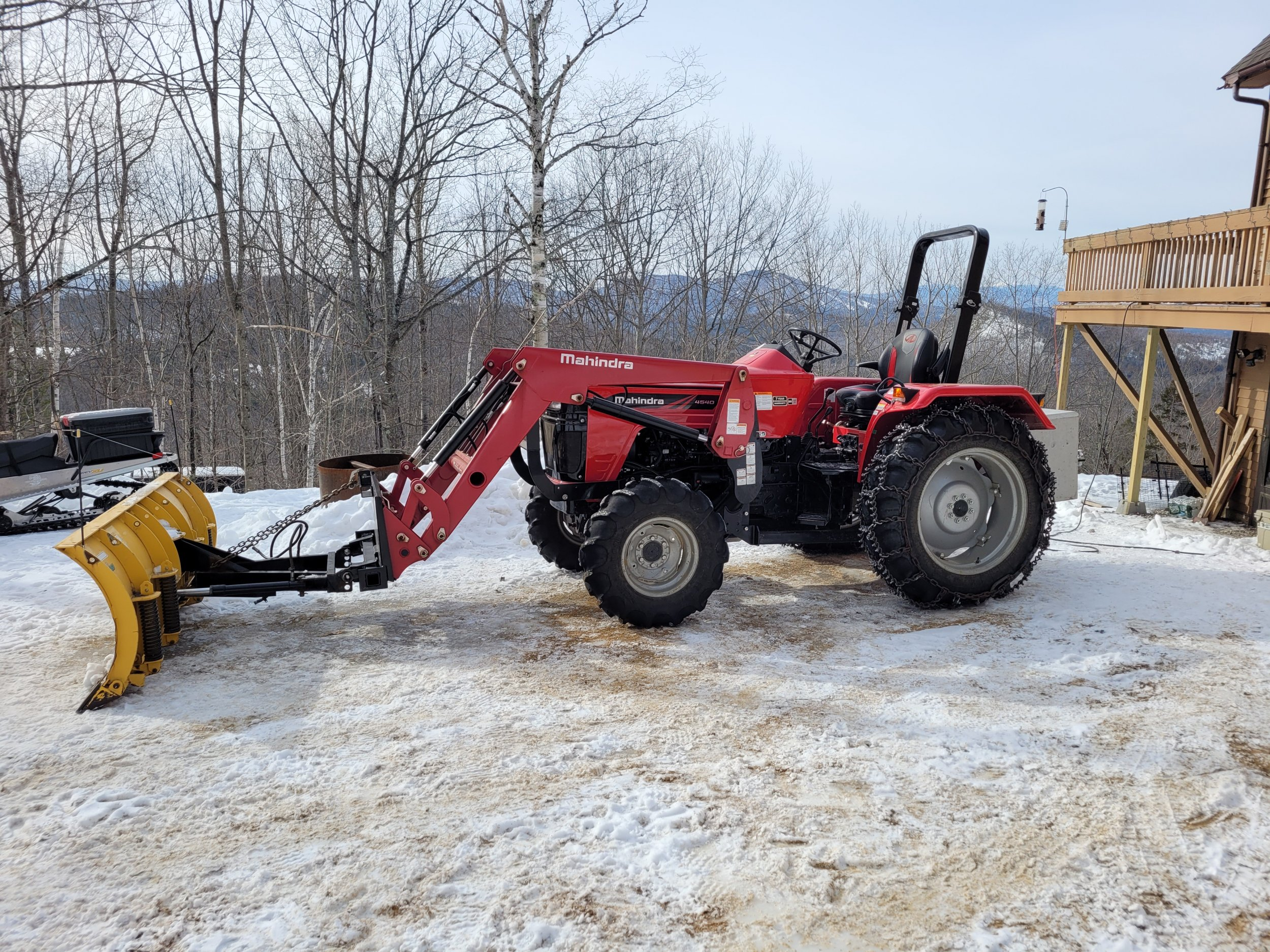

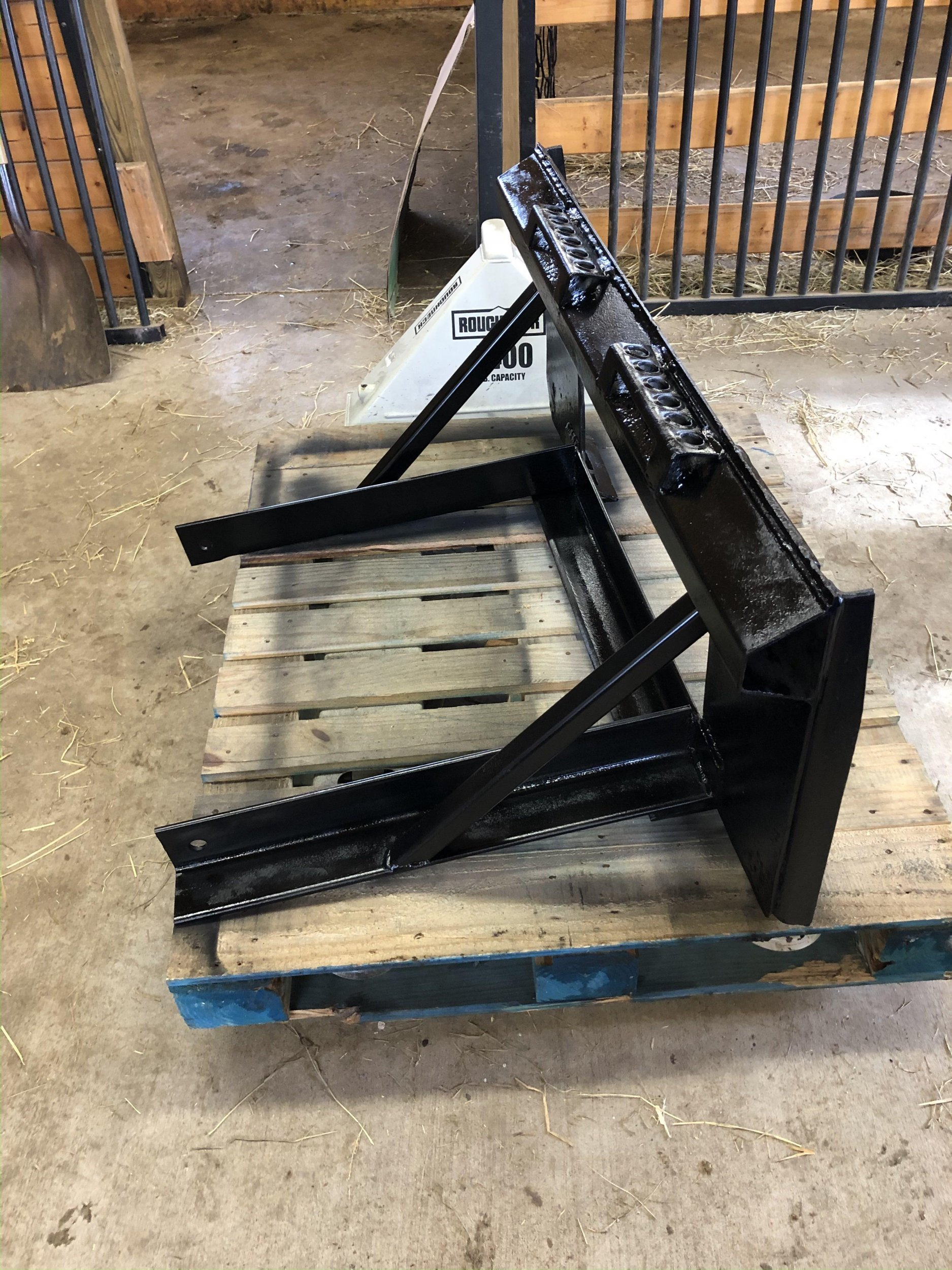

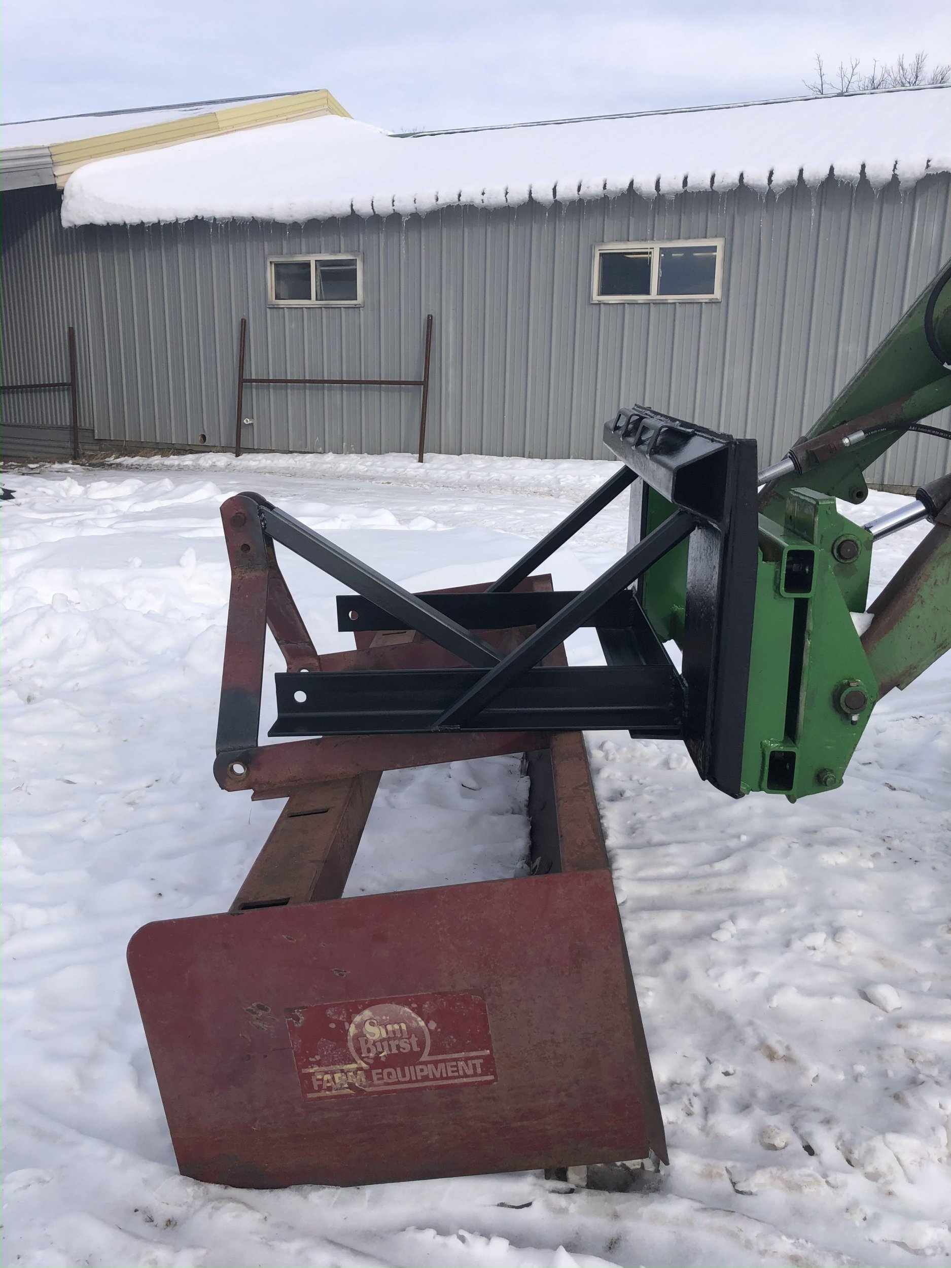

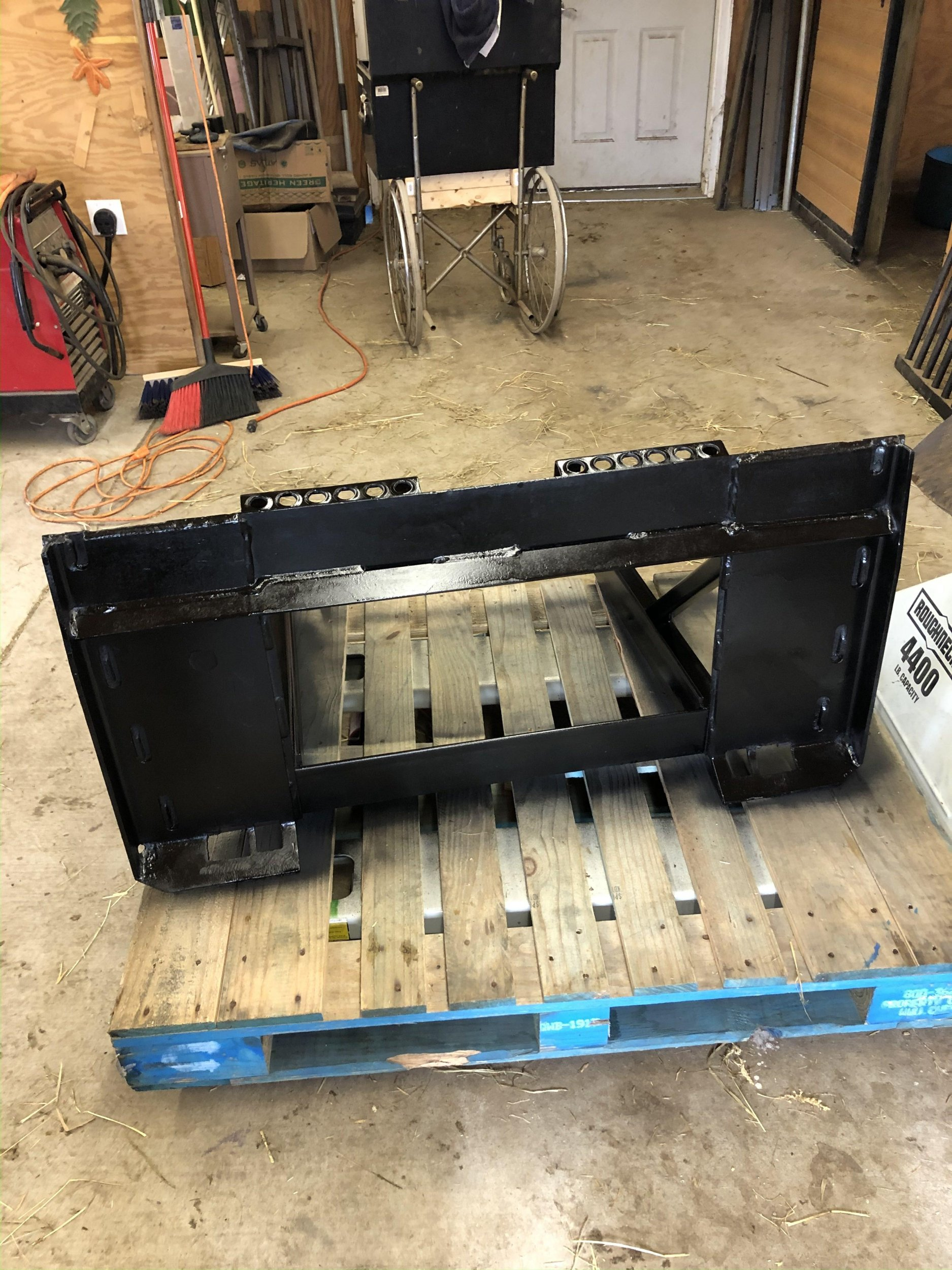

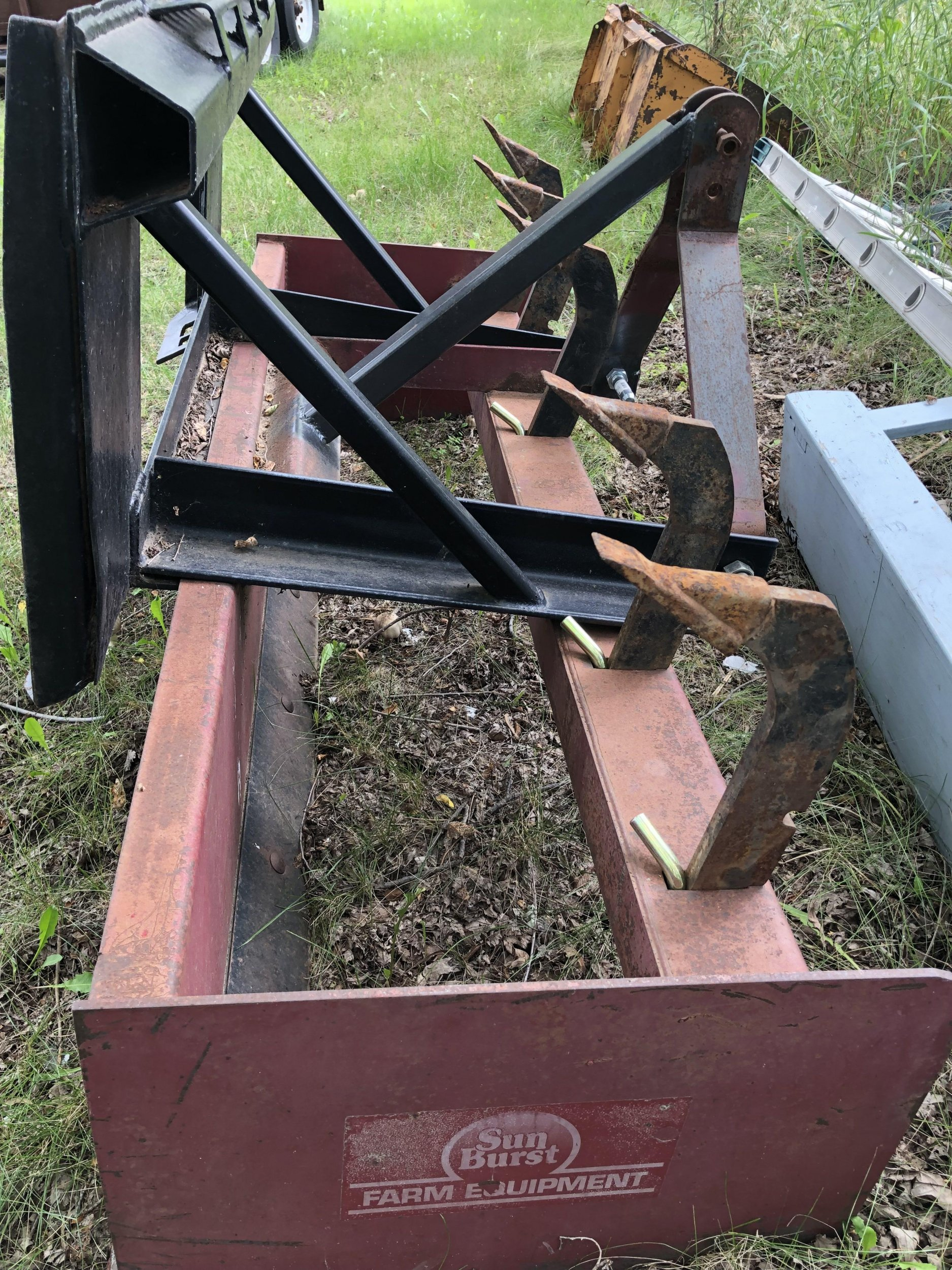

I have an older tractor and loader with a limited budget. I'm big into DIY for obvious reasons. I modified a box blade to fit my quick tatch modified 47 loader. The back blade offered unexpected benefits that I mostly appreciated after I started using it. In float it is less agressive when it's tipped back on the rear cutting edge and more agressive (on ice and hard packed snow) when tipped forward on the front cutting edge. In a worst case situation I can use the scarifier teeth to tear up the really serious ice buildups (with obvious cautions and limits). Beats the snot out of the buckets and the snow blower I actually quit using in favor of this. It's drawback was the width (5'6 on a tractor that is just over 6') but with chains on the tractor it never really was all that problematic. The teeth are especially effective when the piles need to be moved/pushed somewhere else. I am currently running a JD 444J wheel loader for a landscaping firm, and sometimes I wish had a slightly heavier equivalent on it when I'm moving old piles that are impeding traffic flows.
I designed the conversion mount to be easily removed by pulling the two lower arm pins so if needed I could put it back on the 3 point. I'm looking at finding a wider one at some future time and if my design is as versatle as I think, I can put the larger blade on the frame and not have to refabricate anything.
