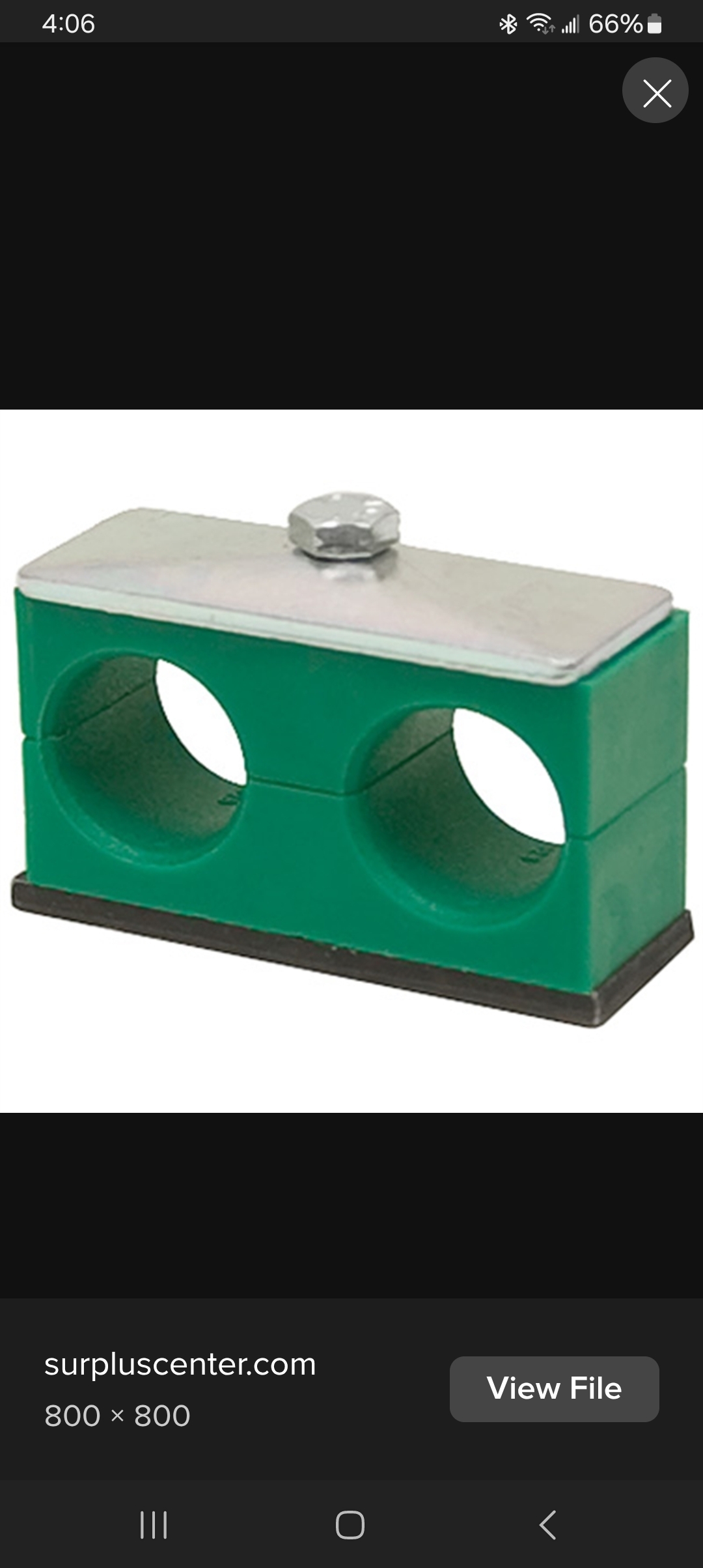

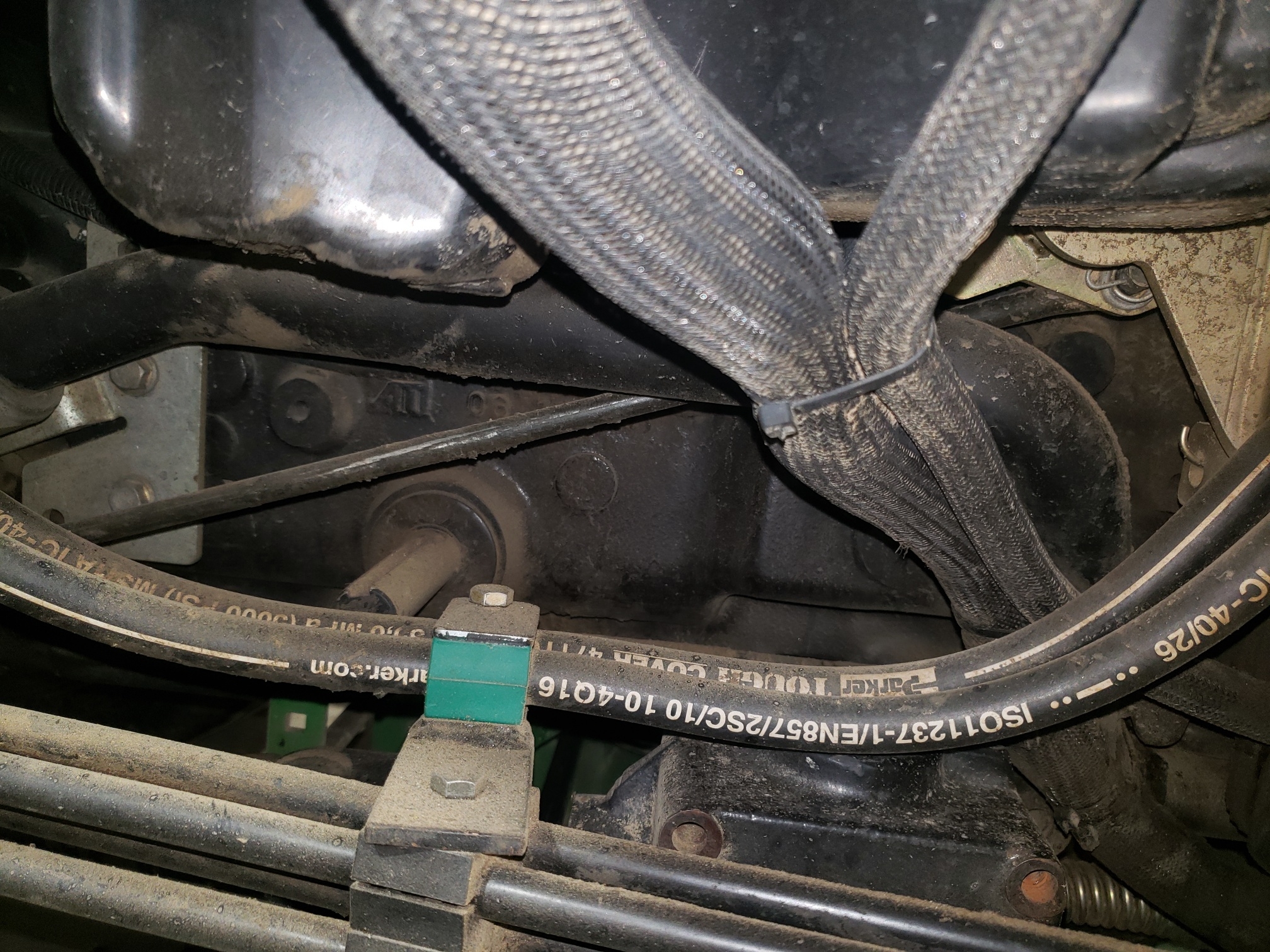

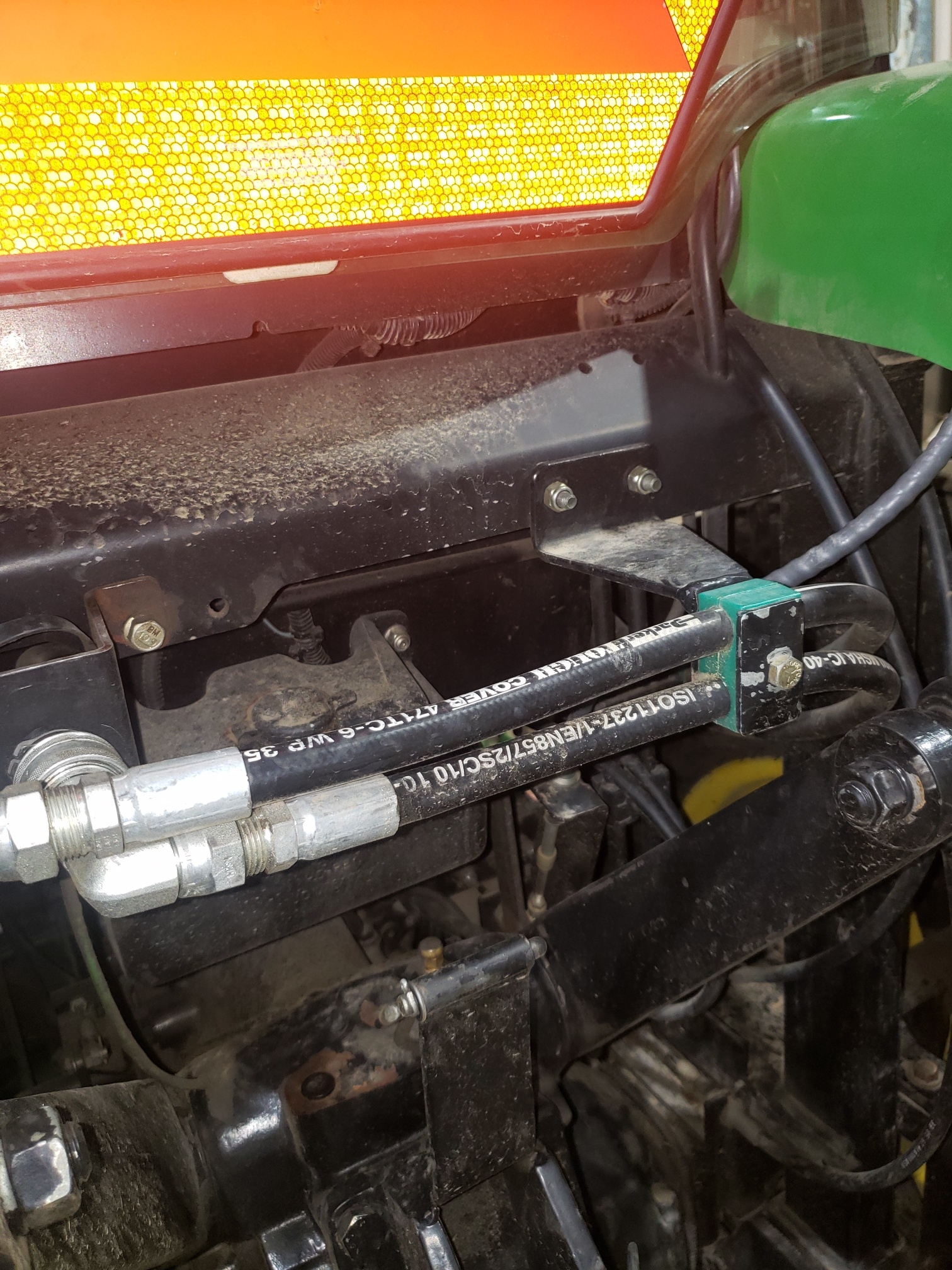

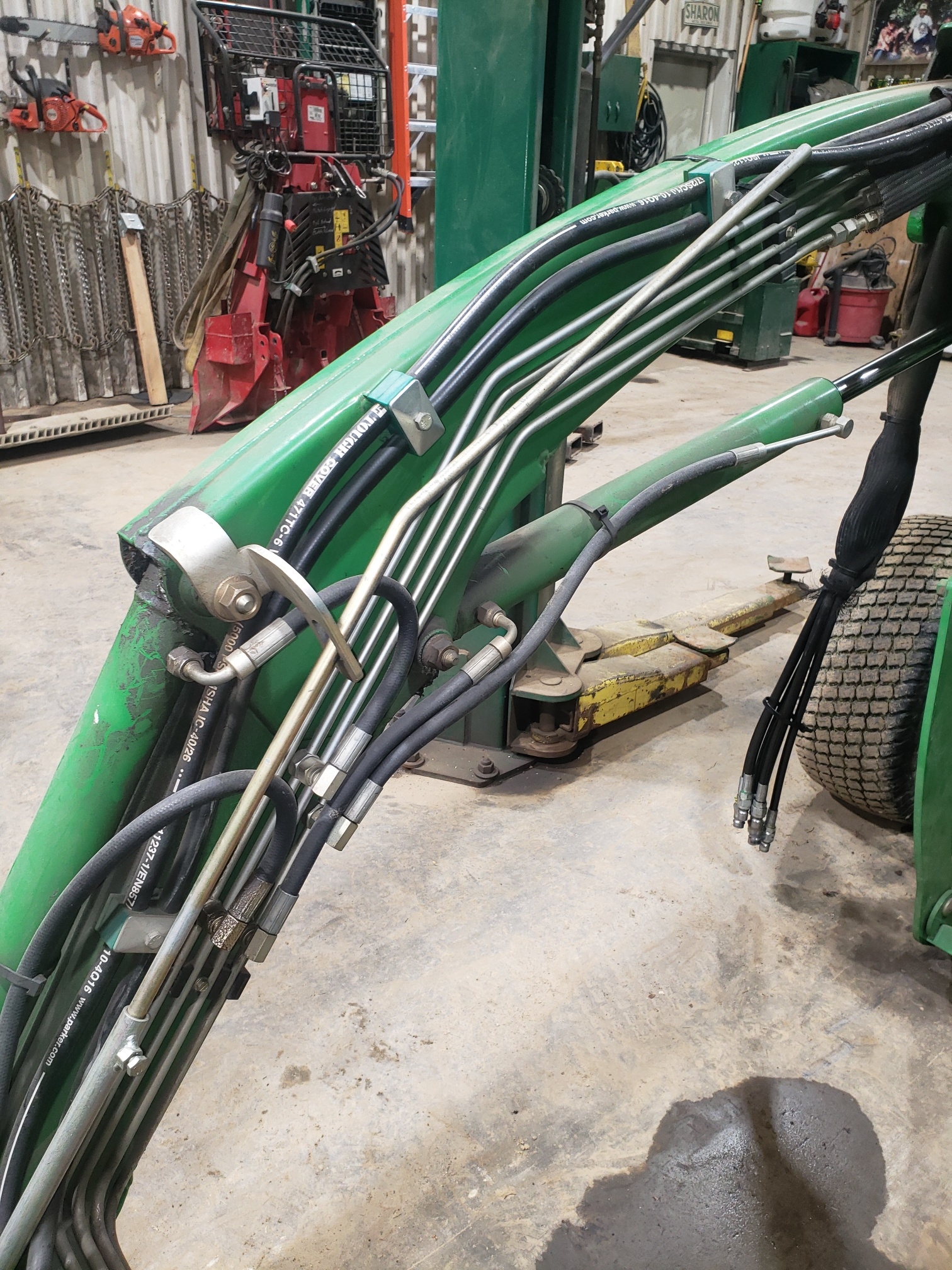

I used the Surplus Center clamps also. I just used a hi-strength adhesive/epoxy to attach them to my loader arm. If I don't forget, I'll try to grab a couple of pics of them.

/ Best Product for Anchoring New Hoses? #23
On the Surplus Center clamp, just remove the bottom metal piece and drill a hole where needed for the clamp. Replace bolt with a longer and use bottom piece as the backing nut on thin metal.
/ Best Product for Anchoring New Hoses? #24
With rustyiron clamp just use half and you have
2 clamps to bolt to fender amazon has them

I got myself some 3/4" cable clamps for electrical wires, and I think they'll be fine. I tried to find a way to use existing screws to hold the clamps, but the cables would have to be inside the fender where they would be more exposed to danger.
I am trying to fix things up down there so that protruding hose doesn't grab the first downed branch I drive by.
It seems like there should be some kind of fitting that would change the way that bottom hose runs so it doesn't hang out there. On the other hand, there are a couple of cables down there hanging out, right from the factory, and they have survived.
