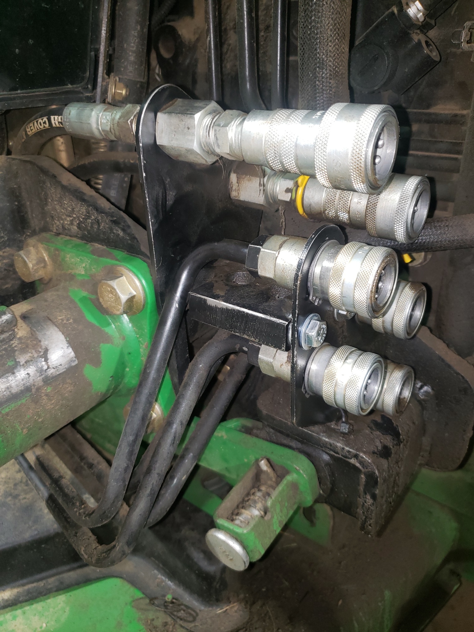

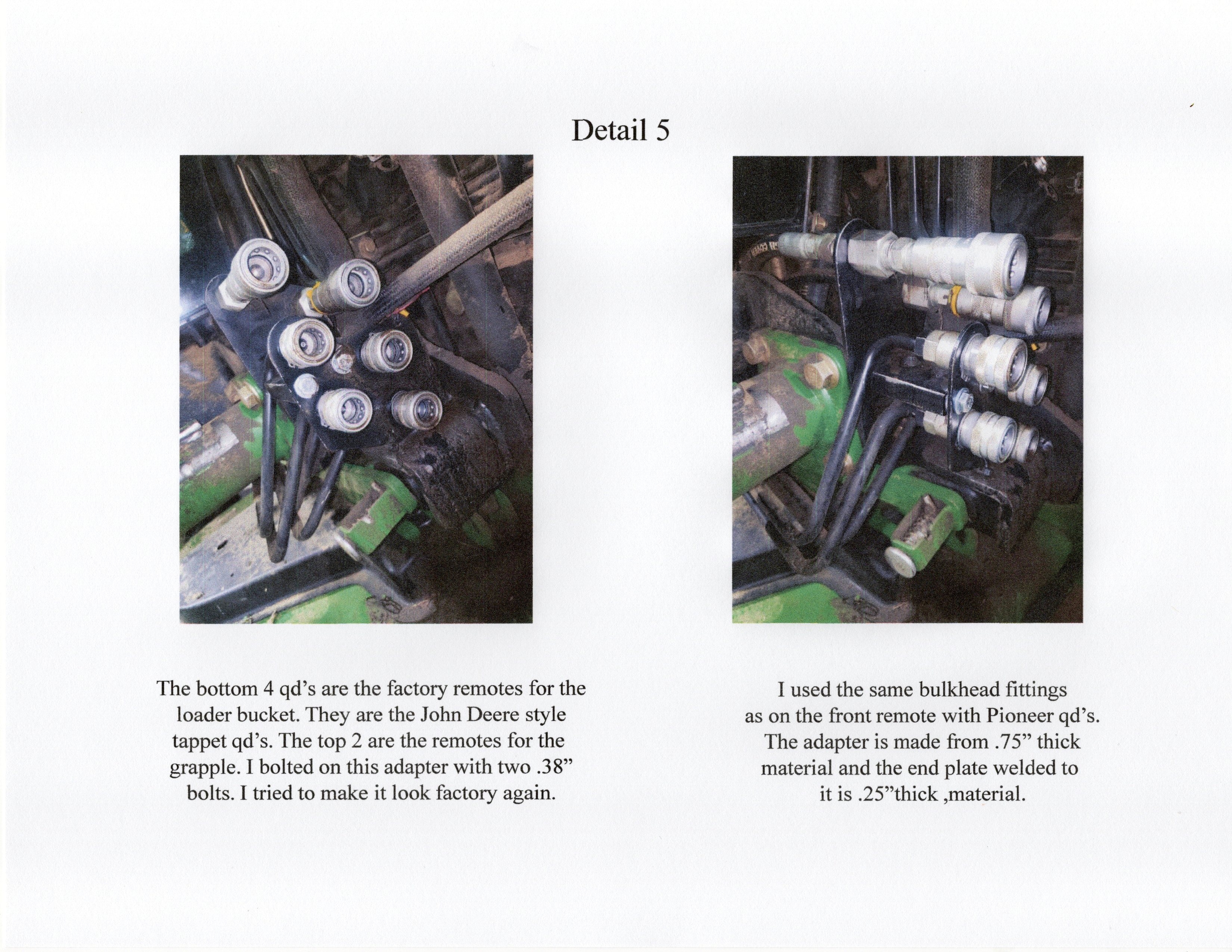

What would be really nice is bulkhead fittings in a bracket that's bolted to the tractor. Then the couplers are supported which makes it easier to connect/disconnect.

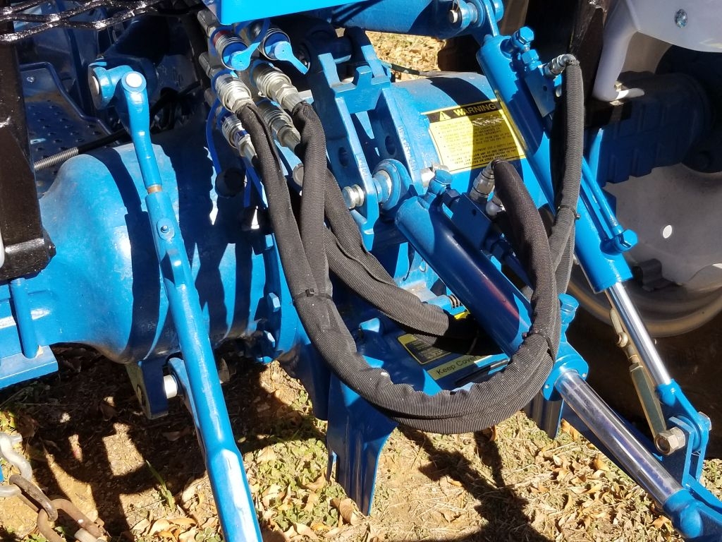

Just did remotes on my MF 1734E. Kit came with zip ties and the hoses came with anti abrasion wrap on them. The routing is under the seat away from the fenders.

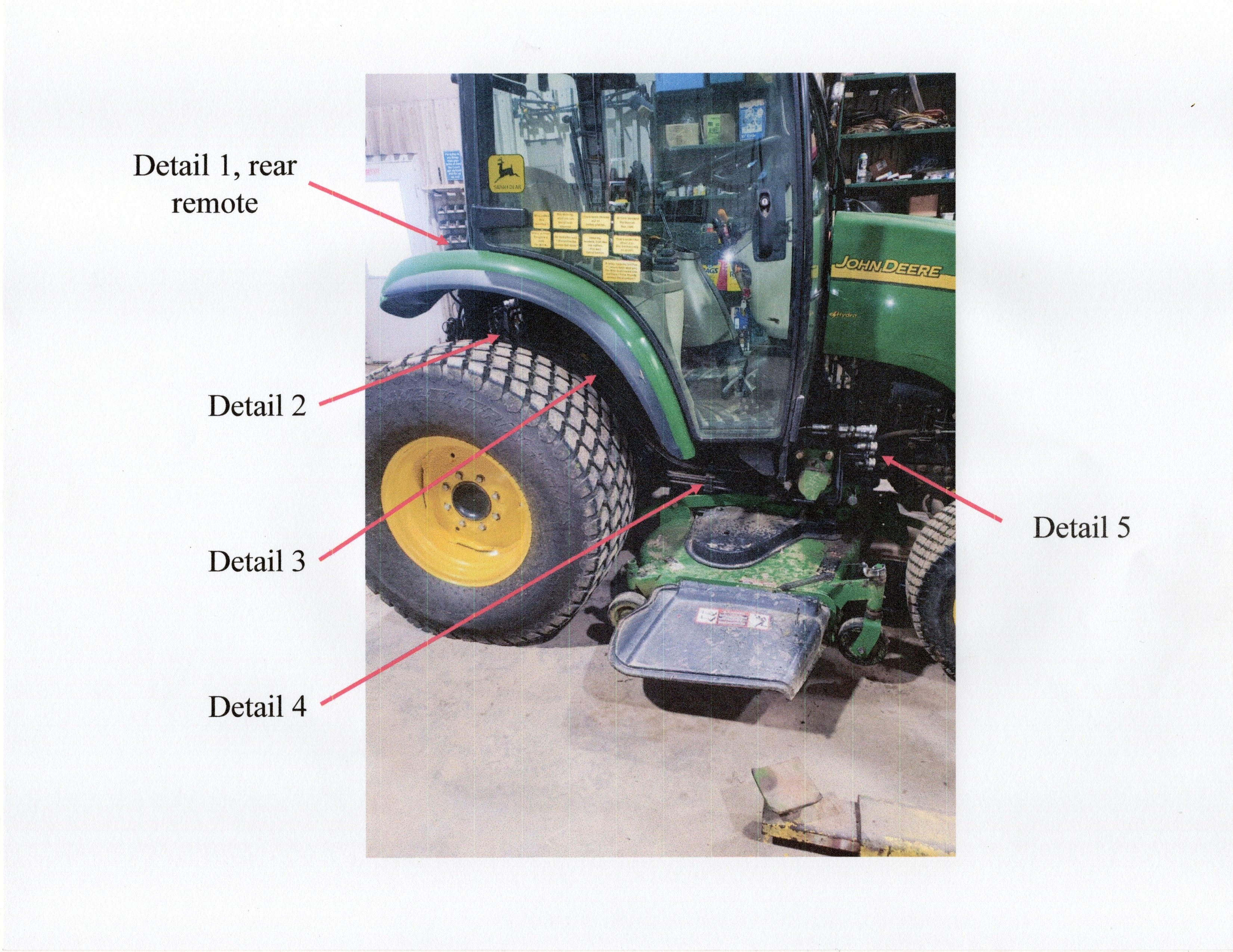

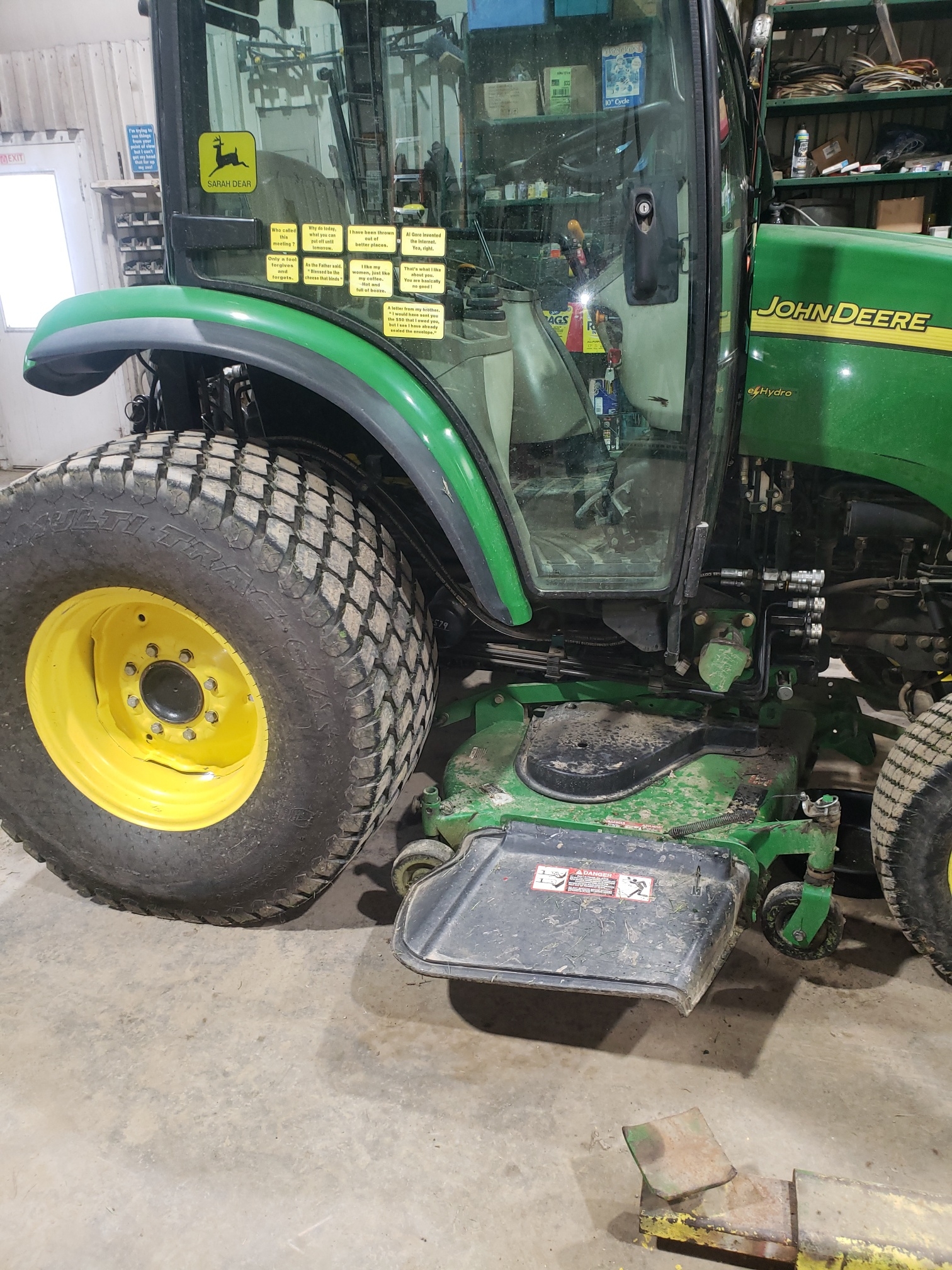

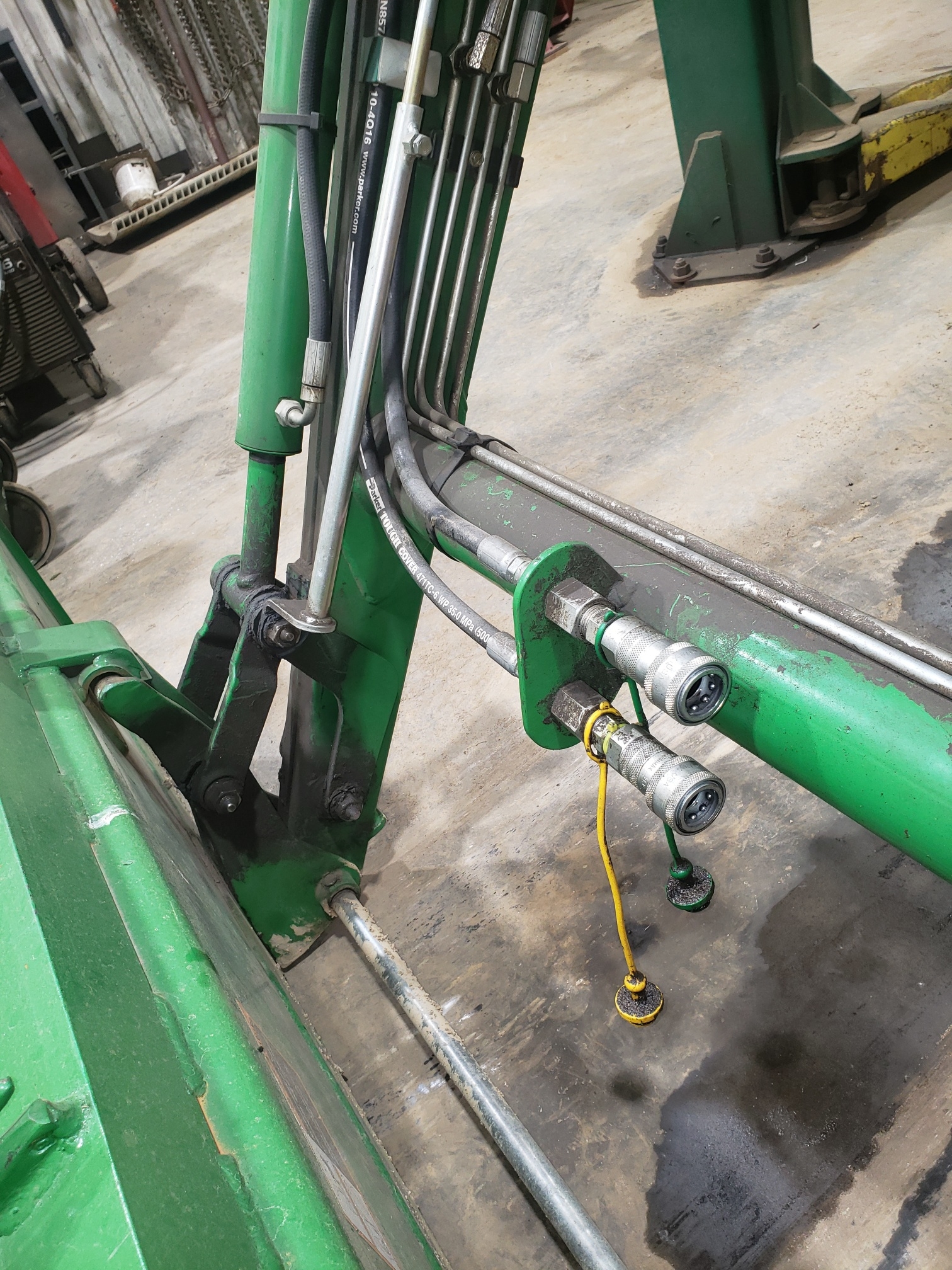

   / Best Product for Anchoring New Hoses? #15

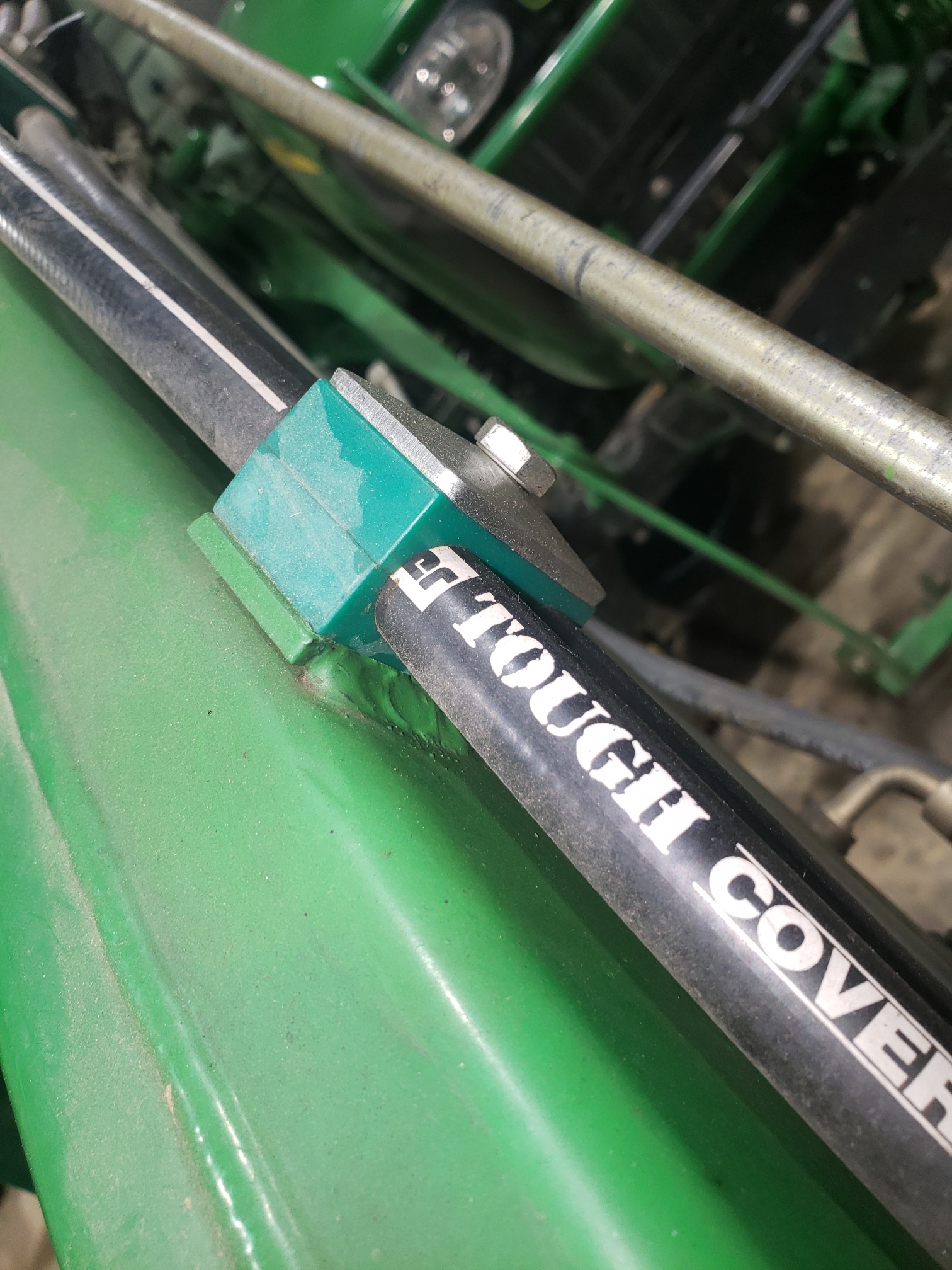

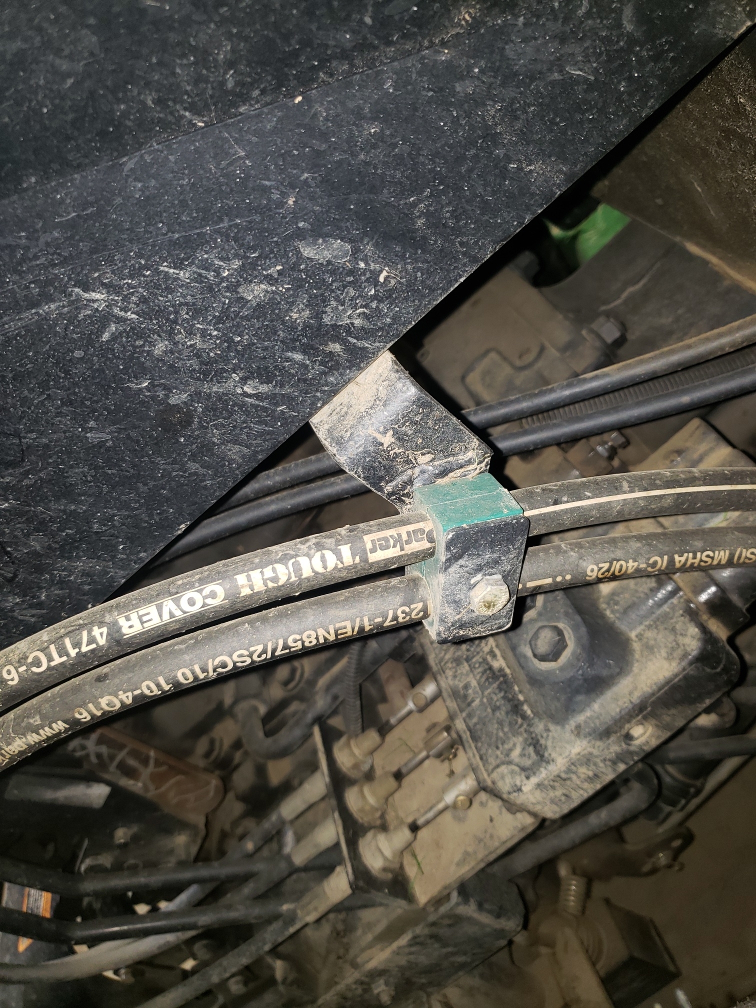

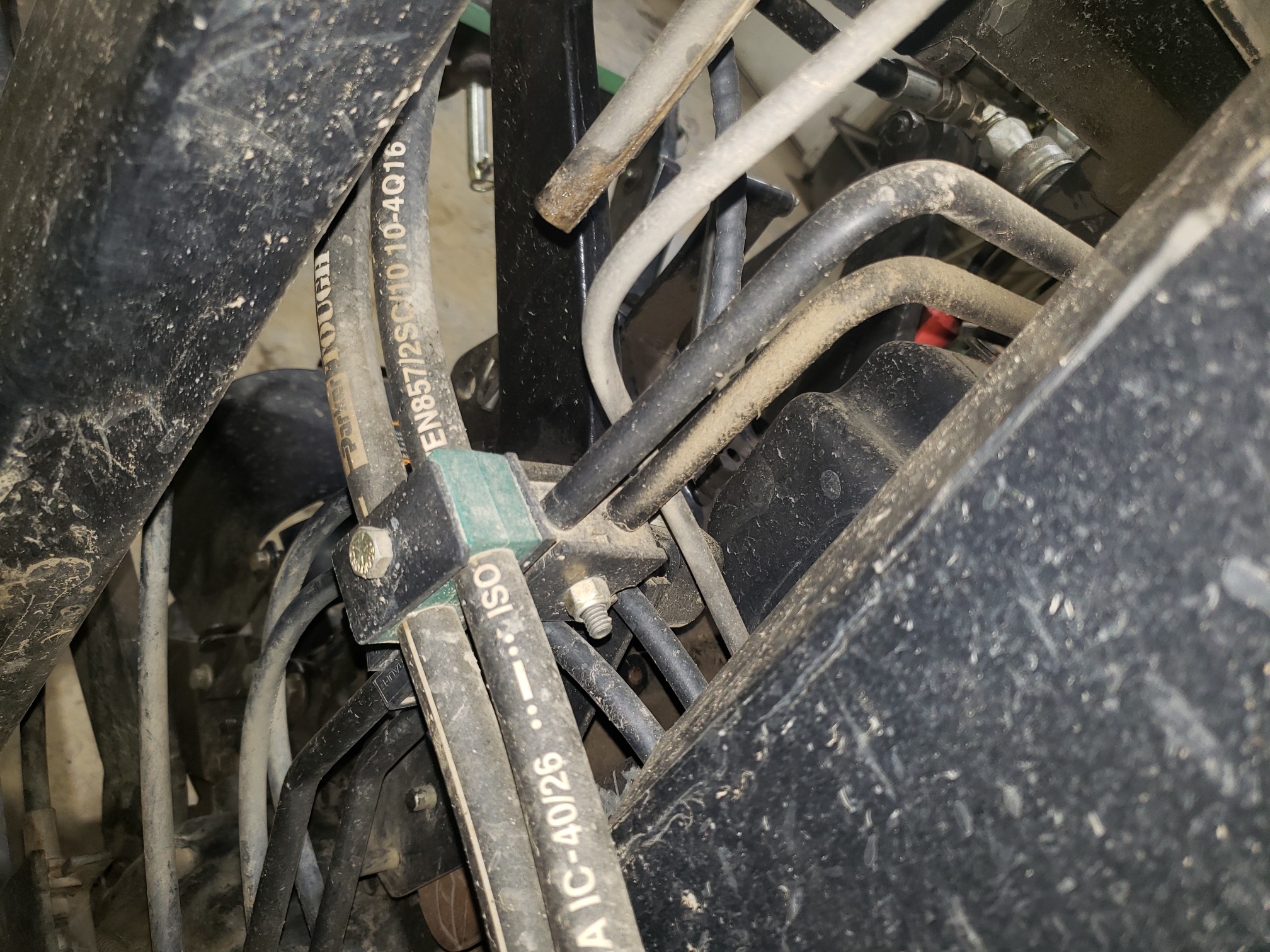

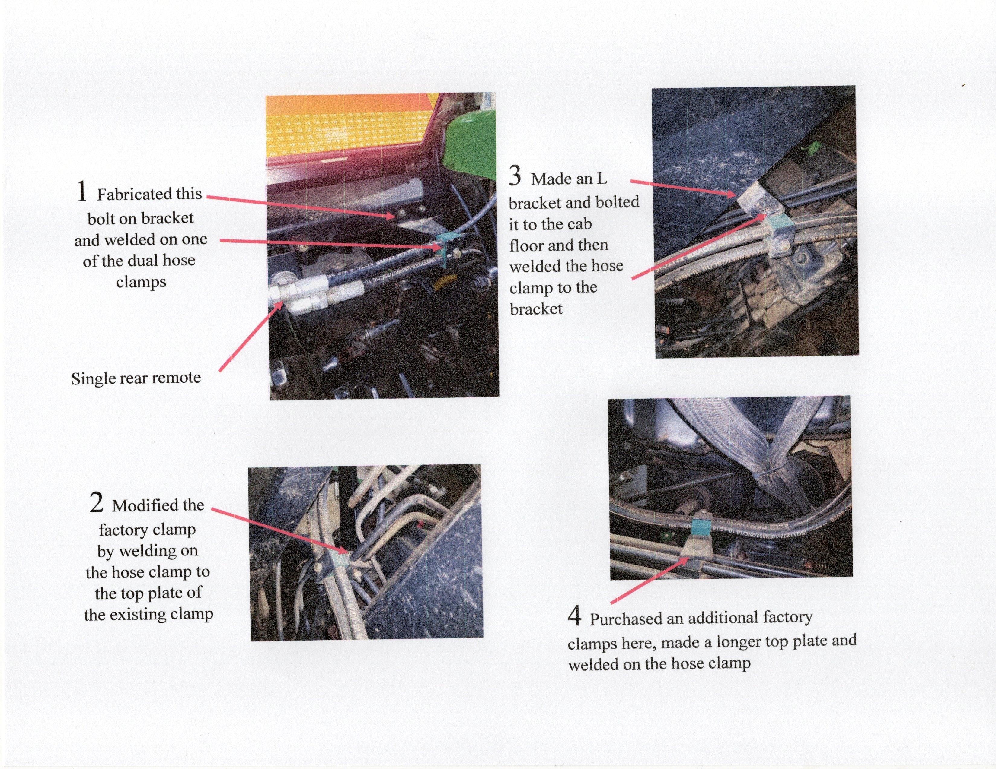

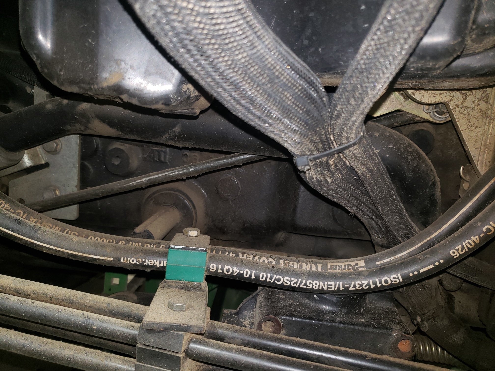

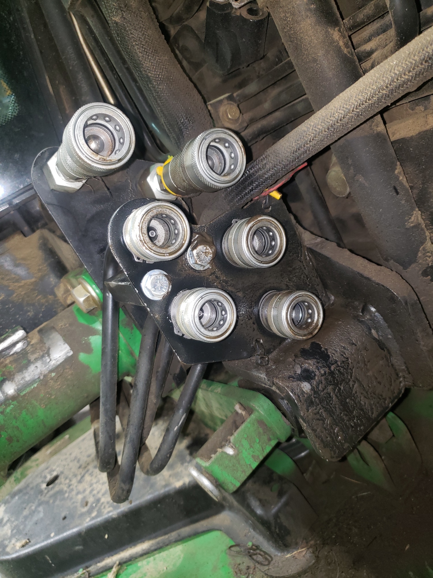

I used the Surplus Center hose clamps for connecting my hydraulic lines from the grapple to my tractor. I did this 9 years ago and everything seems to be staying put. I added some details about sizing the clamps. Also I do not have an actuator on the loader joystick for the grapple. I use the remote lever to open and close the grapple. I have gotten used to that arrangement. I remember that the 2 lines alone were $300 and with the clamps and qd's I had approx. $400 in this modification. Attached details. I also add the original pictures for more clarity but without the verbiage.
   / Best Product for Anchoring New Hoses? #16
Attached are the original pictures for my clarity.20250503_123329_resized.jpg20250503_104337_resized.jpg20250503_104425_resized.jpg20250503_104416_resized.jpg20250503_104532_resized.jpg20250503_115559_resized.jpg20250503_115609_resized.jpg20250503_104147_resized.jpg20250503_104251_resized.jpg20250503_125841_resized.jpg
   / Best Product for Anchoring New Hoses? #17
This also makes them easier to break or rip the hose.
   / Best Product for Anchoring New Hoses? #18
Then your hoses must be too short. My three-sets of couplers are mounted on brackets, and I've never had a problem. Soon to be a fourth.

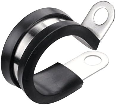

I use these insulated cable clamps:
They allow some movement as hose pressure varies, which prevents chaffing. They're made of stainless steel so they won't corrode. I use two side by side and share the same mounting hole for dual hose runs.
