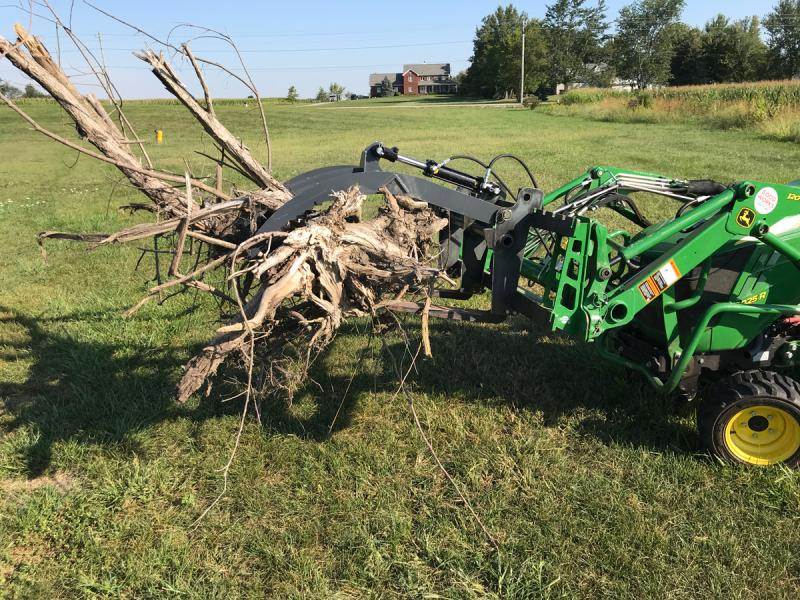

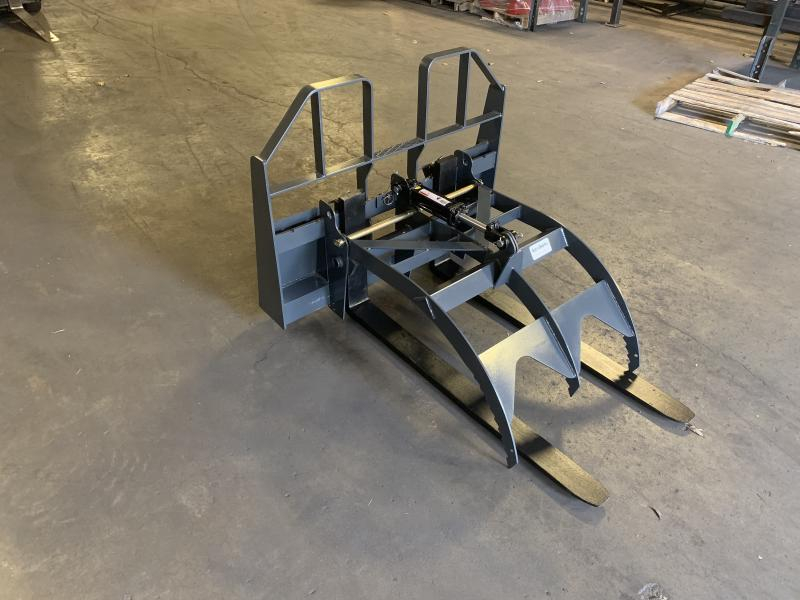

I am looking to purchase an Add-A-Grapple to my Titan pallet forks. Any experience with these?

I've looked at these. I think I'm going to buy "The Thumb" from Greens Machine and put it on my forks, with a separate mounting base for my bucket.
/ Best Pallet Fork Grapple? #4
I have "The Thumb" mounted to my forks and for the price it can't be beat.
They make log handling easy
A little lightweight , so watch your loads and no zerks on the pivots but I keep them lubed.

I bought a "The Thumb" more than 10 years ago and mounted it on a dedicated heavy duty pallet fork. I have used it on my skid loader for carrying large trees to light brush. Also it is great for demo work on old out buildings, barns and such. I once picked the entire roof off of a 8'X12' chicken coop in one piece. I was also able to lay the wood framed walls and roof flat on the ground and pick the sheet iron off so that I could haul the sheet iron to the scrapper. One thing I will suggest is that you position your forks so that the grapple will go down between the forks. That way you can grab onto smaller loads.
If I remember correctly seems like I gave $350.00 for it. Money very well spent.

I feel like if I get it, I'll want to get a separate mounting base for my bucket. Allowing me to easily swap it from forks to bucket. Anybody done that? Is it useful on a tractor bucket? I don't move rocks that much. With the sides on the bucket I'm not sure it would be worth much lifting brush, poles, logs, etc.
