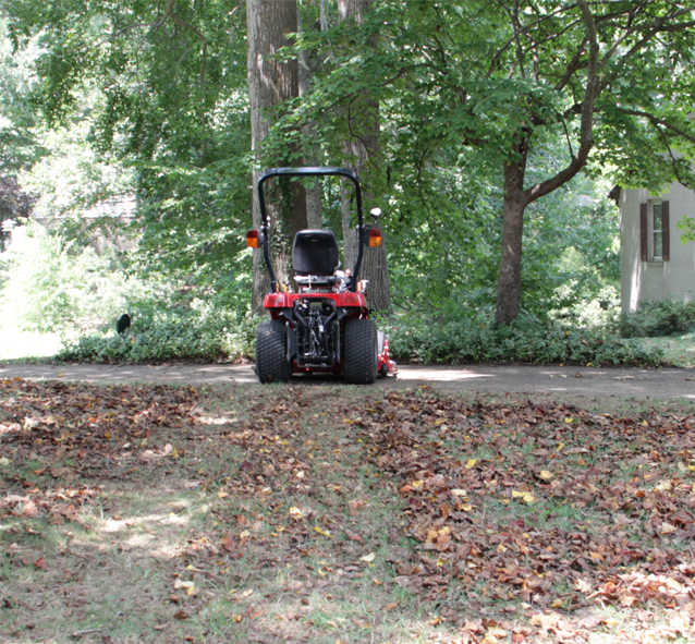

I've actively used my mulcher deck on leaves in Fall and it worked very similar to how it handles grass. The differences I see in my mulcher compared to a kubota deck with mulching kit . . Is that the kubota with mulching kit I tested bogged down because it still only had the 3 blades and was designed for chute cutting and the mulching kit merely blocks the chute and turns the path. A higj lift kubota deck was better but I still couldn't maintain full rpm under cutting load. The Massey mulching deck has 6 blades working as you know . . And unless your leaves are wet . . The blades break down the leaves with 6 blades . . Much faster than with 3. In my testing . . I found breaking down material quickly with more blades allows the deck to not buildup resistance and force slower rpm
Now if the leaves are wet . . I don't think it is different than wet grass . . Its a problem for any mower then. But this is only my testing I did and cettainly others could get different results.
My rule of thumb for good mulching is if the engine can maintain full rpm . . . Then mulching has a good chance of succeeding. If rpm can not be maintained . . Then its a different result and a way to reduce load is required.
Were you able to test a mf 2315 mulching deck to see how it performed with leaves ?
I found the hardest leaves to work with are Ginko tree leaves and Catalpa tree leaves. One is very small and incredibly slippery and the other is very large and "movable".

I used to have a John Deere X534 with the mulching kit. The problem was, even with multiple passes chopping the leaves into fine bits, there are just some areas of my yard that I feel its gets too deep, smothering the grass.
   / Best mulching MMM for SCUT #14
That makes perfect sense Fiziks, except isn't the statement true with any mmm deck ? I'm missing why that short term condition prevents having a mulching deck vs. A discharge deck. Isn't it just a case of too many leaves in a particular area . . . for any deck ? ? ? and the quanity of leaves just need to be reduced before cutting or after cutting ?
I'm not saying any one deck is the perfect choice . . what I'm just asklng is . . Whether grass is far too high or leaves are far too high/heavy . . if too much accumulates on the lawn after cutting . . 1 type deck or anorher still leaves too much on the lawn (whether chute thrown or mulched). It seems the answer is big vacuumed unit with trailer catching or raking I would think ? ? ? ?.
