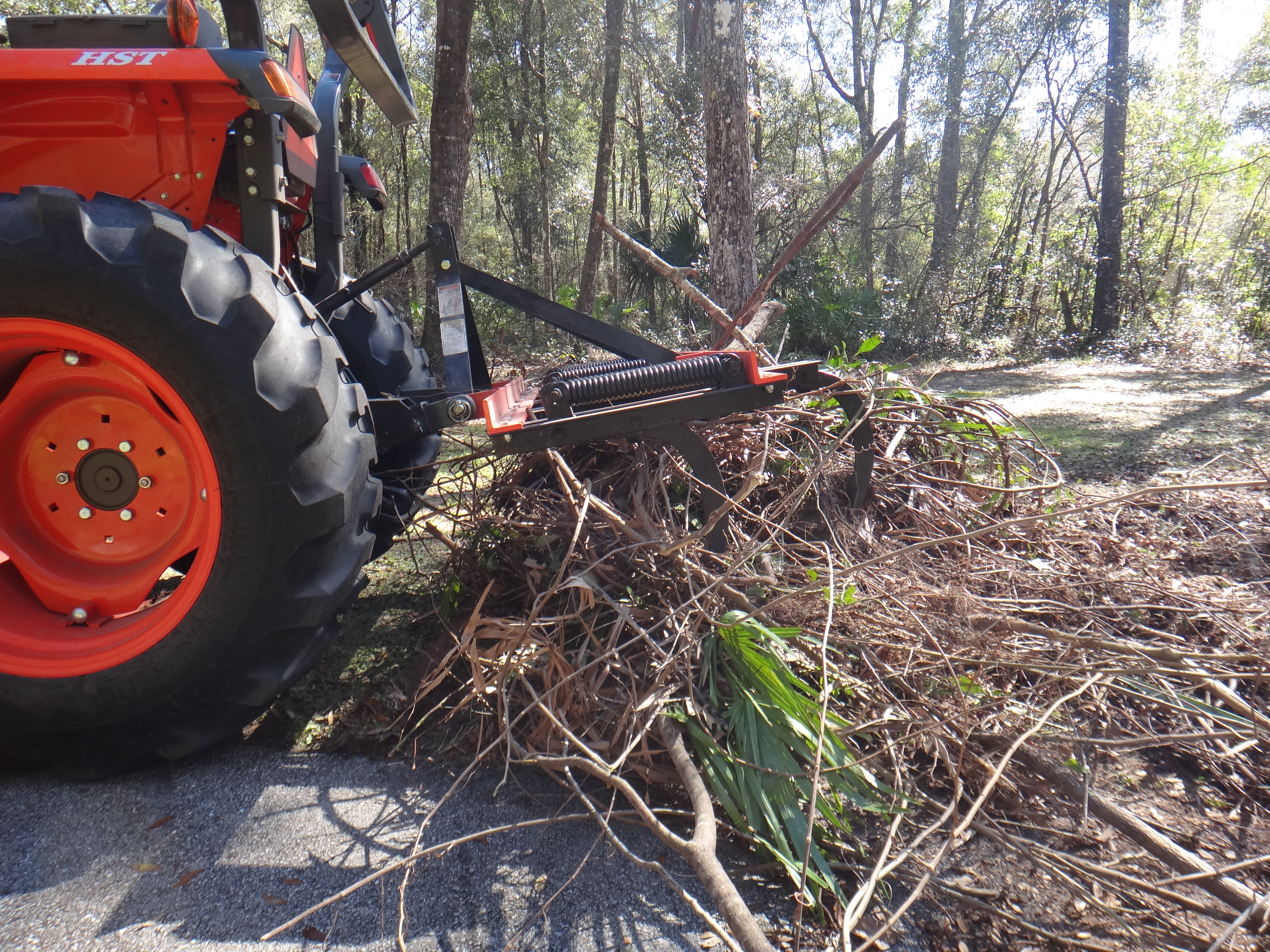

A Rotary Cutter/Bush Hog will cut grass attractively if the two blades are kept sharp. That precludes mowing Mesquite if you want a high quality cut.
Dragging out small Mesquite, roots and all, should be easy with a Ratchet Rake attached to your bucket.

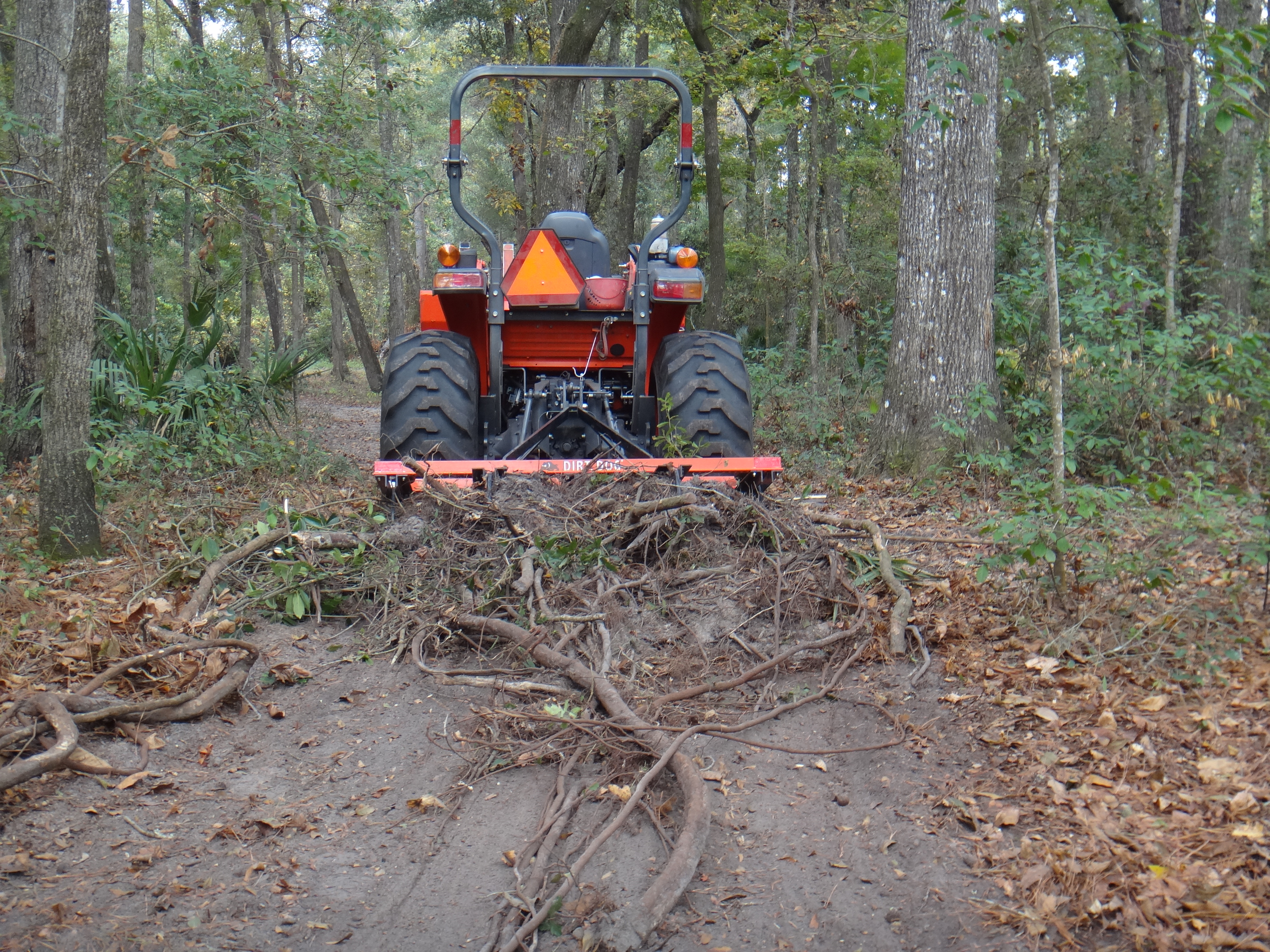

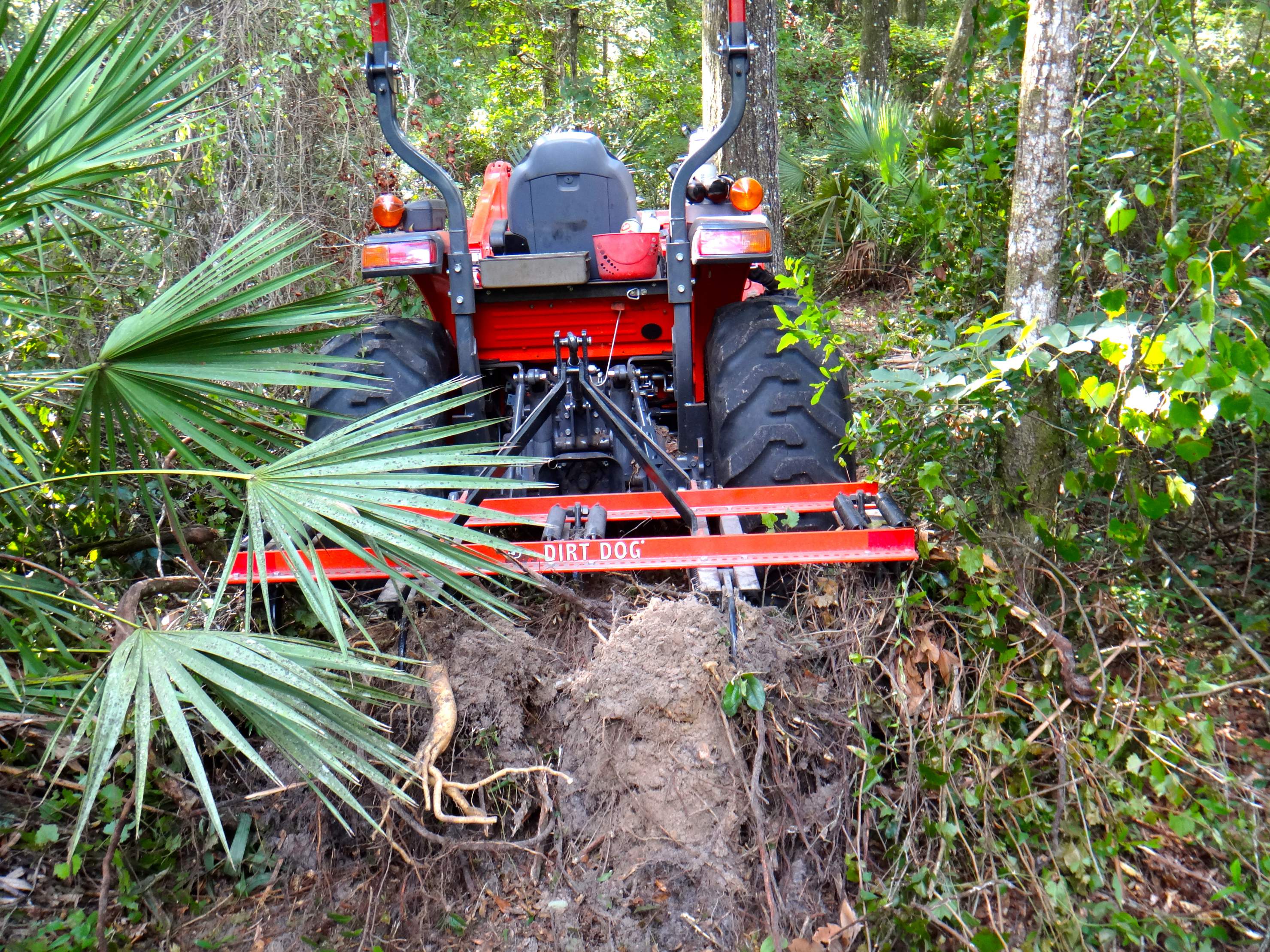

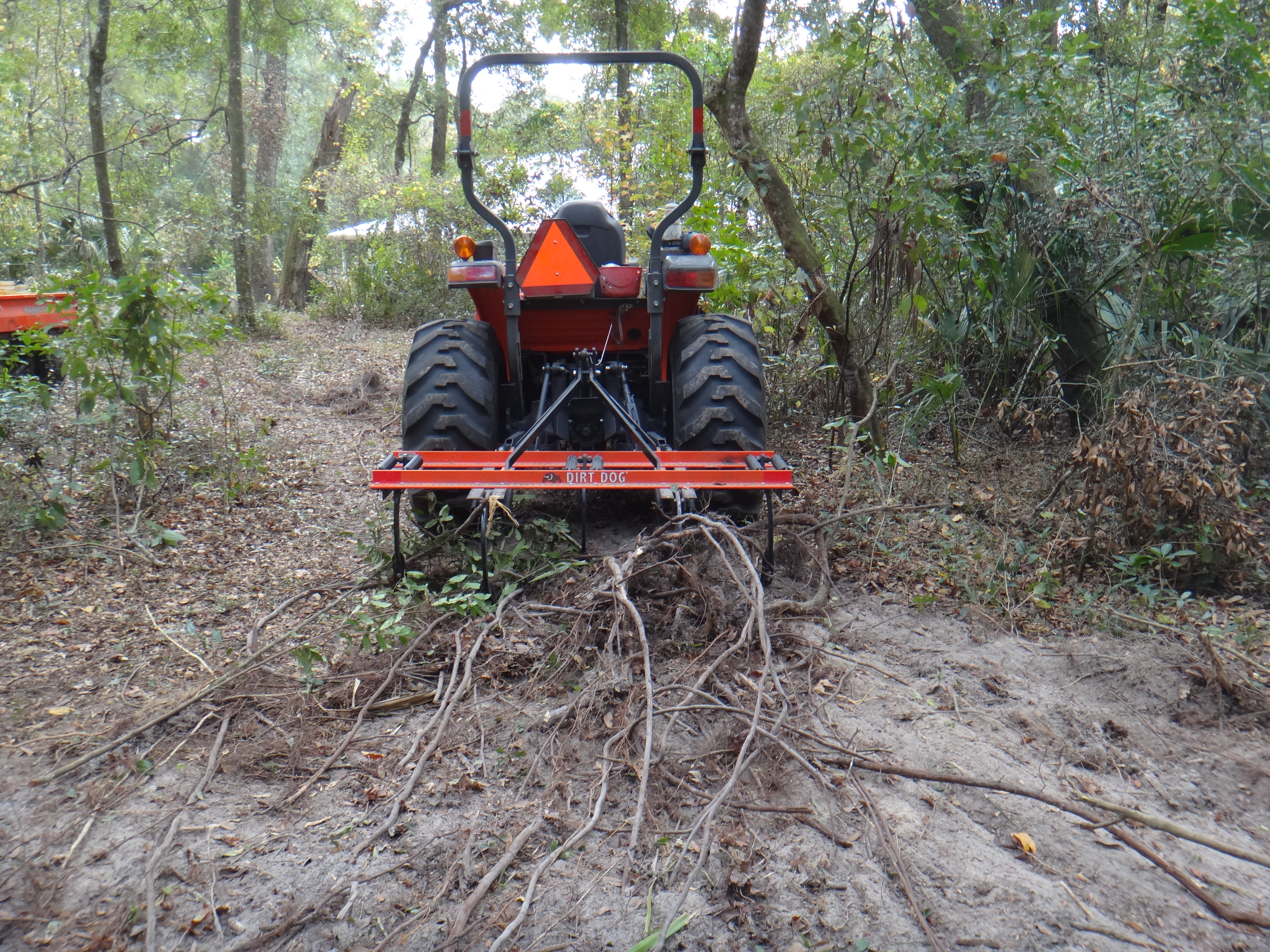

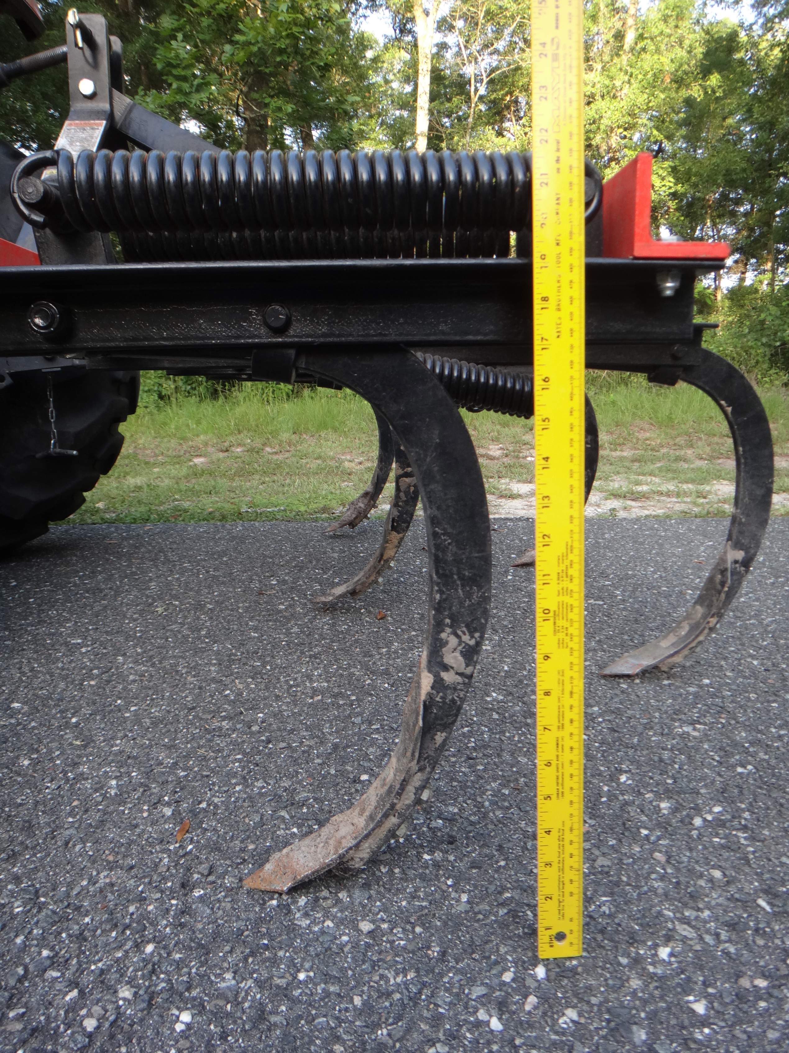

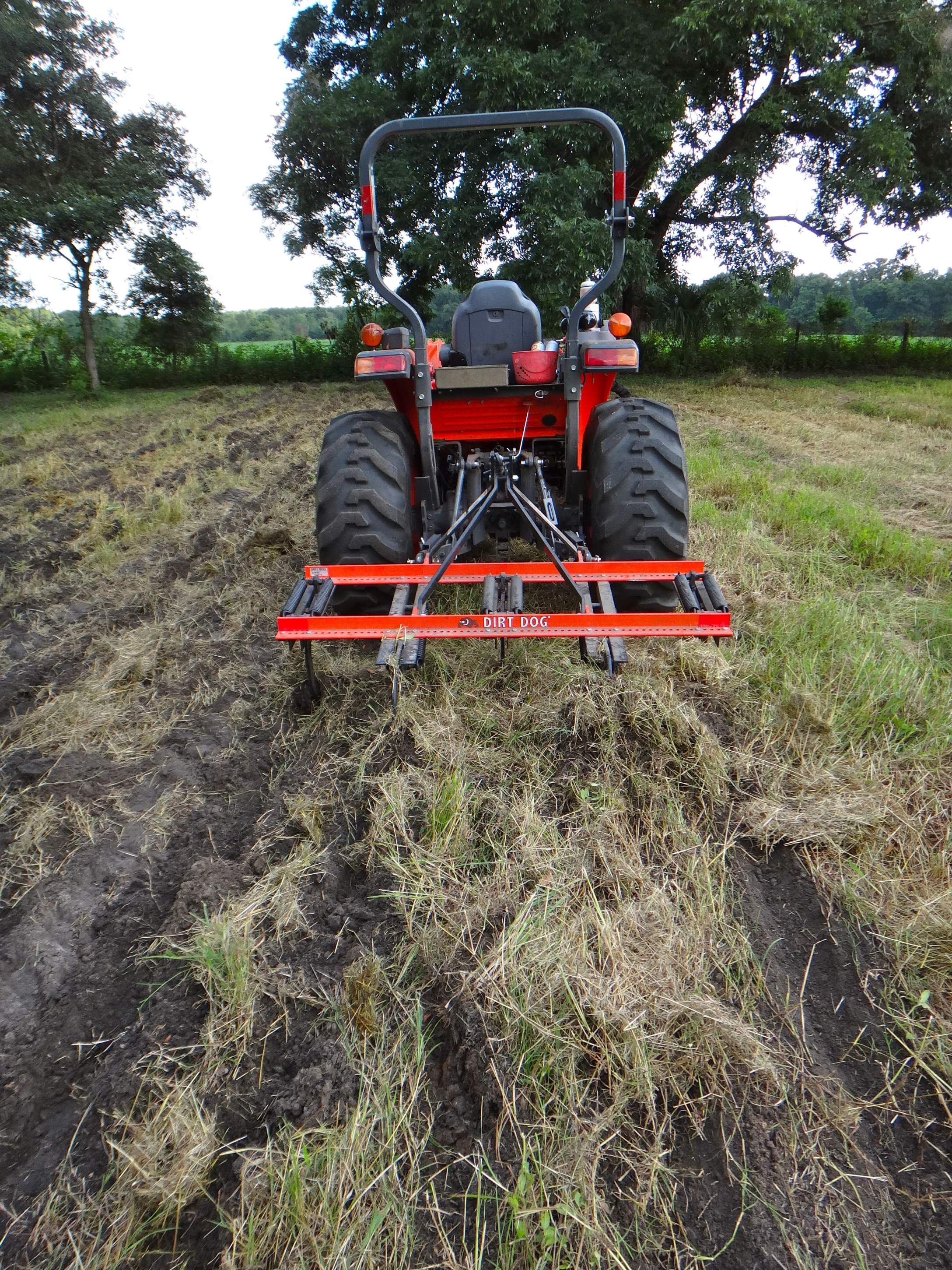

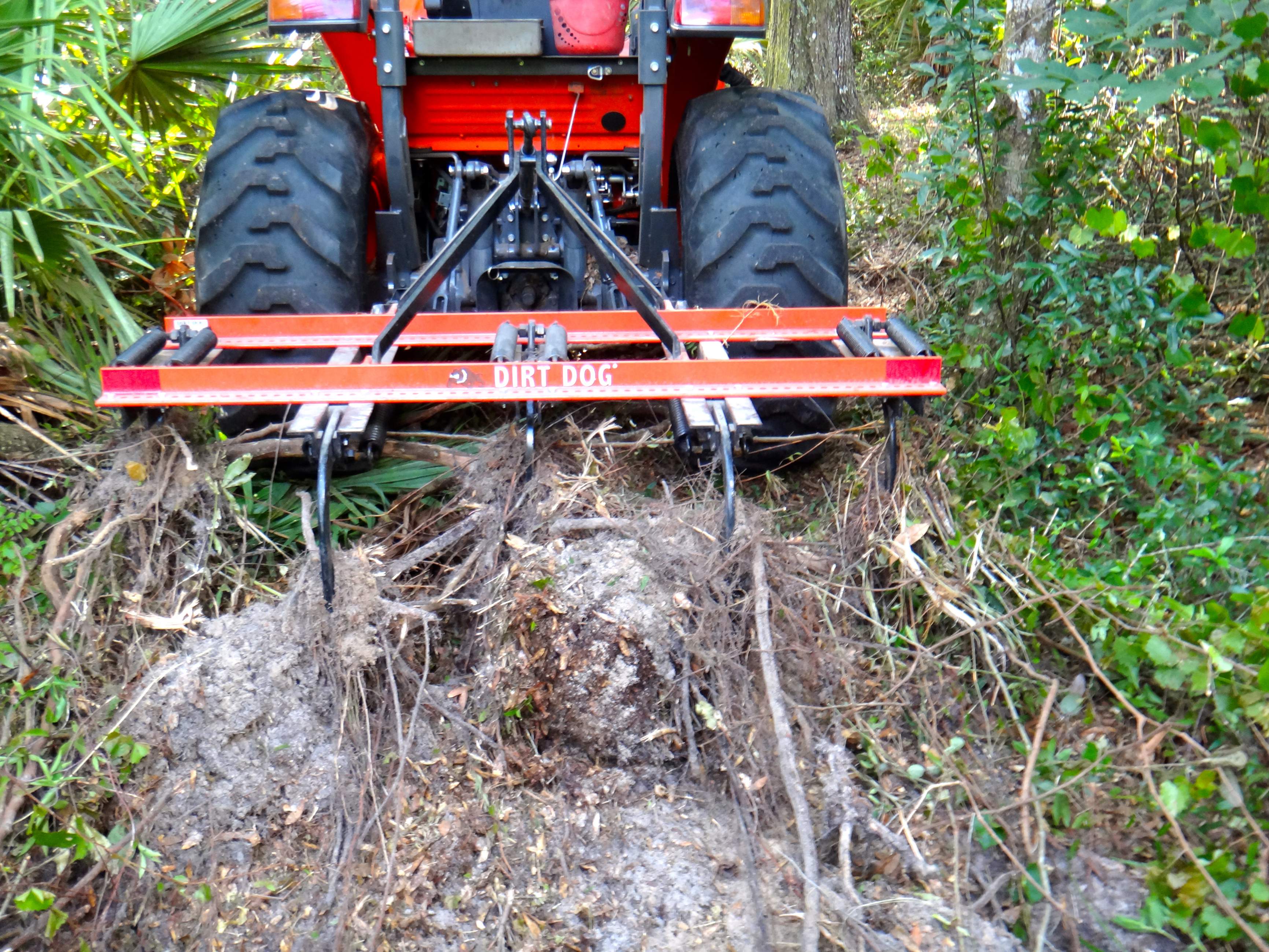

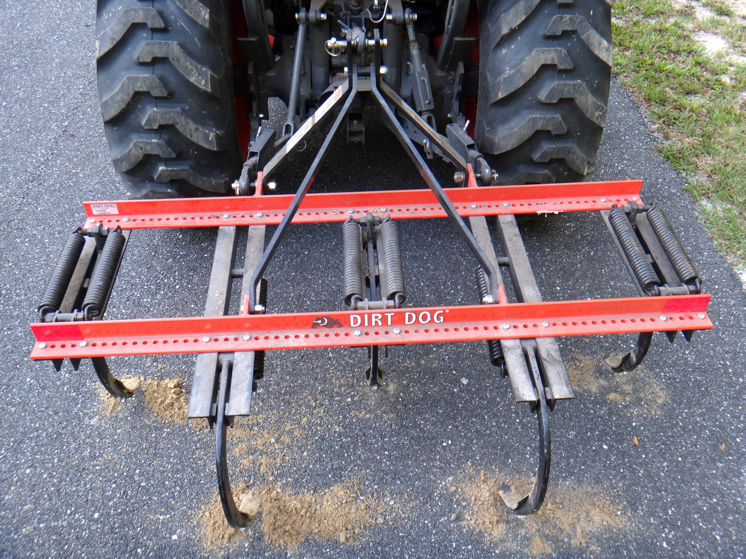

I remove vines, vine roots, corms and softwood roots mechanically, using a Three Point Hitch mounted, spring-protected Field Cultivator.
VIDEO: How to Use a Ripper / Field Cultivator - Gardening Series - YouTube
Alternatively, you can also spray with readily available 2,4-D based herbicide or a stronger ag herbicide containing 2,4-D plus triclopyr, such as Crossbow, or more readily available Bayer Stump and Brush Killer. Crossbow applications are cheaper than Bayer as Crossbow is mixed 2 ounces per gallon.
I fear herbicides. I prefer mechanical removal but sometimes spraying from a one gallon hand sprayer is appropriate. Killing Poison Ivy requires at least one spray.
I eliminate trash verdure. I do not deal with the same trash over and over.
