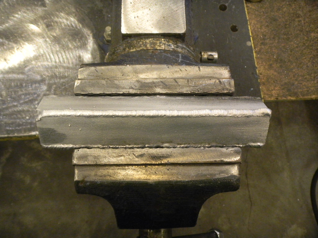

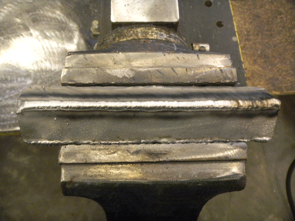

You can use a MIG welder without a spool gun. I have been most successful with 5356 0.035" wire with
my Hobart Ironman 210. It is stiffer than 4043 and much less likely to "rats nest" at the drive roller. I have used
4043 at 0.030", and do not recommend it. One of the tricks to use Al is to use a larger tip and stick with
big wire: .040 tip and .035 wire. A spool gun IS made for the Hobart, but I am too cheap to buy it.
That said, MIG welding with aluminum this way is not for fine work.
There is a place for 120V MIG welders, too. Better portability, for one. They work fine for thinner metal,
in my experience.
