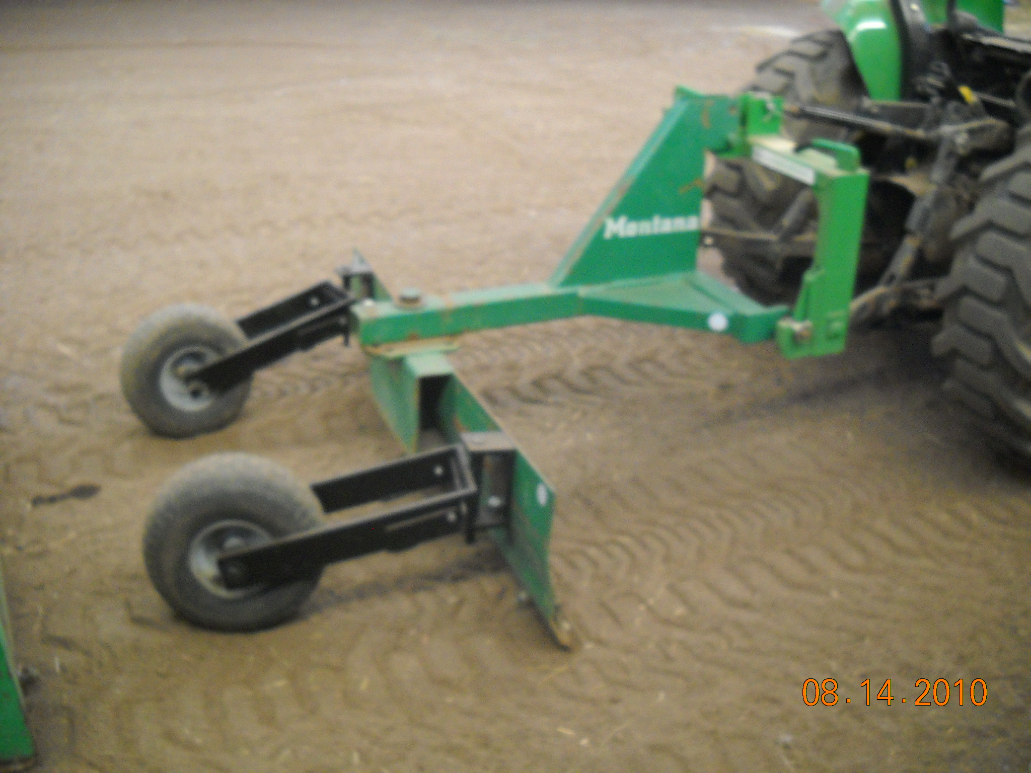

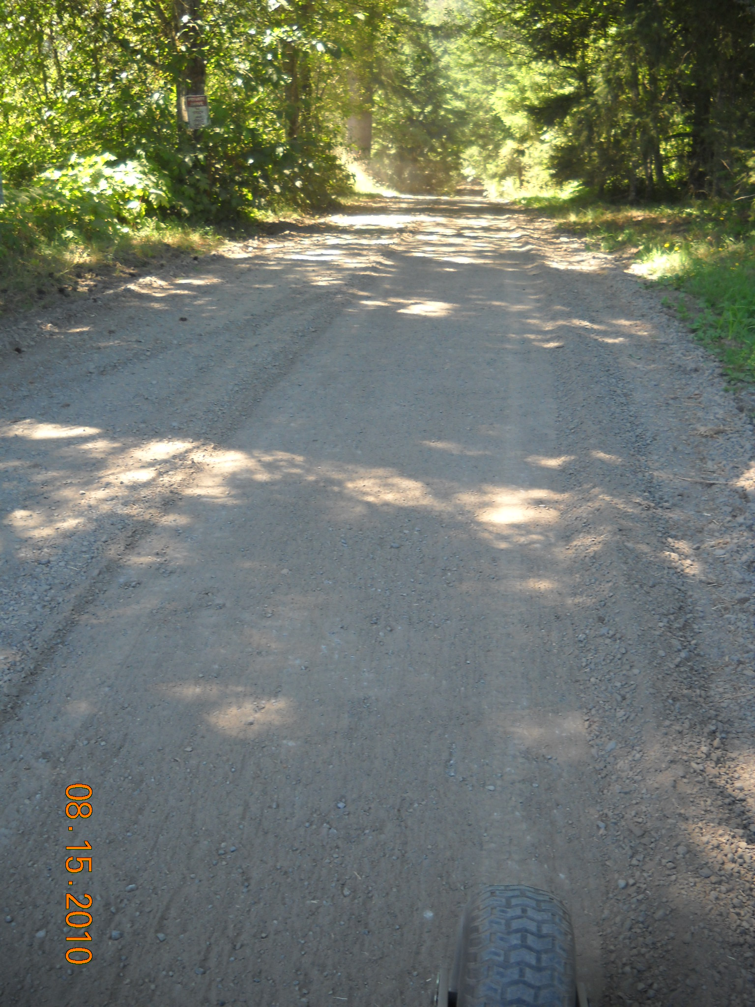

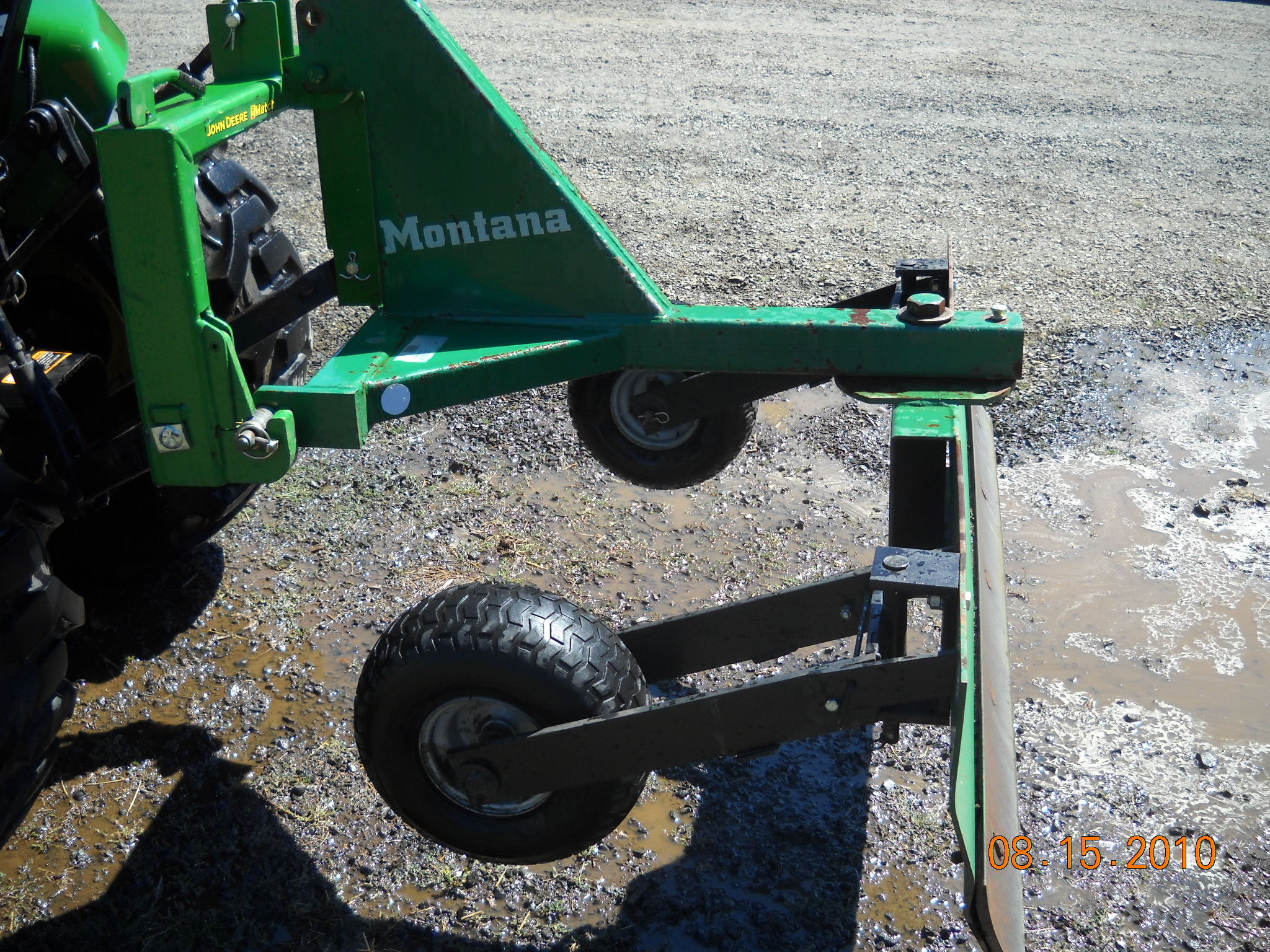

On my gauge wheels, the only adjustment needed is via the 3 point top link. With the blade facing forward, extending the toplink will put more weight on your gauge wheels creating less of a dig effect on your blade. Retracting the toplink will put more weight on the blade rather than the wheels making more of a dig effect. In reverse, it is just the opposite. First, you lock the wheel pivots so the wheels wont skid on the gravel creating ruts. Extending the toplink will put more pressure on the blade giving it a harder drag effect. Retracting the toplink will put more weight on the gauge wheels making less of a drag effect. This simple design makes the whole tilt based on the toplink on the tractor so if you had a hydraulic top link, you could completly adjust the whole blade via a 2 way hydraulic control valve. The only time you would have to leave the seat is to angle your blade left or right.
